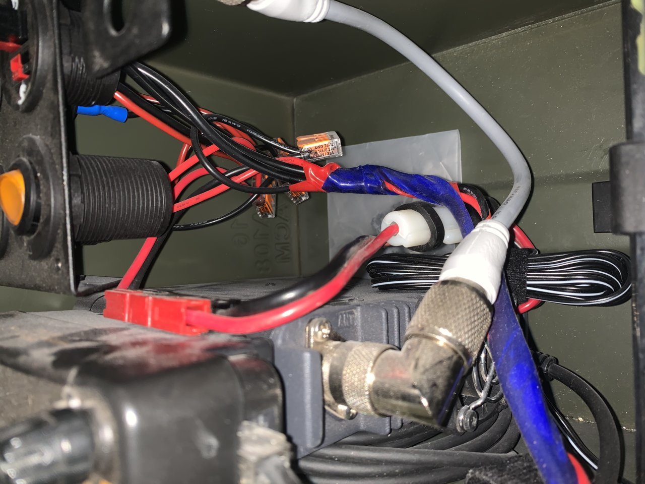

    I'm about to start putting my build together (parts in the mail).
    How did you measure/mark your holes on the ammo can for mounting?
    Also, how did you get multiple wires in/out from your battery with the QDs? Do you just crimp 2 or 3 wires into the terminal?

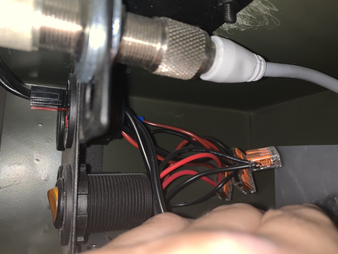

    I played around with the layout for a while, then when I hat it, I marked and then made a paper guide on the inside and moved it to the outside and drilled. I suggest a new drill bit and very small file (HF has a jeweler's file set for like $5).
    I did one wire to the battery and then used the WAGO connectors to split it off to everyplace I needed it to go. I LOVE the WAGO connectors. I either solder or WAGO now.

    Smart about the paper guide, was planning on new drill bits anyway. In your write-up you mentioned WAGO connectors and I didn't understand what they were for so thanks.
    I've been thinking through a hammo can build for almost a year now, and you're the first person I've found that has said anything more about their build than "look at this cool thing".
    SUPER helpful! Can't wait to post my pics.

    I hope these help, pics of WAGO connecters.
    4C1238F3-2755-44CD-AB1B-848E7EBC4DC3.jpg DBF213A1-EDCC-4C08-BF75-A5C1592C2453.jpg
    also, I used silicon tape, sometimes called magic tape. It’s what car manufacturers use for wiring. It stretches and only sticks to its self (like plastic food wrap). It’s also waterproof, so worth having around the house.

    Thanks, this is great! Those WAGOs are smaller than I imagined, I've got a variety pack on the way.
