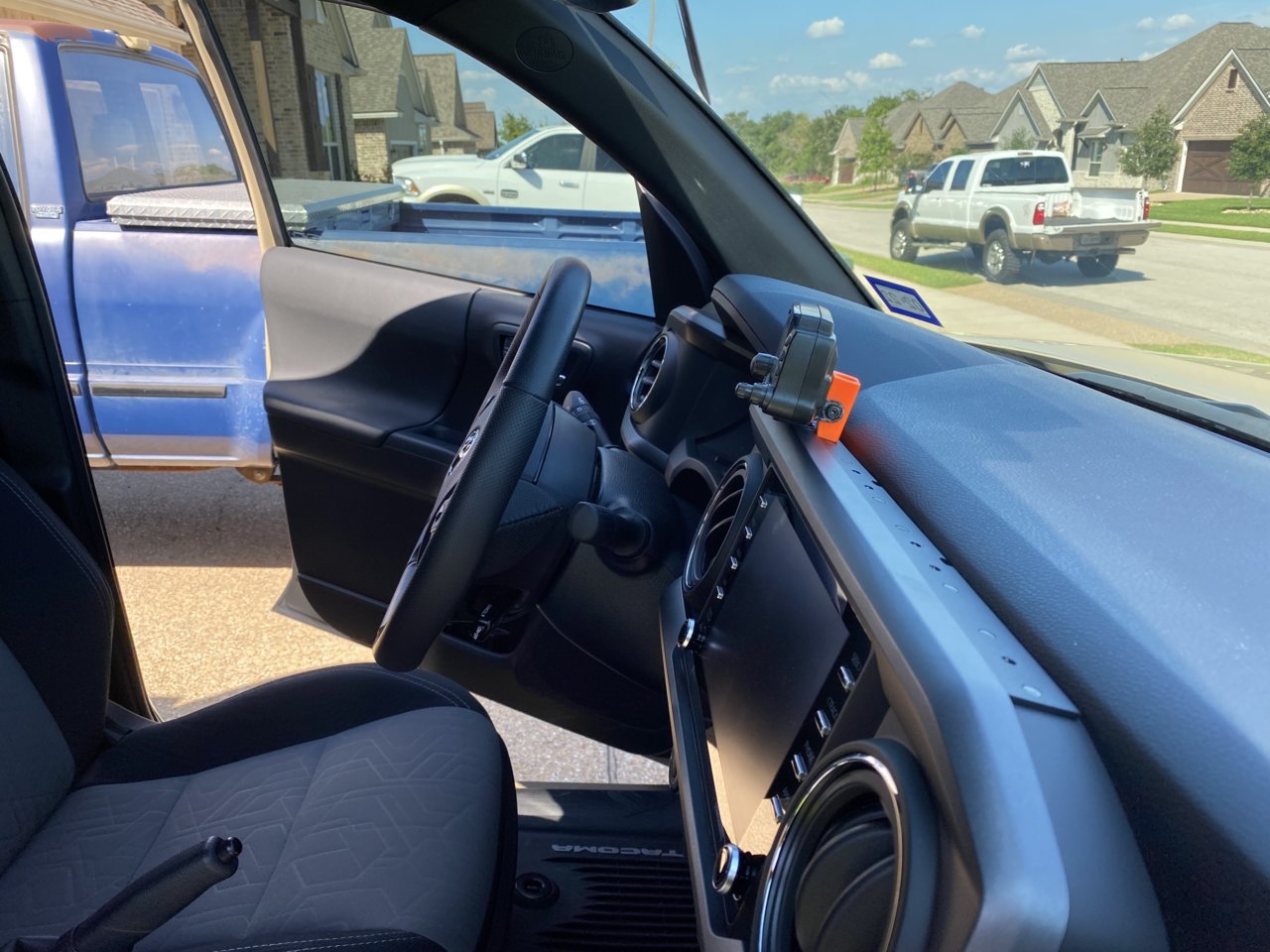

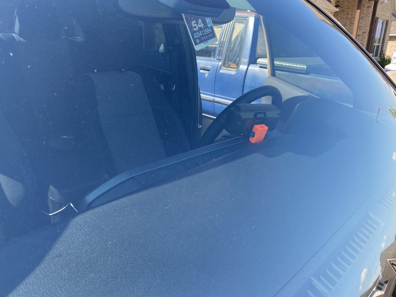

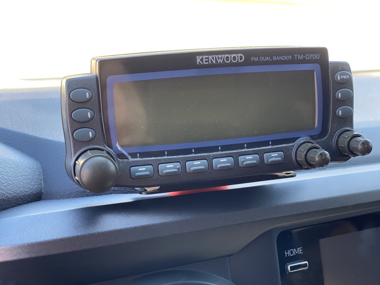

    So I installed my DMM from Taco Garage. I *really* like the install. It's so nice and clean.

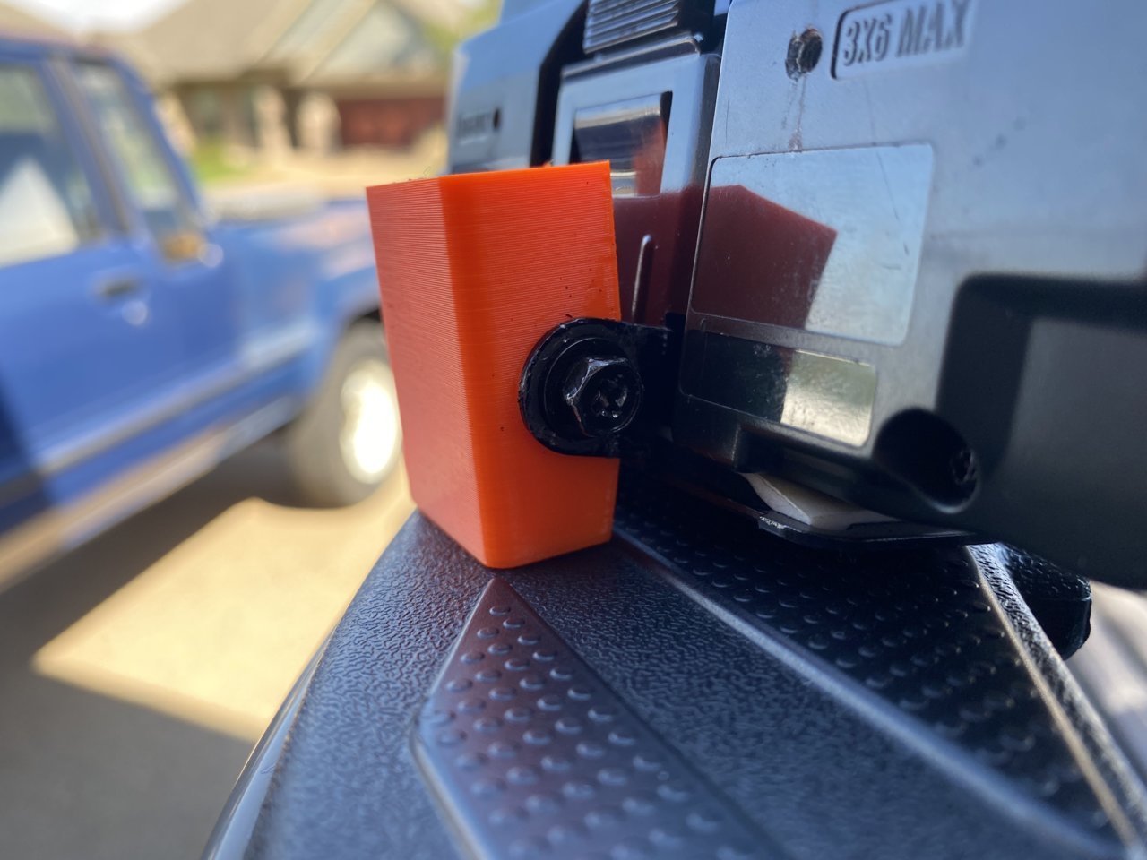

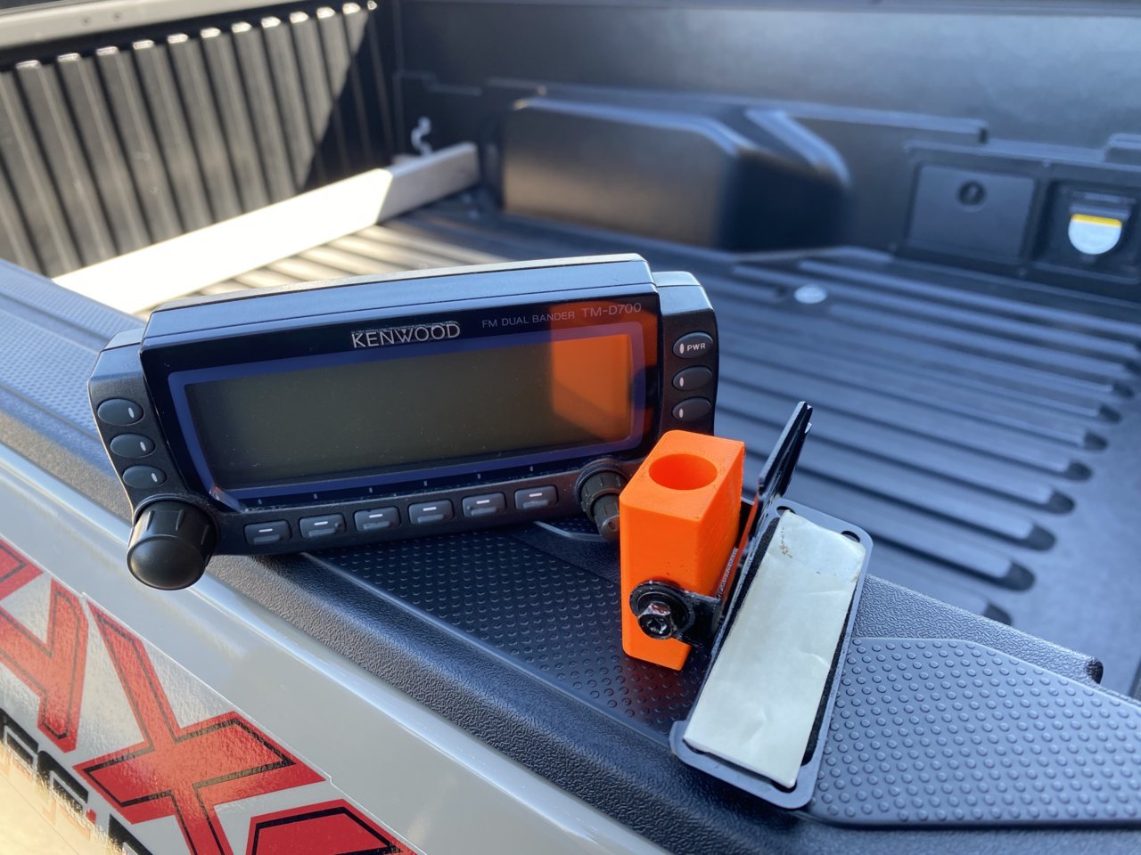

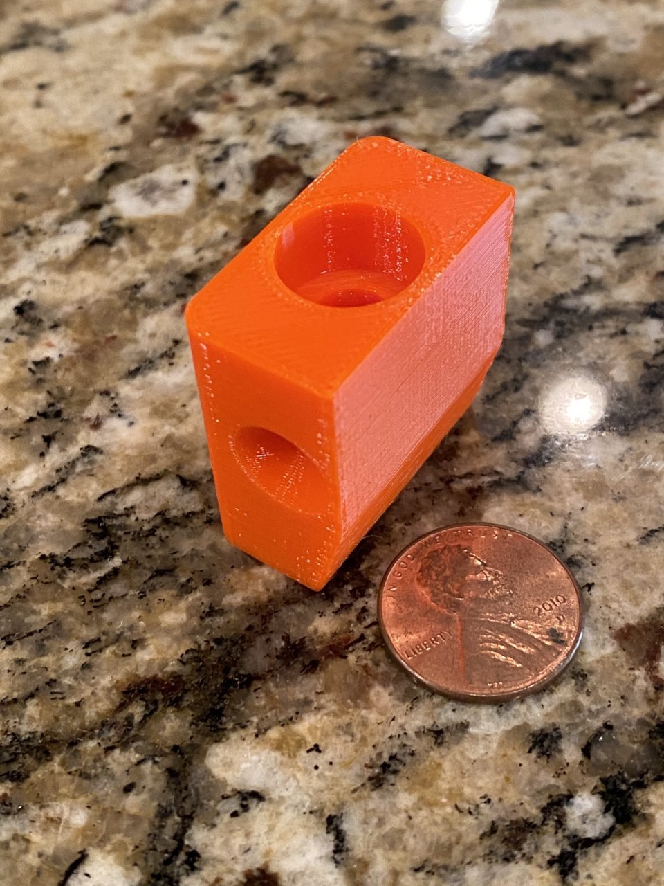

    What I didn't like was the RAM arm pushing the control head out from the dash and the small bounce I had when I'd hit a bump. So I decided to make my own adapter. Loaded up solidworks and had a basic idea thereafter. I printed the parts w/ my 3D printer to test out the fit before making the next revision. I reused the screw/collar from one of the RAM balls I ordered with the DMM. I'll stick with the 4th revision printed part (the picture with the penny) for a few days to make sure I'm happy with it. I live in Texas, that part ain't gonna last long! My plans are to have my final one made out of aluminum.
    So far, I'm pretty happy with the outcome! Not too bad for a radio that's been installed in 5 of my vehicles...the metal part of the mount was pretty mangled.

    Looking closer at your configuration that 2 face tape attaching the head to the black bracket won't last long either. What are the 2 3x6 holes for will you eventually pick those up.

    haha. the original mount came with foam there, I didn't have any foam so I used foam tape to make it fill the gap and stop vibrations a bit better (a stop gap). Not really using it for the sticky though. Look at the 3rd pick and you'll see the metal and plastic interlock on the back. that is what is actually holding the head. ;)
    The 3x6 holes are just another point Kenwood offered for direct mount. I used that in my last car when I had it hidden in the sunglasses holder above the rearview mirror. Won't make that mistake again!

    What do you mean? the DMM for the 2nd gen taco? or this particular adapter I'm making? I'll likely throw it up on thingiverse when I'm happy with it. I think the angles are all different between 2nd and 3rd gen, tho...
