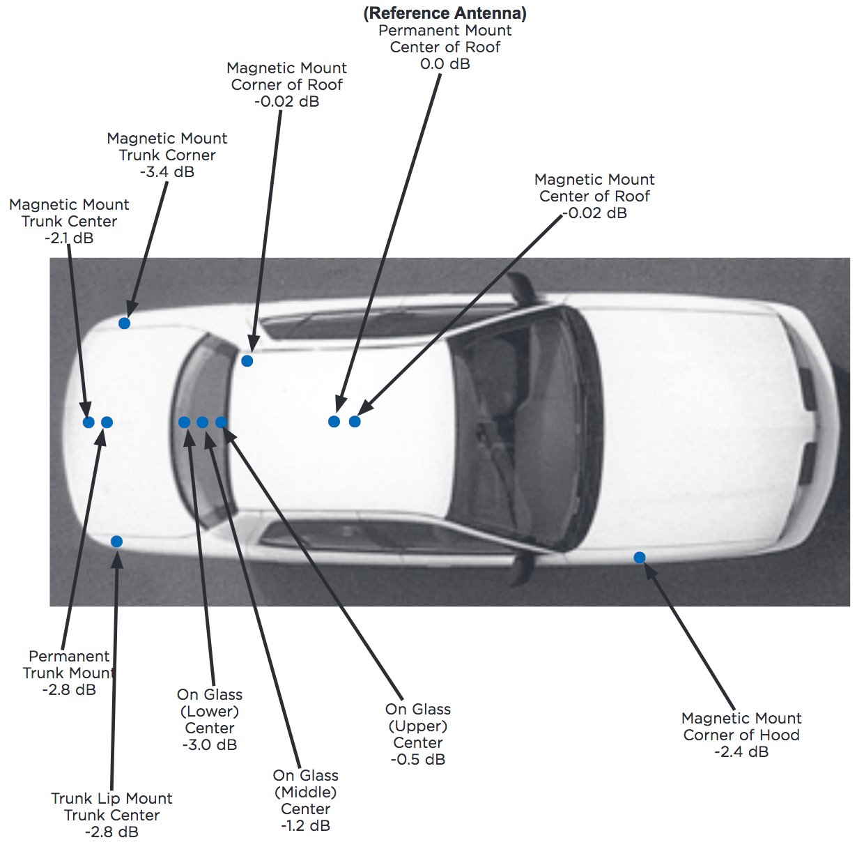

    K0BG is an awesome resource! I find it difficult to believe that a permanent trunk mount is 2dB down from any glass mount.
    The roof is the best location. I have signal stalks and they are tough as nails. I hit all kinds of things with no issues. I leave them up for the car wash as well.

    I would really like to know how they arrived at the numbers. A different vehicle profile would produce different numbers. Why do my antennas work so well inside the truck bed? Did they look at the car head on or from the side? On a step latter? Mount your antenna where it suites you it will work. A neat and tidy install with quality coax and connectors short cable runs go for it.
