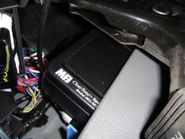

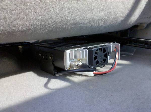

    I forgot to mention that I installed the main box under the driver's seat (more room) and the external speaker is hidden behind the driver's side kick panel.

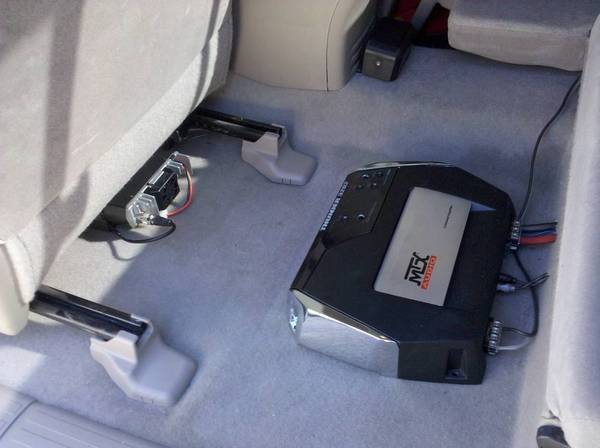

    I put my main box behind the seat in the DC. and connected the external speaker cable to the AUX input on the radio. Suppose to be for an I-Pod, but HEY, works great for a ham radio too! LOL

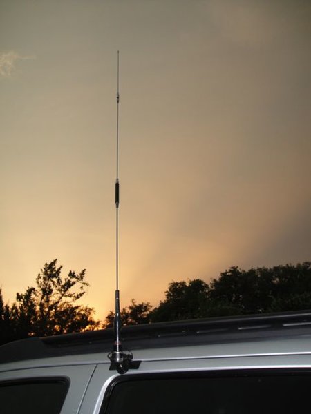

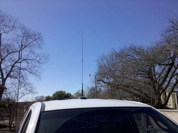

    Here are some some more installation pics..plus my antenna. SWR's are flat on both 2m and 70cm.
    73

    I usually listen on 2 meters (146.835+ 100 Hz PL) on the left side and the fire dept on the right side.
    The antenna is a Larsen Dual bander. SWR is flat. I hit all the local repeaters with ease.

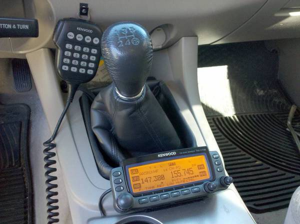

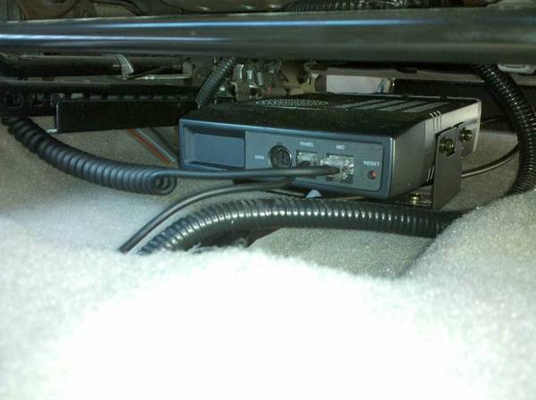

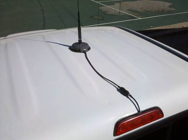

    Well this thread looks like it needs a bit of a revival so I thought I would show you guys some pictures and include the details of my ham setup I completed a few weeks back. The radio consists of a Kenwood TM-V708 w/ a Diamond NR770HB 2m/70cm Dual Band 200W rated fold-able antenna, on a UHF base. I ran the coax for the antenna from the middle of the roof, through the rear brake light housing (on the rear of the roof), and down through the headliner, through the rear left pillar, under the door seal panels, and then under the carpet and through the wire hole opening that is beneath the front drivers seat. I removed the drivers seat for the install, along with the headliner, and all the required panels to get the head liner off (which was a pain in the ass for anyone who is wondering, but was necessary to get a clean install the way I wanted). The unit its self is mounted under the drivers seat. Power and ground wires are ran directly to the battery via the firewall grommet. I have the remote head located in front the the cup-holders and just behind the shifter for ease of use and good visibility. There is also an external speaker that is installed behind the center console. It is secured with one side of industrial strength Velcro that attaches directly to the carpet. The remote face is also secured to the console via Velcro and can be removed if needed in about 10 seconds.
    Something to keep in mind about the antenna and coax cable. If you decide to run your coax through the rear brake light housing like I did, you will need to use a Dremel to cut out a small hole in the top of the housing to allow for the housing to still mount flush to the truck, but still allowing the cable to go through the housing, and into the cab. When you get everything put back together it would be a wise idea to seal it all up with some blue RTV sealer, or a sealer of your choice that would be suitable for this kind of a situation. Mine came out pretty clean and is not noticeable from the ground and looks up to par if you check it out from above. Most importantly, no leaks, etc.
    Seat all the way forward, exposing the rear end of the transceiver.
    Seat all the way back, allowing access to the front of the transceiver.
    Some random wires, along with the radios power and ground wire running through the firewall wiring grommet.
    Another picture of the transceiver from the rear, with the back seat folded up.

    The remote face and mic.
    The antenna.
    And last but not least, a picture of the splice connection I have in the coax cable. There is a fem-fem UHF connector in the middle of two rg-58 pl-259 connectors. The reasoning behind this is I originally decided to use a tram antenna and then changed my mind. Well I sure as hell didn't feel like going through the choir of taking out the headliner again and all that business, so I make a quick disconnect using these connectors to allow to quick changes between different base mounts. I also sealed up the connectors with some coax sealant in order to prevent corrosion. If anyone is wondering, I used crimp and solder on connectors.
