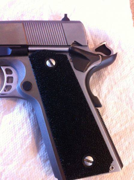

    I'm doing basic stuff like filing and hand fitting a beaver tail grip safety into my milspec. Next part is hand checkering the front strap.

    Before
    After
    Nighthawk trigger, emc hammer, cylinder and slide light sear spring, and smith and Alexander .220 btgs

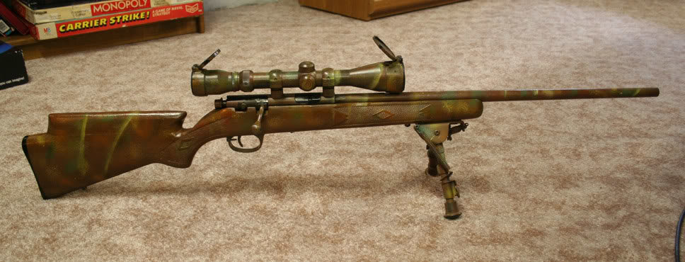

    Only picture I have of it but this was my first rifle that I got when I was 15, and I did all the work when I was 16.
    My Marlin 25n (.22lr), started out looking like this-
    -Removed the leaf sights
    -Added second sling stud in the forearm
    -Free-floated the barrel
    -Glass bedded the action
    -Bent the bolt handle out (easier to cycle the action)
    -Removed the barrel mounting screw and relocated it to the action, replacing the magazine housing screw
    -Cut the 7-round magazine down to accept 4 rounds and fit flush with the stock
    -Changed out the trigger spring for a lighter pull weight
    -Shortened the sear travel
    -Installed a trigger stop screw
    -Cut off the raised monte carlo cheek piece and shaped a new, taller one
    -Obvious camo paint job
    Could hit soda cans all day at 100 yards, 200 yards with little effort. Always head shots on the squirrels. :cool:
