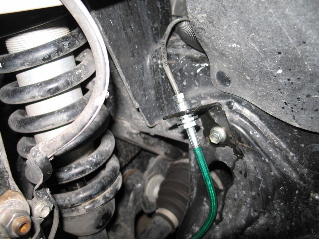

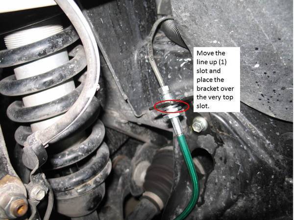

    I think I found the issue with your install. You need to move your lines up (1) slot and place the bracket over the very top slot. See photos below
    Your install:
    What I'm trying to explain:
    What it should look like:
