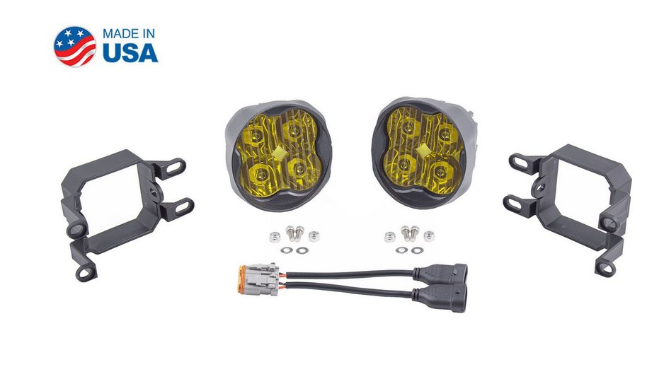

    Anyone have experience with the Diode Dynamics Ambers?

    I'm leaning hard towards these.
    I haven't seen much reviews on these, I'll have to write one up.

    They are brand new to the market so there is not going to be much at the moment. No need to review yourself because @crashnburn80 will be doing a thorough review with.... SCIENCE! Seriously he is the aficionado and his reviews and info in the lighting world are phenomenal. Check the official thread here https://www.tacomaworld.com/threads/the-led-sae-j583-fog-pod-fog-light-review.554813/
    He said his diagnostics for the Diodedynamics will be up asap.

    I ordered the yellow fog lights from them. They were released just before Black Friday. Most of them have not shipped out yet. A lot of people are really looking forward to installing these.

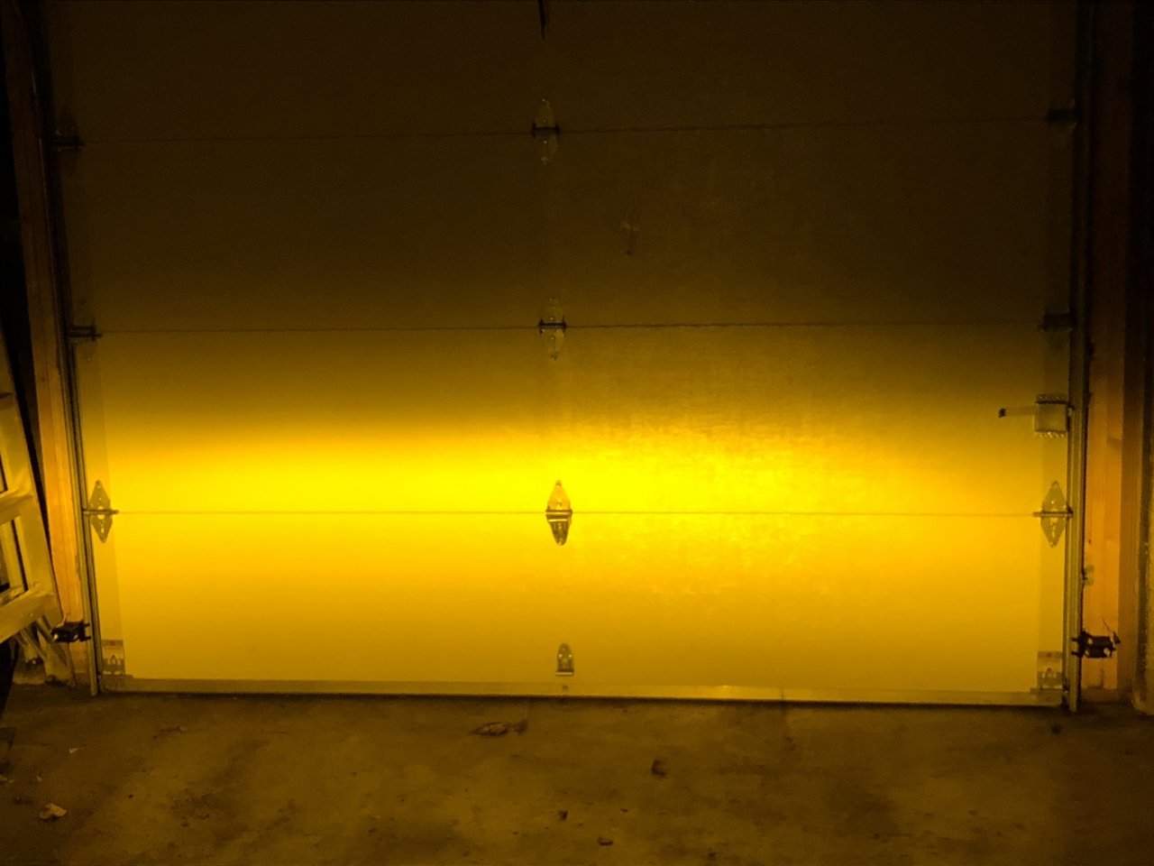

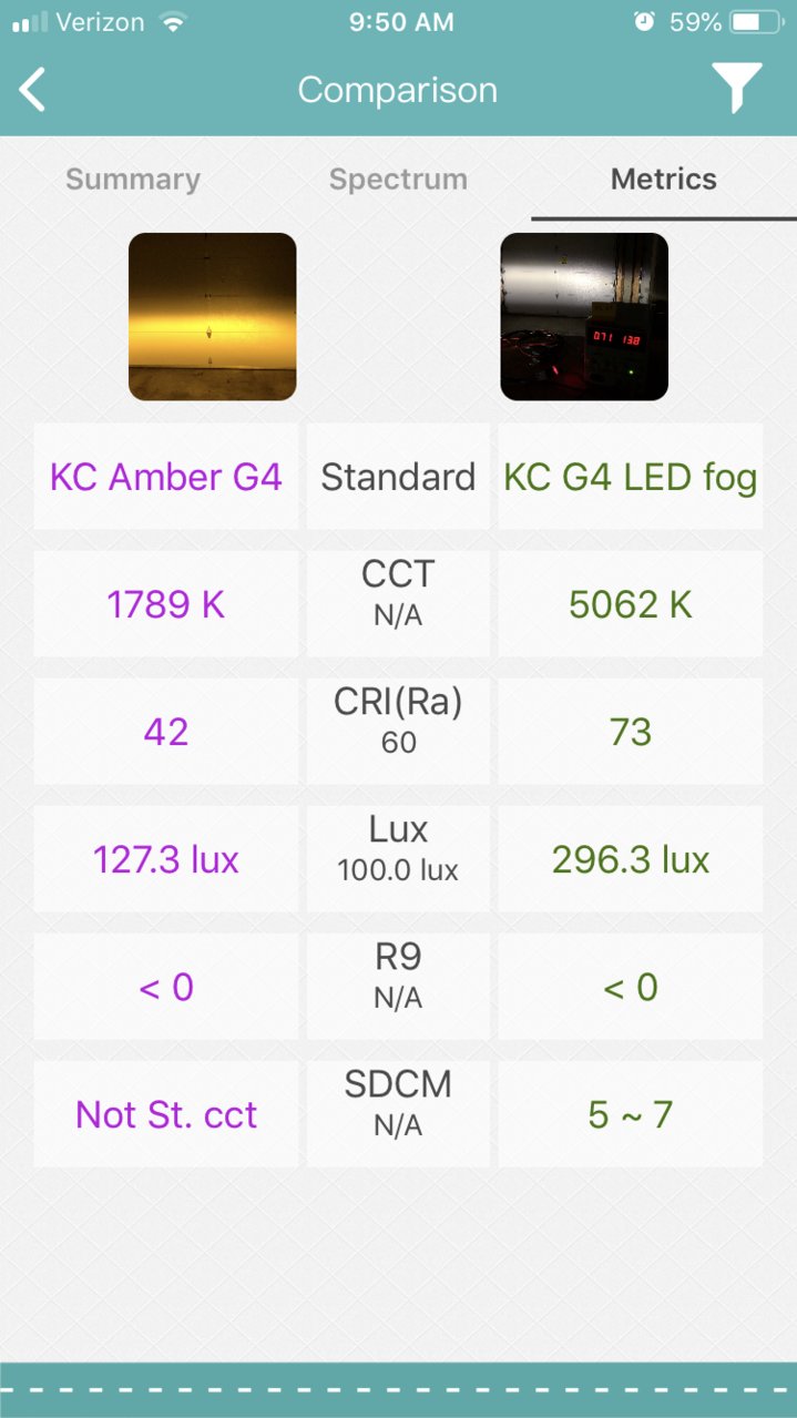

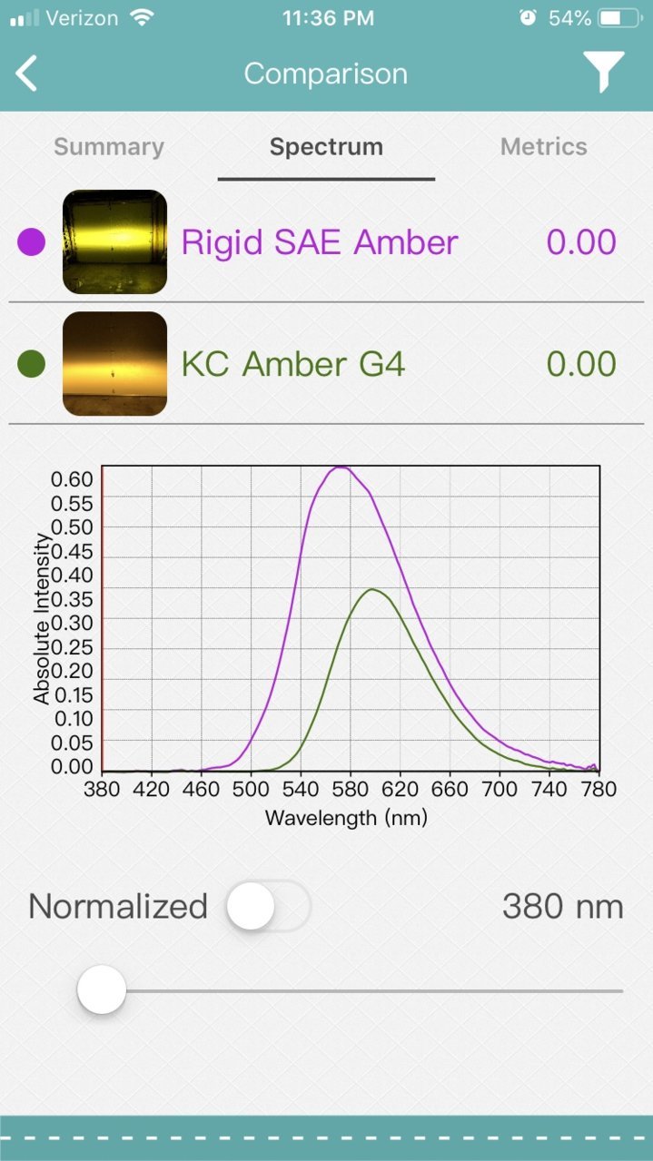

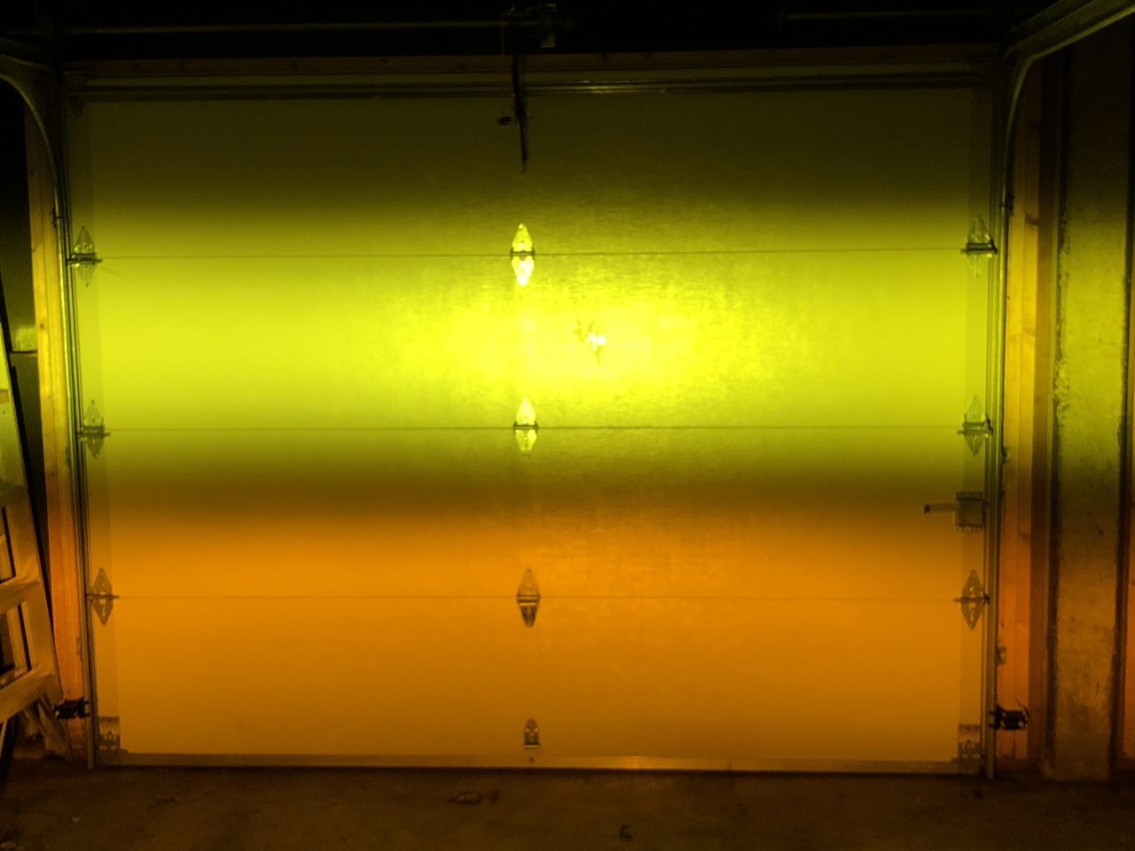

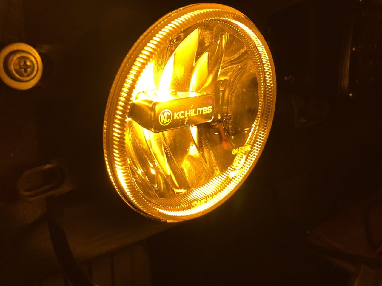

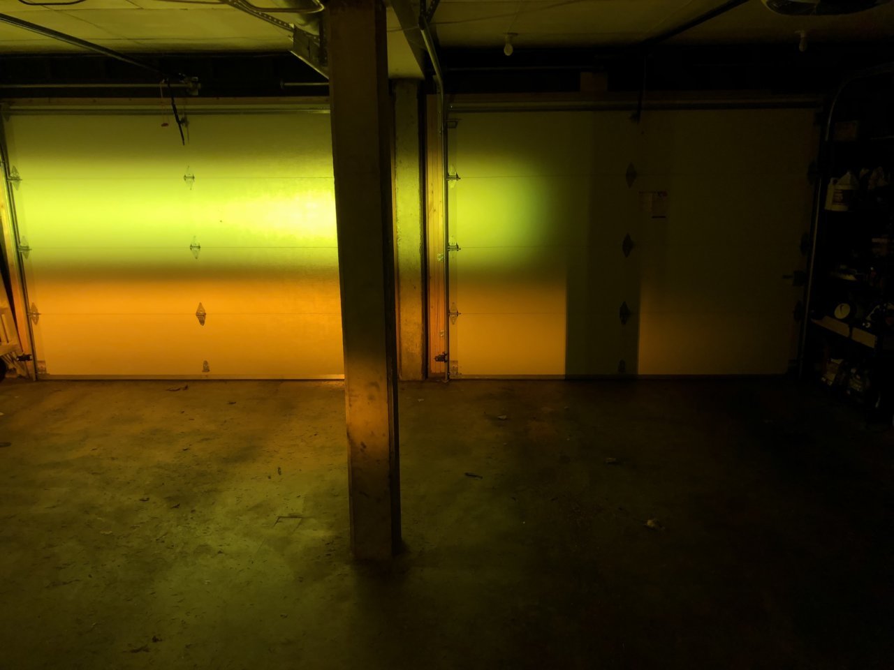

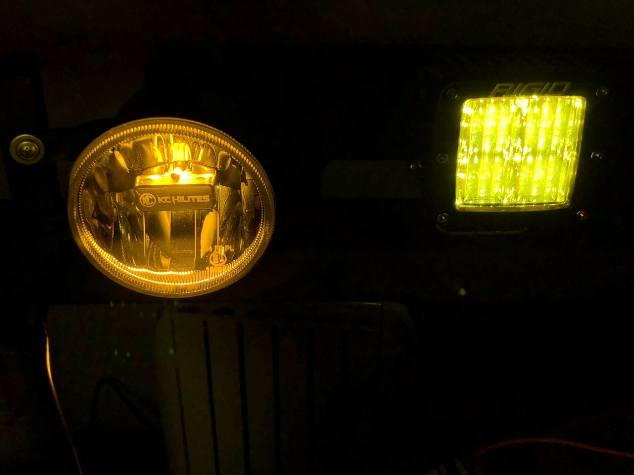

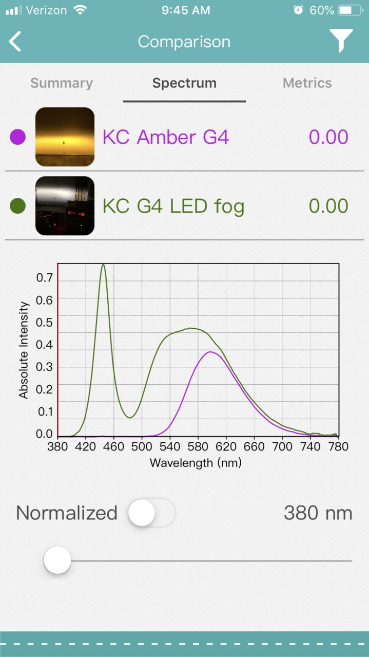

    I'm still waiting on the lights from @Diode Dynamics, I'll get them up ASAP once I have them but can't do much till then.
    The KC G4s in amber are included in that thread, as are nearly all the fogs. See the links at the very top of the original thread for all the updated product releases. KC G4 amber post below.
