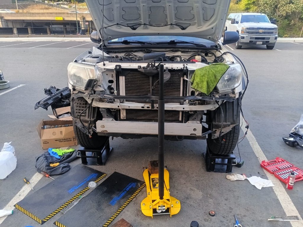

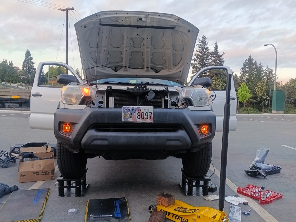

    Toyota Tacoma 2015. I don't have inside harness for temperature sensor. But have sensor outside behind grill. This sensor using only for measurements temperature or for A/C unit as well? Any chance added factory harness inside for plug and play Mirror with temperature display?

    AC unit? If you have the outside plug I'm 99% sure you will have the overhead one in there. My truck is the base model and was pre-wired for everything.
