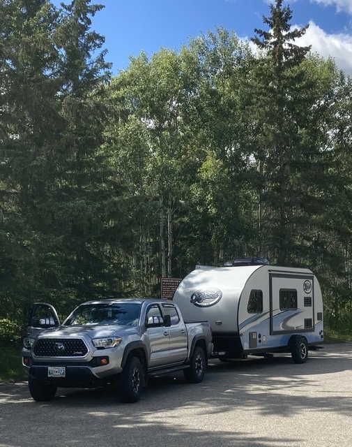

    Can’t advise you but I can tell you that I have an almost identical setup. I tow on the prairies, 2018 ORSB, RPOD179, 3250 loaded wt, 400 lbs TW. Conventional tow. I’ve always had an @OVTune and this year a @PapaRee tune so I can’t comment on towing on a factory tune.
    I did find the rear springs sagged a bit starting the 2nd season so I installed Hellwig helper springs and overall it works like it should now: level under tow, slight OEM rake daily driving.
    I have no complaints about my setup save the mileage. About 10-12 mpg under tow.
