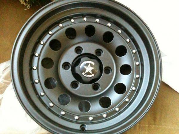

    i dnt have american racing but i do have rebel racing rims sitting in my garage and no they do not clear the caliper im ordering spacers soon hopefully rims have been sitting in there since february [​IMG]

    They barely are off by a lil more then 5/16

    What was your back spacing these are 4.5

    Thread Revival- I just put Outlaw II’s on my 07 4.0 access cab. Natively the rims do not fit as they hit the calipers. Grinding of the calipers is required for figment.
