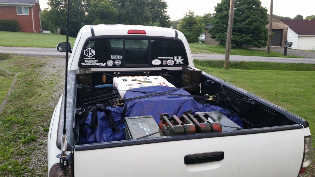

    2 proxy mine fuse boxes mounted to the rails. Used needed hardware to T-nuts in the rails. 2 different size rubber washers stacked, 1 bonded rubber/metal washer, 1 rubber only washer. The seal of the can is more than adequate to keep water and mud out. These are from the 70's-ish.

    I didn't use any spacers between the rail and can. Maybe should've. But they do rattle and it's bothersome.
    So, I happen to work where rubber sheeting in various thicknesses is available and found some unused 1/2" rubber. Cut a chunk and stuffed between the can and bedside. Wouldn't hurt if it was 3/4", but that would've needed taken from inventory and not free :)

    Even the taller "50" cans aren't tall enough to mount to the rail so the lid can open, AND rest on the wheel well.

    Put some feet on it?

    That could be done as well. But bed flex off road?
