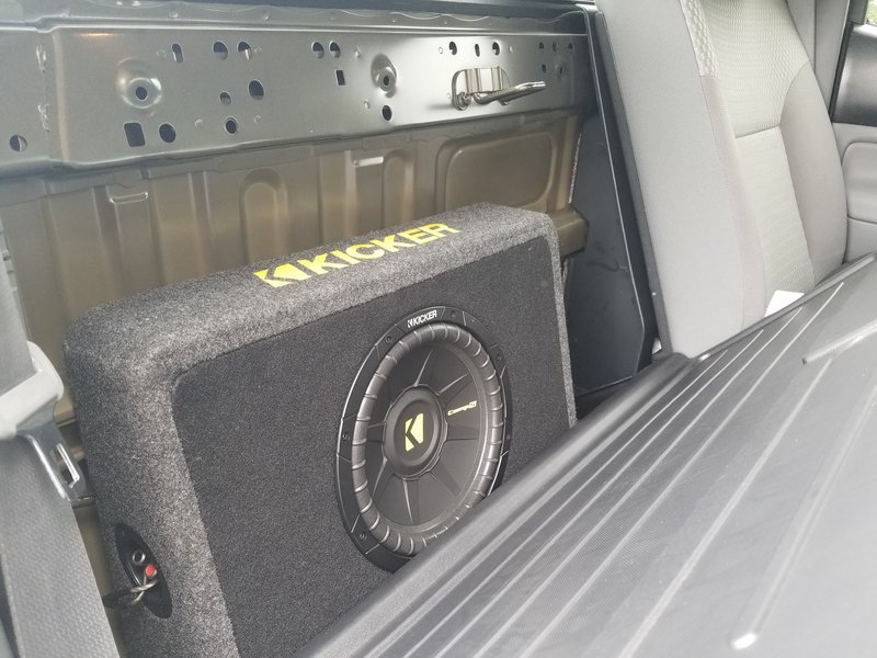

    I didn't add anything to alter the signal out of the radio. However I didn't want to cut/splice into any speaker wires so I found this: http://www.ebay.com/itm/361326435262?_trksid=p2060353.m2749.l2649&ssPageName=STRK:MEBIDX:IT I used it as a "jumper" that I could cut into without having to worry about messing up the wires in my truck. I got rid of the RCA thing on the jumper and then just cut the wires on the jumper that were for the speakers. Then I was able to run speaker wire to the amp and then from the amp back to the jumper...I hope that makes sense... It makes sense in my head, but it may not translate in the words. :eek:

    My Tacoma is a 2012 without JBL, I'm not sure if there are wiring differences with the newer models. I put the amp under the passenger seat, and the sub behind the passenger side rear seat after I removed the plastic storage bin. Let me see if I can get some pics for you.
    I love the amp. It was WELL worth the money. I am not using anywhere near the full power of it, I don't need to shake my windows and mirrors off, but I'm sure I could if I turned everything up... I have the gain turned way down on the front, rear, and sub channels, and it sounds great!!!

    Install wasn't too bad, especially since I was able to do all of my splicing sitting at my workbench (as opposed to cutting and splicing wires inside the truck) and then just disconnect the wiring harness on the back of the radio and install the jumper with all the splicing done.Subwoofer.jpg
