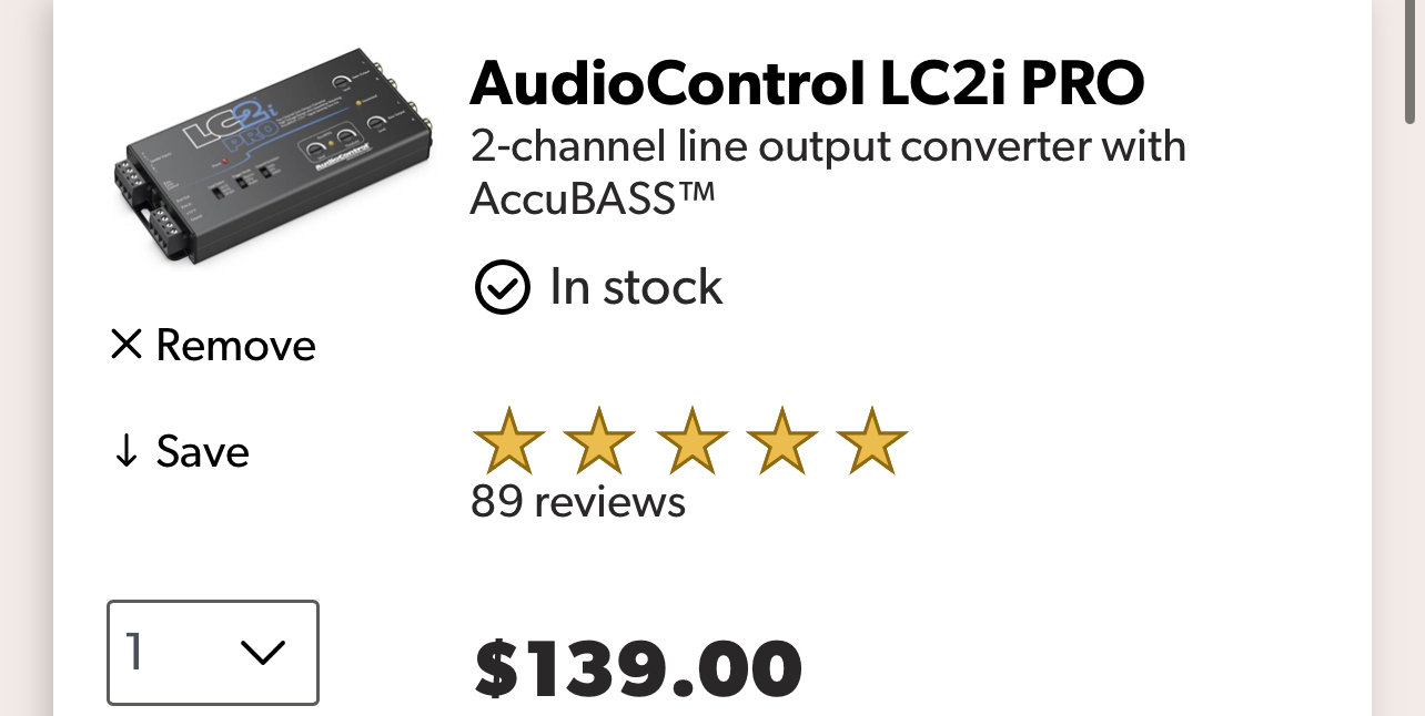

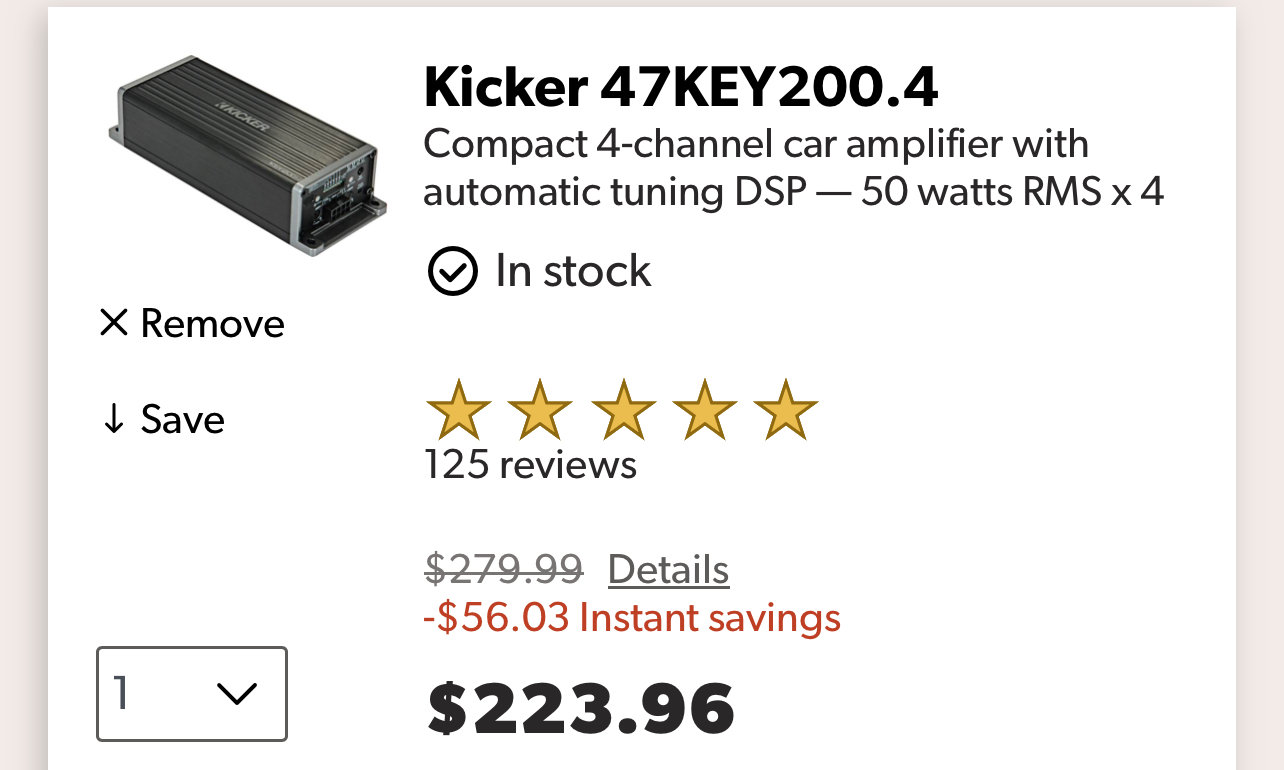

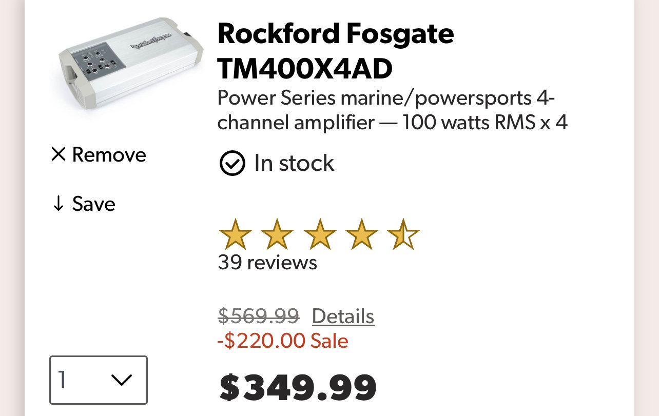

    I’m looking for help selecting an amp.
    I’m putting in kicker cs component 6x9 in the front, 6.75 in the rear.
    Looking at going with either the Kicker key 200.4 amp, or Rockford TM400x4AD with AudioControl LC2i.
    I don’t need fader control once it’s set, so the 2 Channel LC2i should be fine.
    Will it be worth it going with 100wRms over the 50wRms?
    Is my thinking right with the LC2i and Rockford?
    thanks for any input

    50/50.
    the key is nice because it had a built-in DSP that can adjust and make the speakers sound little better. you simply can't get any amplified setup, with a dsp, for a better price. i've tried...
    the rf is nice because it has more power, it doesn't need a line level converter though. both the key and the rf can accept the speaker level inputs directly. biggest disadvantage is the lack of dsp to adjust for the factory eq programming.
    the only reason to really run the lc2i in this case is for the bass processing, which really doesn't benefit you much without a subwoofer.
    but, considering you're nearly at $500 for the thought of the rf with the lc2i, that puts you within range of another option.
    https://www.crutchfield.com/S-J2g5WsEXeEe/p_161D4800/AudioControl-D-4-800.html
    that would get you 125w/channel, as well as accubass processing, and the dsp control similar to what the key offers.

    So I think I am sold on the key 200.4 now.

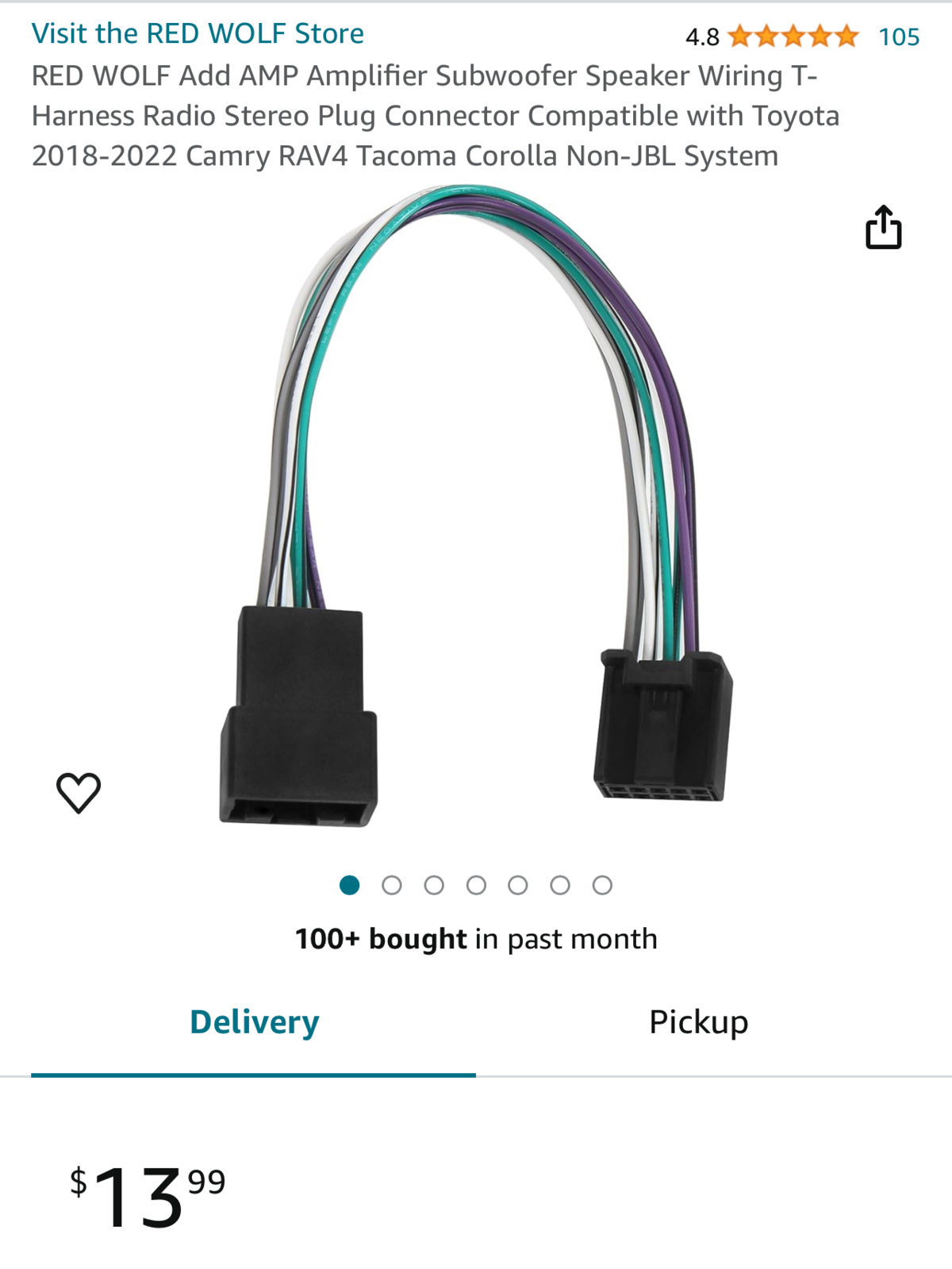

    @Tacos4all!, where did you purchase the harness from?

    It’s the Red Wolf harness that’s mentioned all over here. I have not tried it yet, but should be able to cut this in half and use one side to input to the amp and the other to get the amplified signal to the speakers.
