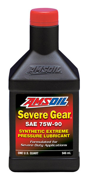

    I recently changed the fluid in the front differential that had Amsoil Severe Gear 75-90W in it for the last 30,000 miles. That stuff looked brand new when it was draining out. A mechanic buddy that let me use his lift to change the oil even commented on it. The time before last I had Toyota do both differentials and the transfer case. The Toyota oil looked pretty bad in the front differential when I drained it to put Amsoil in. Almost a milky color and very dirty. I'll be changing all the fluids in my Tacoma myself from here on out and using the good stuff!

    The transfer case and the rear differential looked good with both the Toyota oil and the Amsoil. I remember other Tacomaworld members also noticing the milky color of the front diff fluid in another thread. I know my oil observations might not be that scientific, but there was sure a difference in appearance.
    I paid Toyota $160 to change the fluids in both diffs and the transfer case. When I did it myself I spent $100 on full synthetic oil. I just feel better about saving money and using the good stuff.

    I had the same issue at 30k. Front diff was milky, the rear and t case were clean. Have amsoil severe gear in all three now.
