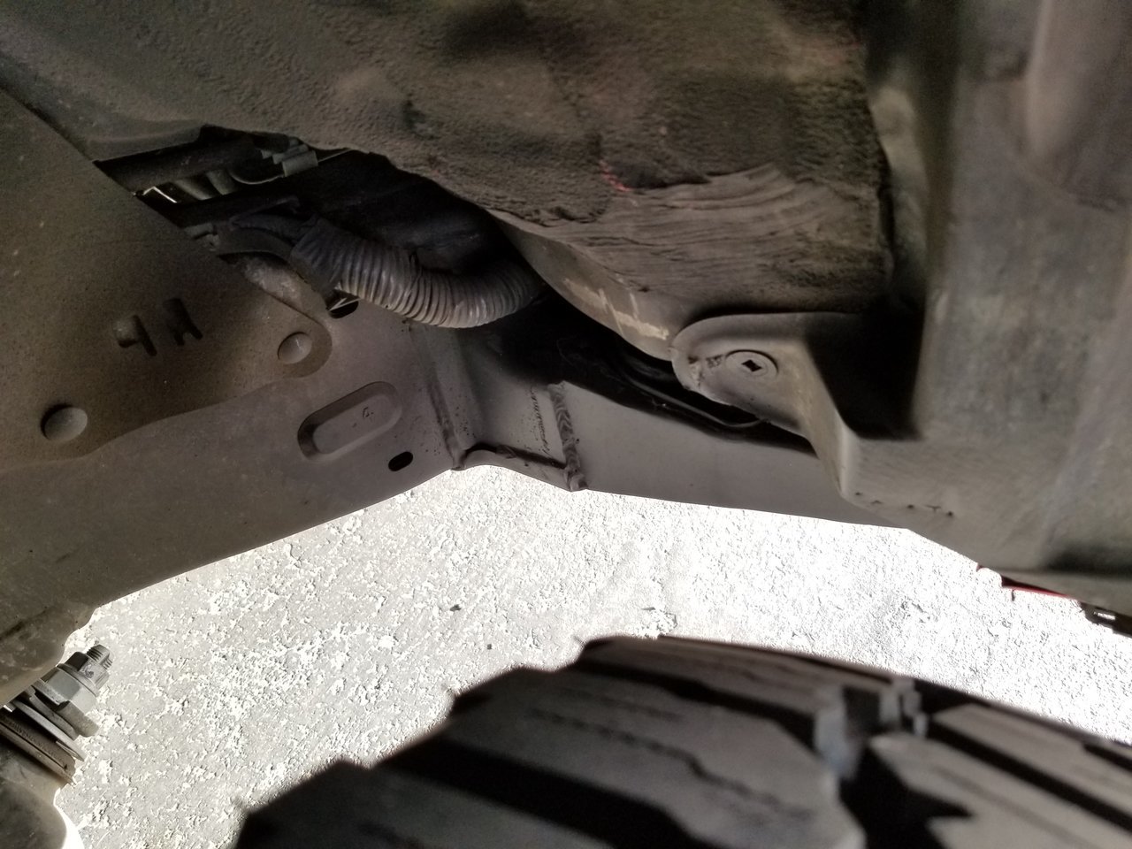

    Had to cut quite a bit, could have avoided that by getting light racing uca's that allow for up to 4° caster. Mine maxed out at 2.75°, CMC plus some plastic.

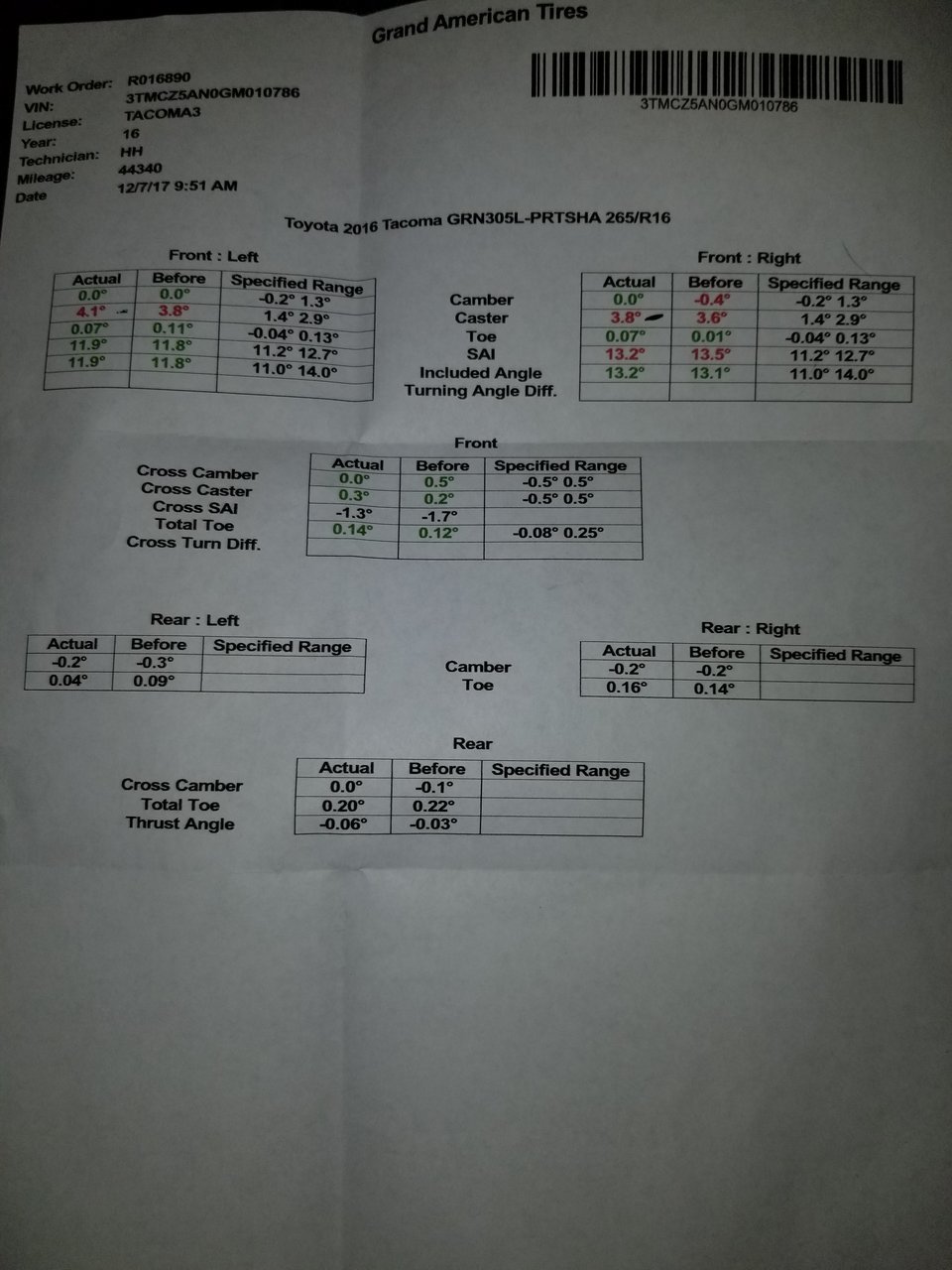

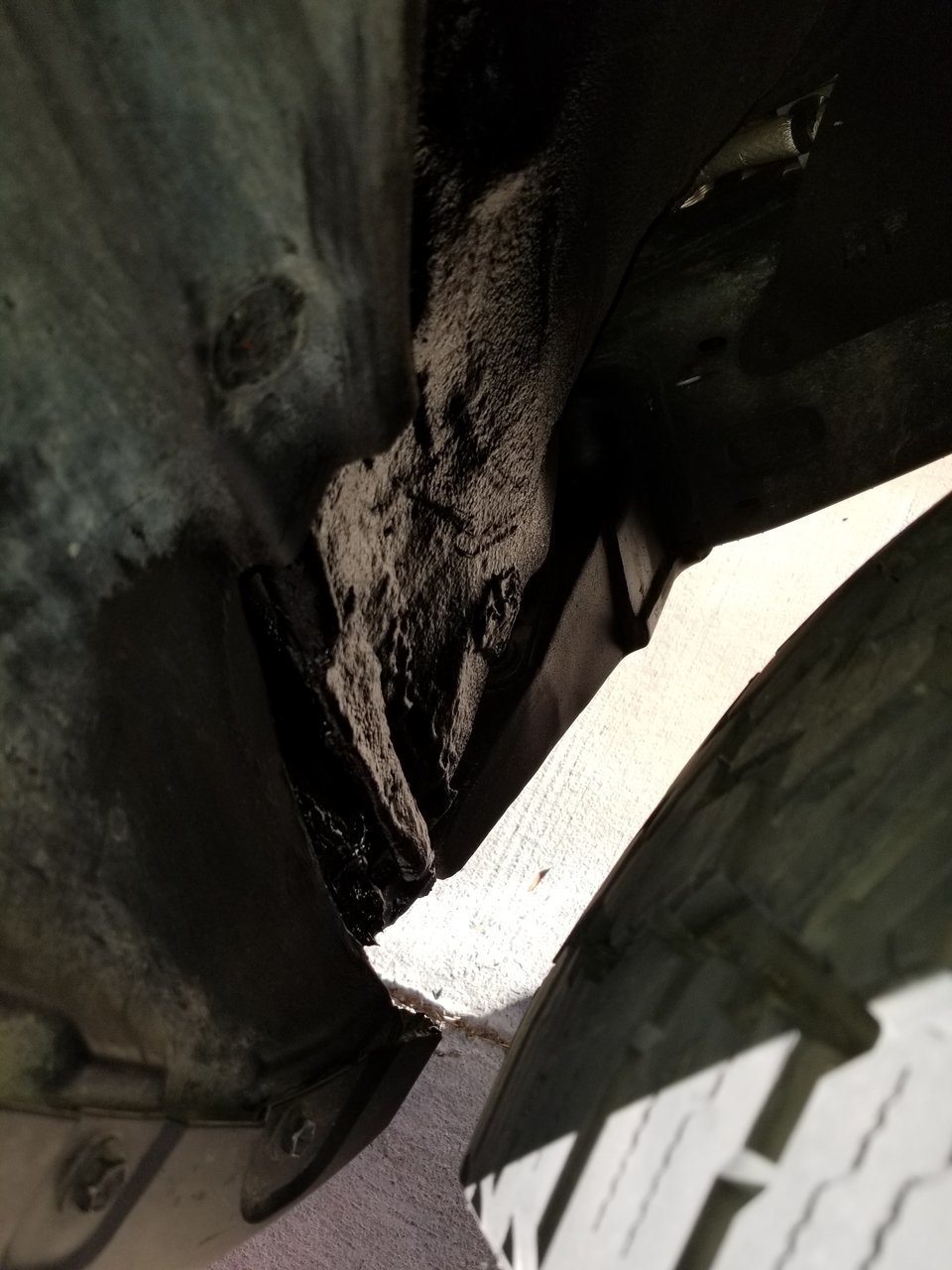

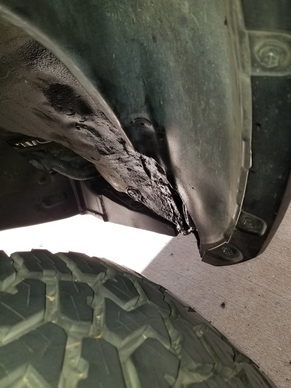

    *Looks like I need to reshape the inner fender wall, the pinch welds are rubbing on one side....odd. *had he alignment redone, got 3.8/4.1 than bent pinch weld back and trimmed, no rubbing at flex...but havent full flexed it yet.

    Pinch weld bend over and flatten & plastic removal. It's ugly but it works.
    Alignment, 4.1/3.8 caster

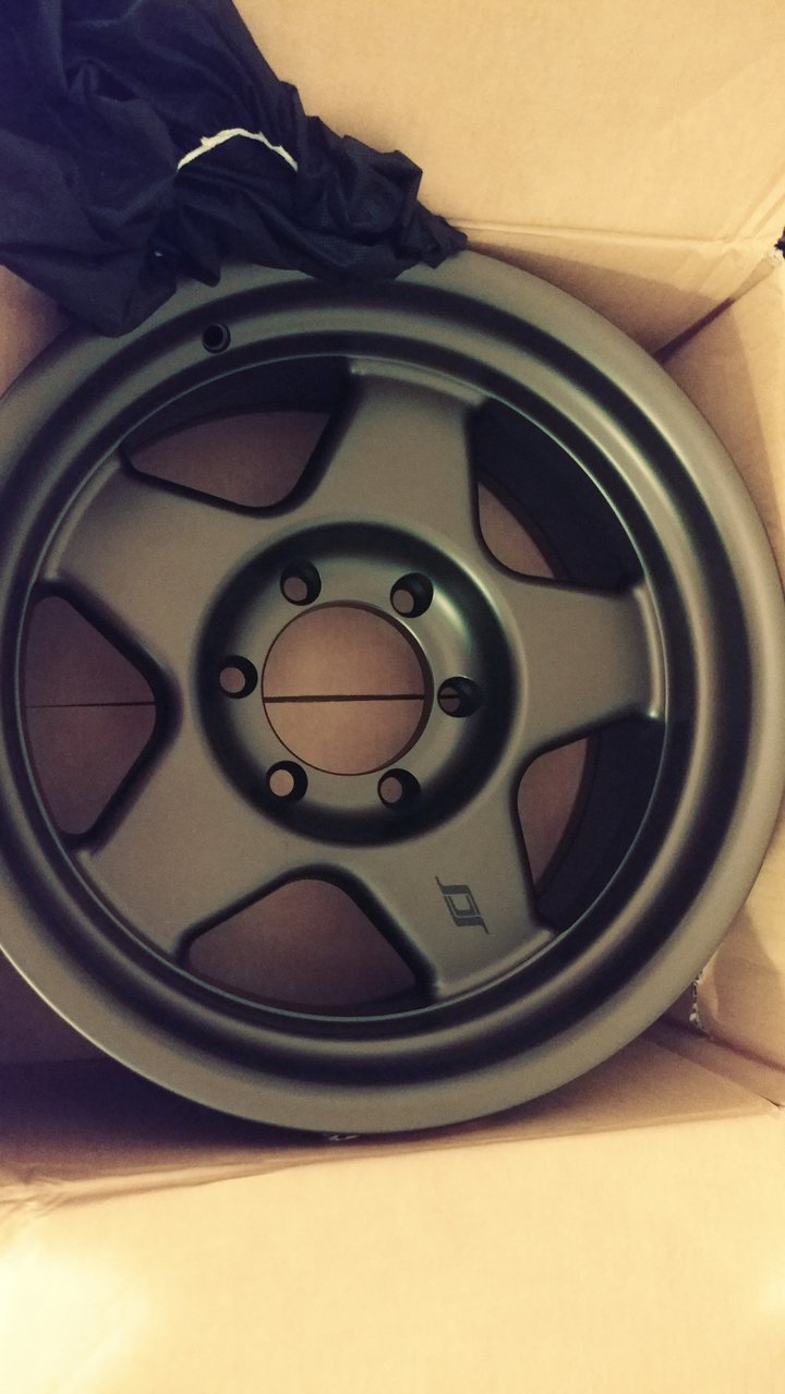

    Rims: SCS F5, 17x8.5 4.3BS/-10mm OS.

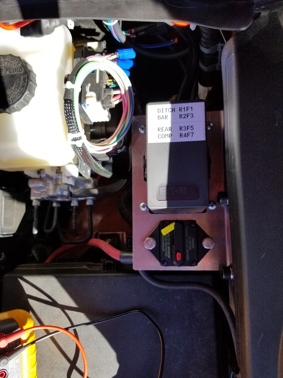

    relay box with switches, almost expensive as spods

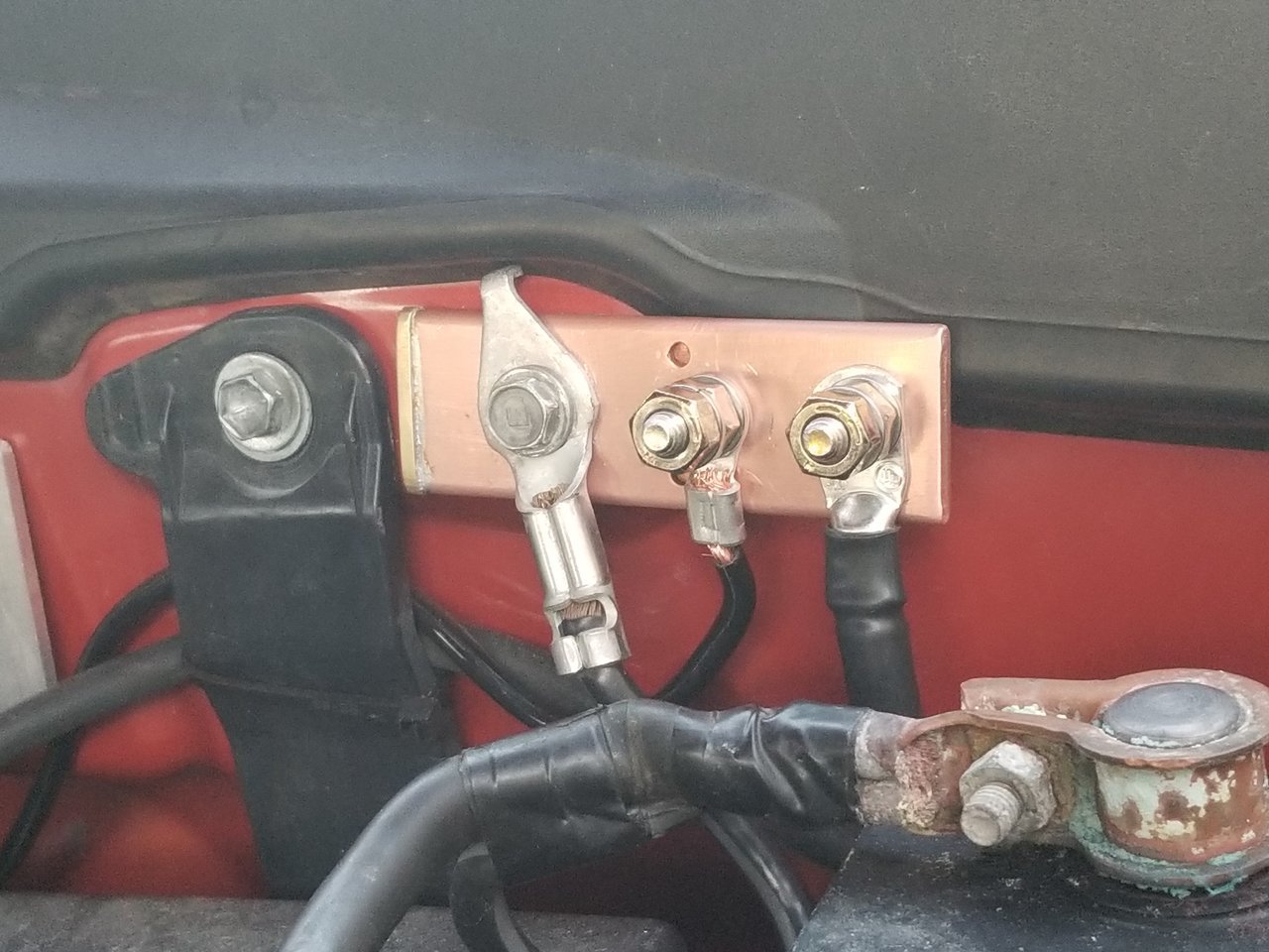

    20180301_173645.jpg repurposed blade fuse copper plate

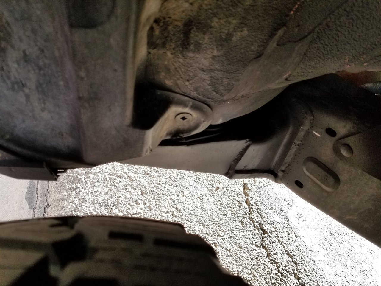

    all the above even with this alignment 4.1/3.8 caster. I highly suspect the 4.3 backspace and -10mm offset. My guess is 4.5" backspace with zero offset won't rub at all( hint, hint to @SCS)

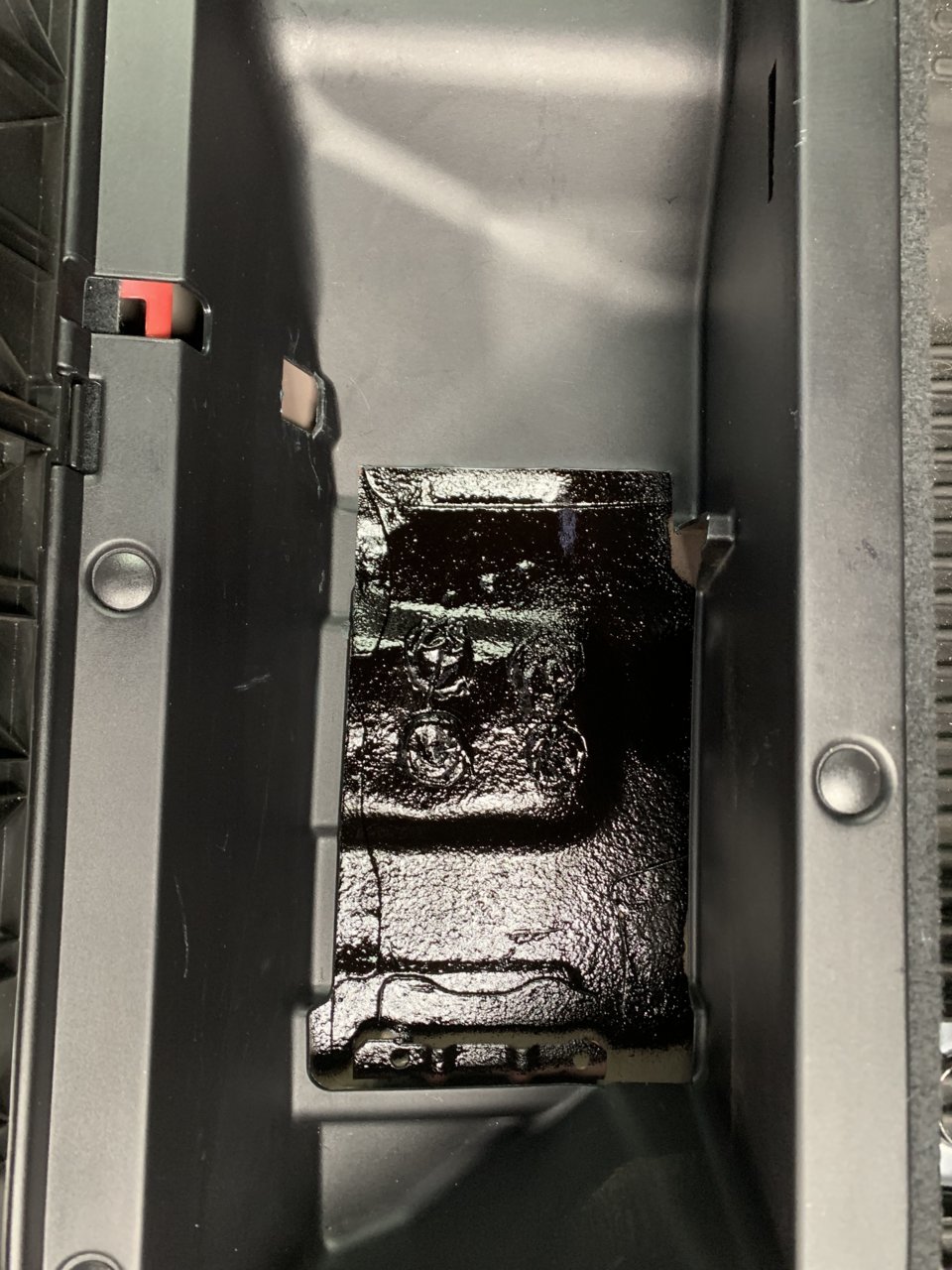

    20190110_153153.jpg One more thing off the list, actually I had the "leak" so might as well upgrade.
    Side note, bolt locations were about 3/16th of an inch too long had to drill the cab.

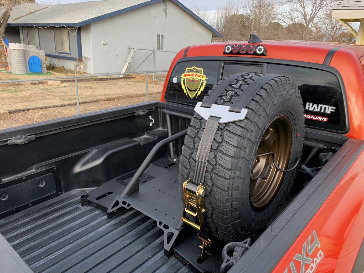

    IMG_0097.jpg the chase rack...

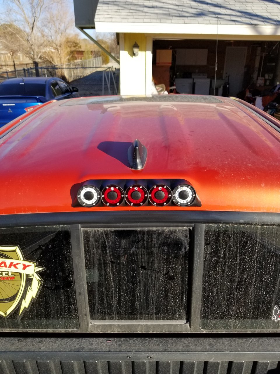

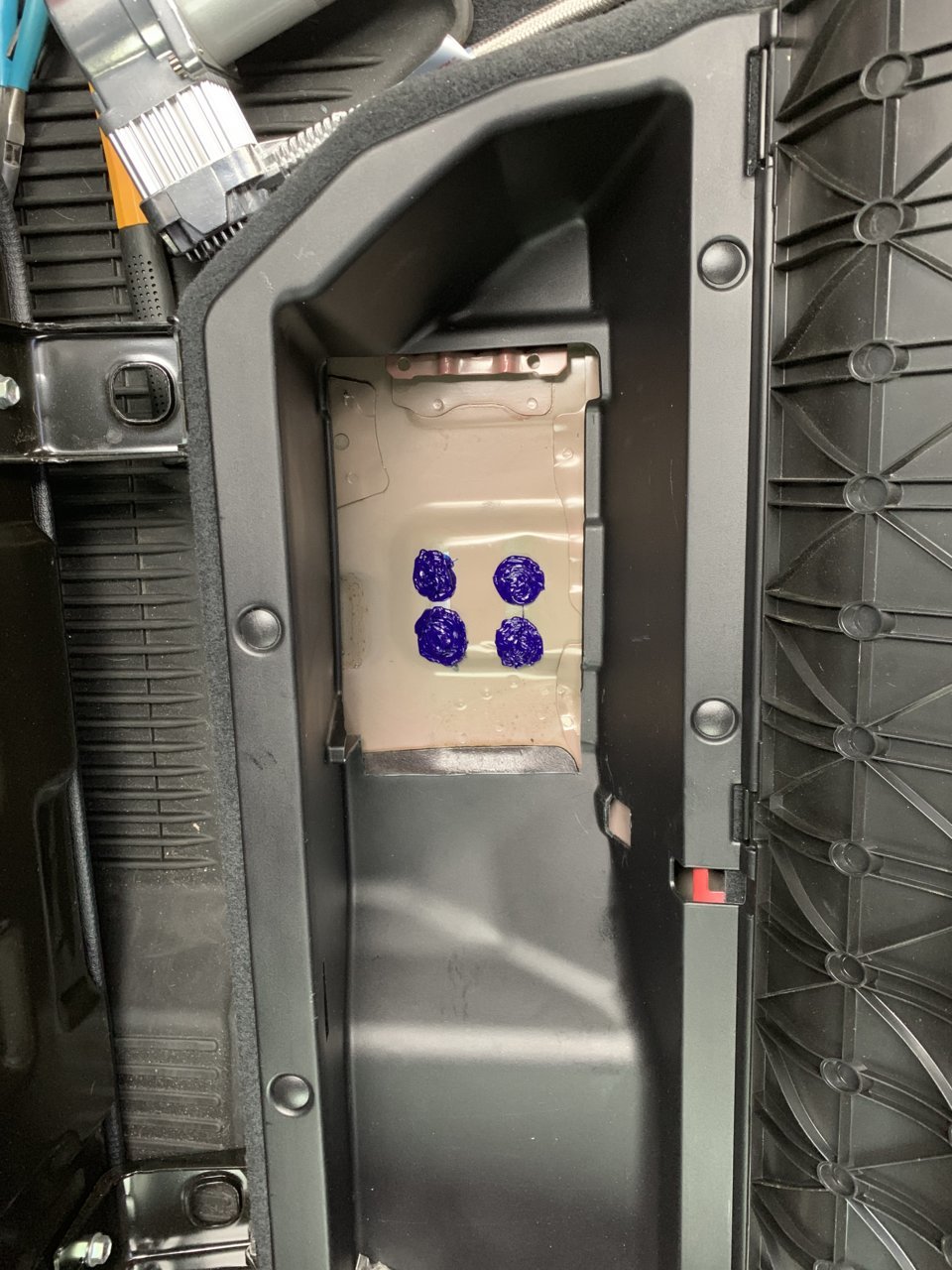

    I don’t however I did use loctite gasket sealant on the backside of the actual KC lights and the seal between the light and truck. The wiring was simple all black connected together the red wires from brake lights to one wire and the red wires from the bed lights to another. The bed lights are so bright I’m going to tie them into the backup lights possibly. Either that or use another set of Rigids.

    did you ever wire the whites into your reverse or nah? I've got a housing coming today for my kc's. waiting on my lights then i'll get it all wired up. Thinking of hooking my whites into my reverse too but i feel like it would be a pain in the ass.

    Not yet, you could find the reverse power lines in the fuse box and jump between the fuse output of the reverse and cargo lights but then again when cargo comes on so will the backup lights unless you use a diode in the circuit to prevent power from the cargo light circuit lighting up the backup lights. Not too much of a pain, might be the next mod I do after finishing the current project.
