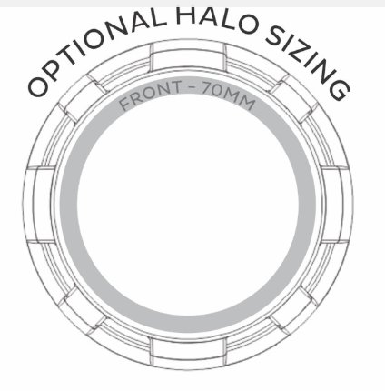

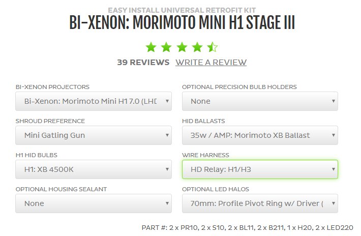

    The tried-and-true solution for the 04 is to use TRS Mini H1s v7 / Stage III, and if you want angel eyes glue them on the front of the Mini Gatling Gun Shroud with JB Weld as shown on the TRS website. For housings, you can use the TYC CAPA certified ones and you'll have no problems and you don't need a new roll of butyl rubber to re-seal. Thus far I haven't heard of anybody being unsatisfied with the bang per buck with this approach.

    Here is the standard order, from here: https://www.theretrofitsource.com/bixenon-morimoto-mini-h1-stage-3?quantity=1

    So the wiring that comes with that one in the link all I need? Just these from trs, housings, and I’m good to go?

    For parts and wiring, yes it has everything. You would still need JB Weld to attach the halos.

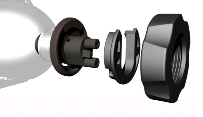

    I just noticed that TRS made a new mount to better line up the bulb in the mini H1's. It does look better than the stock clip and although I have gotten pretty good alignment, I could never get perfect bulb placement-- so for my install at least these MORIMOTO MOTOHO1DERS look like a great upgrade and are probably worth adding to your install while you have it taken apart if you go with the mini H1s.

    I have these newer mounts and they work great
