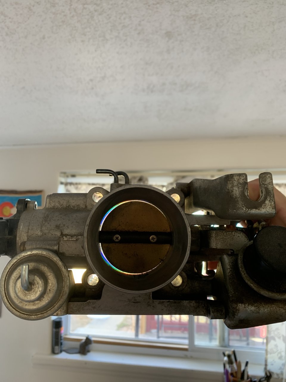

    Yes like the thermostat being stuck open is another possibility. I had 3 different things all lending to a high idle. Required fixing all to get back to spec.
    BUT, if you have the wear issue In the Tb like I had, I’m telling you, until you have a fix, don’t clean the carbon buildup around the butterfly, it acts as a seal. When you remove that seal, more airs gets by and the computer has to deal with the excess air somehow, and it matches the rpms to where they should be based on how much air is entering the system.

    I ended up with a junkyard TB with a similar but less significant issue than mine. I solved it by placing a shim washer on the shaft to center the butterfly valve. You might be able to do that

    okay, that’s fair. So I’ll say, cleaning the carbon buildup will expose the problem more, leading to worse symptoms of the problem.
    I’m not sure how semantics changes the reality that the rpms will go up IF wear is the issue and you clean the carbon seal away.
    I agree, most people wouldn’t have any idea that was the issue until they cleaned it. In all honesty, I didnt know, and I ended up making my symptoms worse to the point where I was idling up past 3000. (When the real problem was my Tstat stuck open, if I would have just fixed that Tstat and radiator, I wouldnt have had to go get a new TB for a long while)

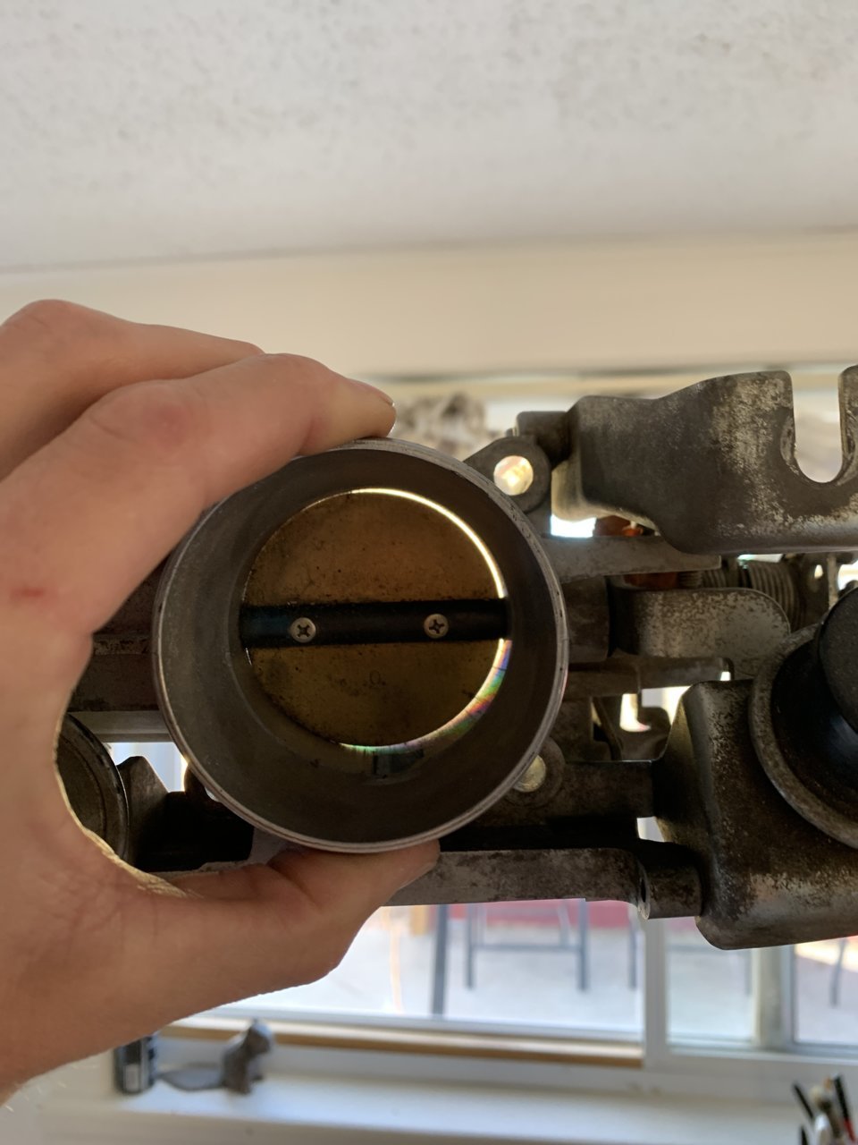

    So I decided to take it off and clean everything. I included a picture of it clean and yes the carbon was keeping a tight seal and now you see it has light coming through all clean. And yes it did Idle at slightly higher RPMs now.
    I’m guessing now the best way to fix this is just get a brand new one.
