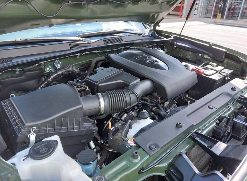

    2020 Texas made truck. 16K miles. Never off roaded, never towed.
    #2 and #6 cyl. valve failure. Oil changed at 7K and 14K miles.
    https://www.tacomaworld.com/threads...-failed-leak-down-test-only-16k-miles.773172/

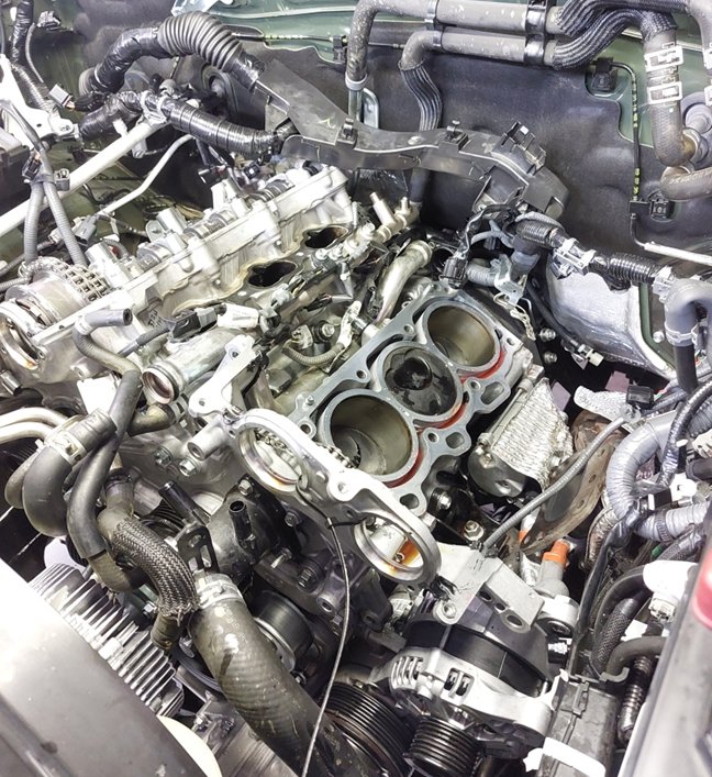

    Its a problem on the 2GR engine, and from what I have seen in the dealership, it is always bank 1. We were instructed by TAS to replace the head and valves. I have done 6-7 Tacomas and 3-4 Highlanders. Seemed to be on 17-19 and right about 58K miles on each of them. I have yet to see this on 16, 20 or 21's. And those numbers are small compared to the number of Tacomas and Highlanders we see on a daily basis for service. Have do fear, your truck will be as good as new when returned to you.

    That's how I return them to customers, Like I've never been in there. Have actually been accused of not doing the work before, because I put everything back in the same location. To the point of matching the marks the hose clamps leave in the hoses. Good to see other tech's take as much pride in their work.

    The parts replaced were always the Head, valves, and all related gaskets and fluids. I would also replace the valve springs. I think it was a valve seat issue. But I never really took the time to try and figure it out. It wasn't anything that jumped right out at me as being the failure. Toyota probably did a running production change. Could have been any of several issues, from head not machined properly, bad seat, ect.

    They were all in about a 10 month period, I haven't seen one in close to a year now.
