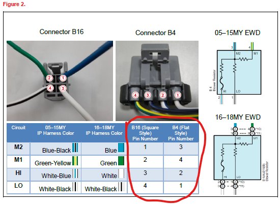

    That's not how I read this. IMO the white wire (1) in the flat plug needs to connect to the (1) port on the square connector, which would mean you connect the original white to the blue on the square connector pigtail. Etc. IOW do not go by the colors.

    OK, that maybe makes sense. I was matching by the numbers in the photo. Although I am still confused. Because if port 1 on both the flat and square go to the same part of the circuit this other mapping doesn't make sense. But I guess it'll work out.

    It goes to the same port IN THE CIRCUIT, but not the connector and resistor. I haven't compared it yet, but there is another older thread where someone figured out the remapping on their own. I just wanted to put the TSB in the forum for anyone needing help in the future.
    I'll see if I can find the thread later.

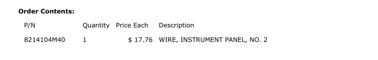

    Hi, just replaced the connector on mine and can confirm this is the right part number. It is the connector with wires. No need to fret over schematics/colors, just hold the connector at same orientation and cut/splice the connector wires one at a time.

    Just wanted to update - it finally shipped today. I placed the order on April 19. I first inquired on the 22nd if there was any ETA (when I've had to order stuff from the local dealer, they readily see where the part is available so easily give at least an estimate of how long before they get it), noting that their website stated most backorders ship in 1-3 business days, and got a response (the next day) that the pigtail was backordered with no ETA.
    On the 27th, I emailed again saying it's been just over a week now and if there's any ETA. I received no response, but got a notice today that it shipped with tracking. It was the first time I ordered from Elmhurst Toyota (online), but will PERSONALLY likely be the last as they have not been very responsive/communicative about the order. I have had much greater luck with Conicelli even when there's been a backorder.
