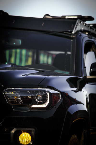

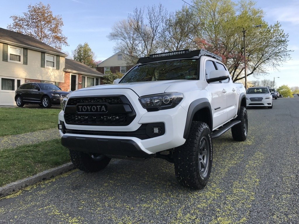

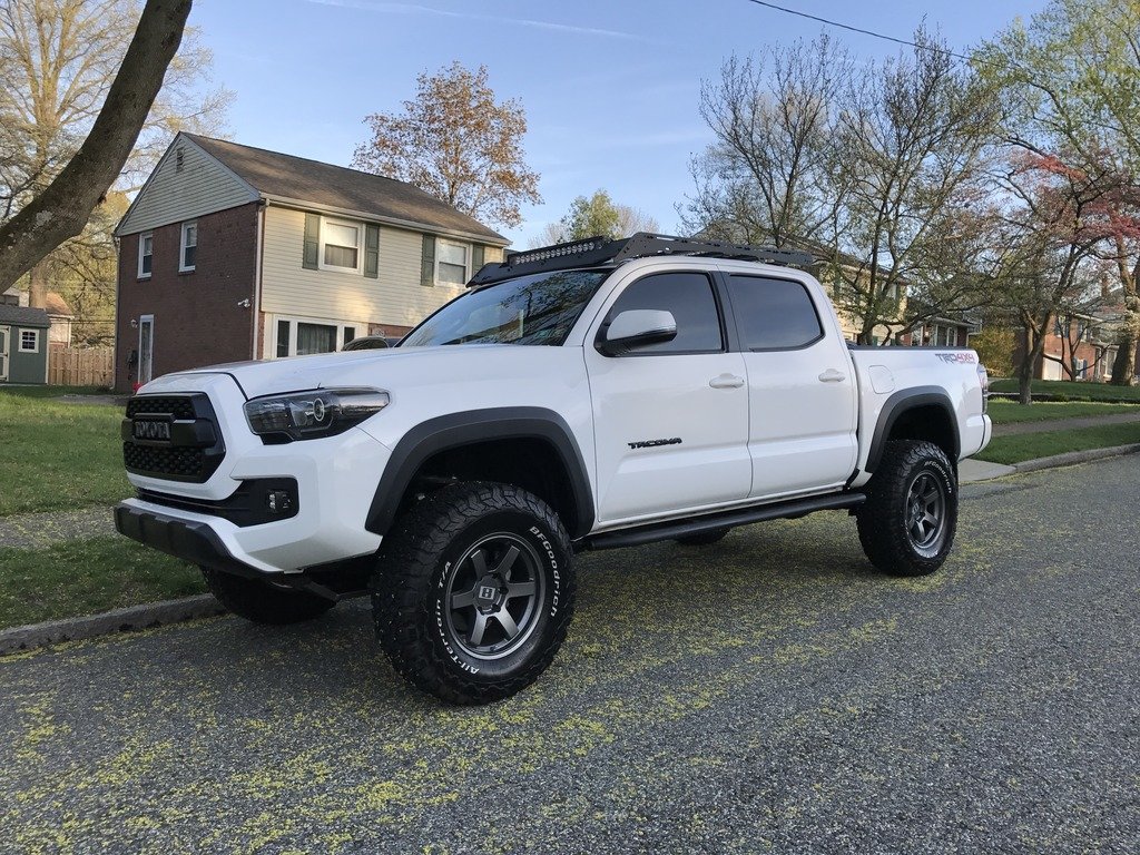

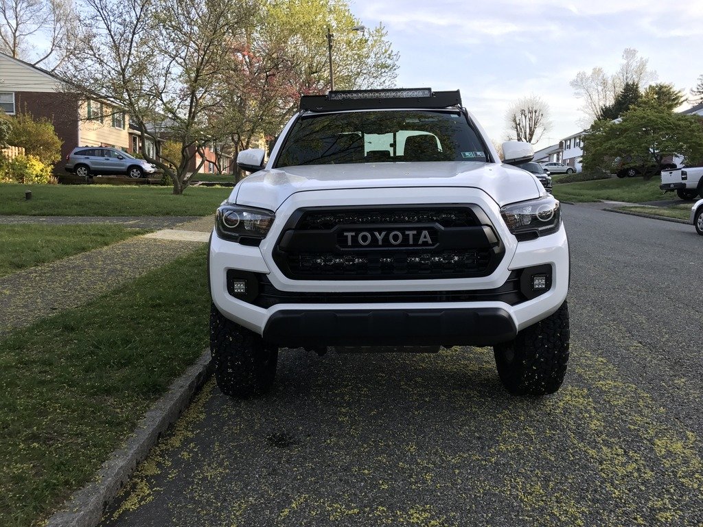

    Hey All,
    Figured I would make a thread showing my finished product, for all those who might be thinking of doing the BHLM mod. I followed a few threads on here as far as the process goes, I believe the only thing I did differently was I added the halos.
    Anyway, I did the BHLM coupled with RX350 Projectors with STI-R tuned lenses, 5500K Morimoto D2S bulbs, Morimoto XSB 3.0 Halos as well as all the associated Ballasts/Ignitors/Wiring Harnesses.
    Below are some pictures, and a video showing the switchback amber function for the halos (Just had to tap into the turn signal hot wire)

    What is your lift and tire size?

    Nice! Let's see some nighttime light output and cutoff.

    Thanks for the kind words everyone! Lots of work involved with them but I am thrilled with the way they turned out!
    No moisture yet! It's rained a few times, and a few humid dew filled mornings so far.
    Approximately 2.5" - 3" of lift (Bilstein 5100's with OME888 springs and Dakar leaf pack in rear) and tires are 285/70/17.
    Light output is awesome and the cutoff is super clear and crisp, I'll get some pictures!

    Is that a prinsu rack?

    Yup! Prinsu rack, I love it.
