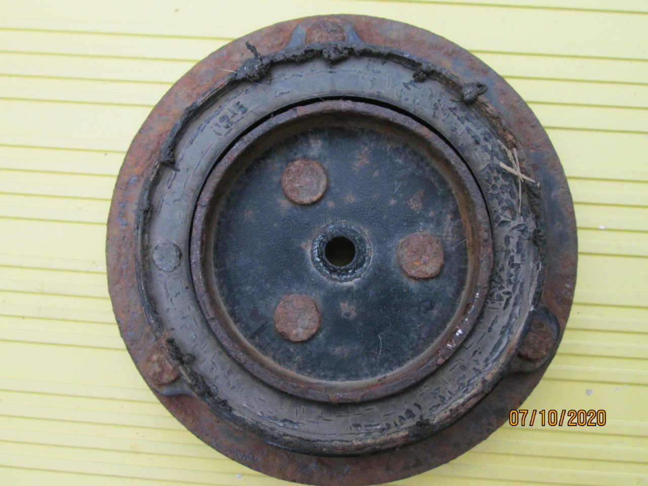

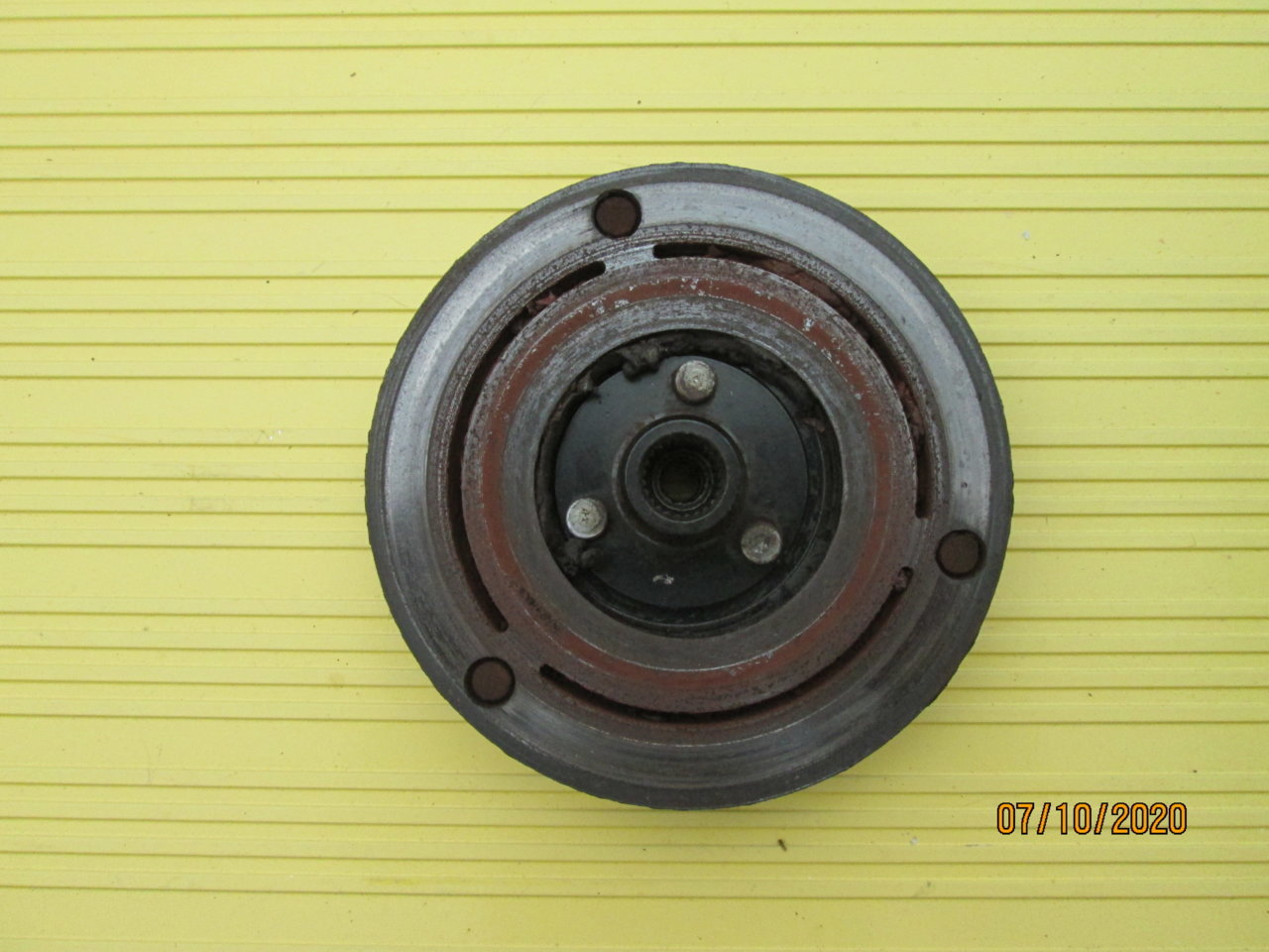

  13. Jul 10, 2020 at 1:56 PM
    Crow Horse
    Crow Horse [OP] Well-Known Member
    Jul 9, 2016
    #191597
    1,037
    Central NY
    2015 ACLB TRDS, 2012 DCSB TRDOR
    I pulled it apart today and this is what I found. I'm a bit surprised that it wasn't worse than it is. Now I'm dead in the water waiting on parts. I checked with Toyota and it's nationally back ordered with no ETA. 274 have been shipped from Japan but the whereabouts is unknown. With that in mind, I reluctantly had to order a generic brand so I can get back on the road and that will probably take a week to get here.....IMG_3967.jpg IMG_3968.jpg

  14. Jul 10, 2020 at 2:00 PM
    CurtB
    CurtB Old Timer knowitall
    Dec 30, 2014
    #145266
    7,038
    Curt
    Kansas
    2010 Tacoma SR5
    That clutch got HOT.

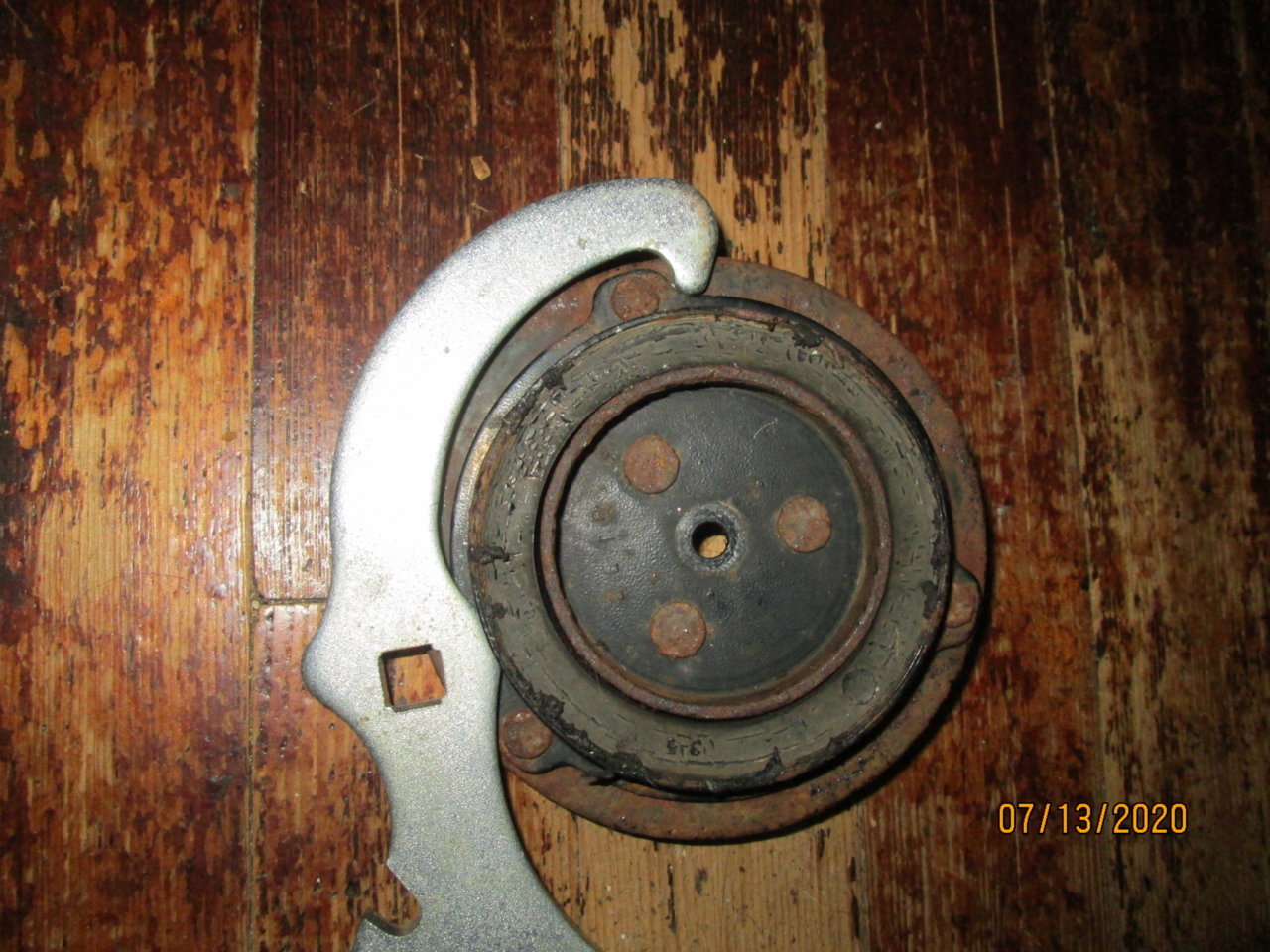

  16. Jul 13, 2020 at 6:16 AM
    #16
    Crow Horse
    Jul 9, 2016
    #191597
    1,037
    Central NY
    Still waiting on the clutch but I started looking into fabbing a tool to hold the hub while I torqued the bolt. It's not a big issue and I didn't have to do anything. It looks like a sink drain wrench will hold the hub while torquing the bolt. Being that the torque value is so low this should work. Haven't tried it yet....IMG_3970.jpg work well.

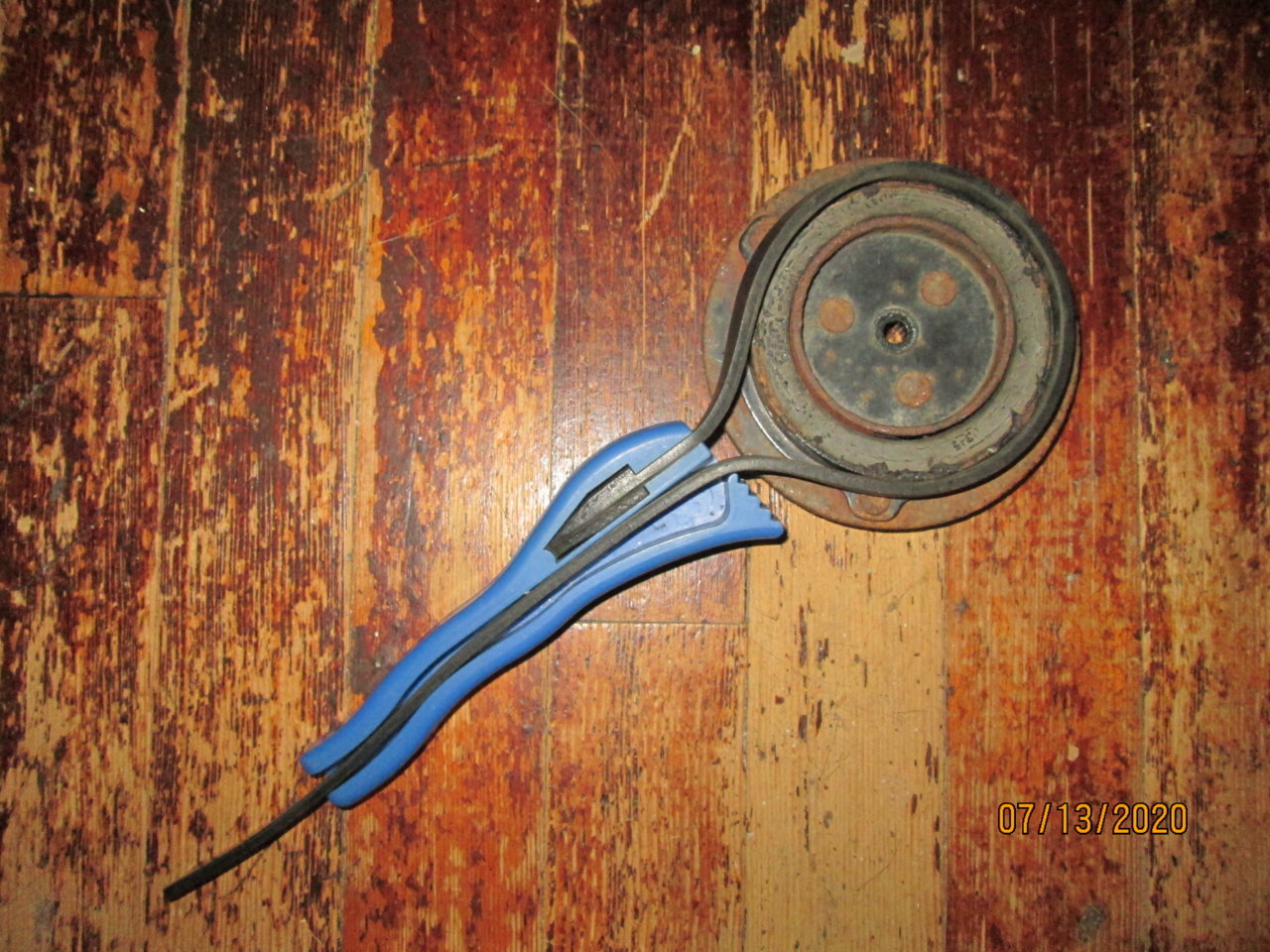

  17. Jul 13, 2020 at 10:51 AM
    #17
    Crow Horse
    Jul 9, 2016
    #191597
    1,037
    Central NY

  19. Jul 14, 2020 at 3:45 PM
    #19
    TnShooter
    TnShooter Well-Known Member
    Sep 2, 2010
    #42625
    5,525
    07' TRD Off-Road, Auto
    STOCK
    Great news. What method did you use to hold the hub while reinstalling the bolt?
  20. Jul 14, 2020 at 4:13 PM
    #20
    Crow Horse
    Jul 9, 2016
    #191597
    1,037
    Central NY
    I used the strap wrench. It worked a charm....
