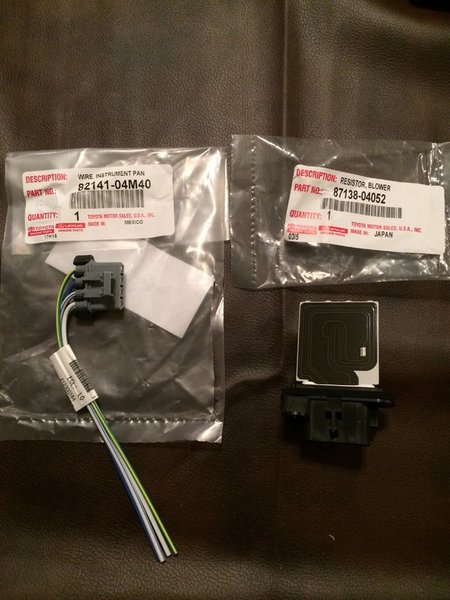

    I need to order these myself. Is there any reason you ordered the harness as well as the resistor? I would have just ordered the resistor alone otherwise...

    Reading through the millions of threads on this topic, I decided that the connector itself was probably the main problem - not the resistor. However, I was experiencing various and intermittent problems that met the criteria for both. I knew for a fact that the connector was overheating. I wasn't 100% sure if the resistor was failing, but for the relatively cheap cost, I figured I'd just do it all at once and try to take care of the problem in a single pass.
    So far its worked great!

    Last week I started getting the ticking time bomb from under the passengers side when only in high on ac...found this thread and ordered these parts ($40 delivered):

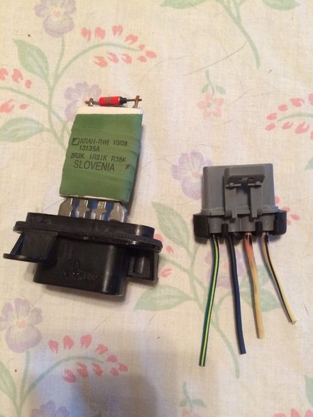

    And replaced the fried ones:
    Really? Slovenia?
    Good as new now...thanks TW
