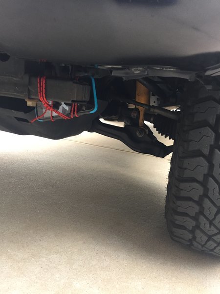

    Just like the title says. Seeking assistance diagnosing the clunk in the front drivers side of my truck. Vitals on truck: 2008 DCLB 4x4, OME 885 w/ nitro chargers (purchased pre-assembled from toytec, no top plate spacer) LR UCA, Dakars; 150k on the truck, about 50k on the aftermarket suspension.
    The clunk occurs when the suspension cycles, i.e. speed bumps, pot holes, railroad crossings. It doesn't occur ever time I drive over said obstacles, but more often than not. I've included a video of the sound. Sorry for the length of the clip. The clunk is around the 0:30 sec mark.
    So far I have already confirmed proper torque on all lower control arm bolts, lower shock mount bolts and cab mount bolts. I've also installed and/or replaced sway bar relocate brackets, sway bar bushings, sway bar end links.
    The lower and upper ball joints appear to be ok, but I cannot say for sure that aren't in need of replacement. The bellow around my drivers side inner tie rod has been seeping for a while, but I haven't noticed any steering issues so I don't think that has anything to do with the clunk.

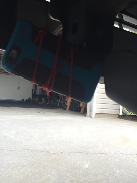

    I'll try this afternoon after work. The first video was a product of some redneck engineering to rig my phone on the frame/bumper support.

    :rofl: I though you had a go-pro tucked under there.

    I wish. Sold my GoPro about a year ago as it was just collecting dust. Wishing I hadn't sold it now.

    Start reading at post #660 of this thread. Same issue as OP. Fixed with switch from OME Nitrochargers to Bilstein 5100's. Credit to Nick @Crom.

    Hard to tell from the initial video. OP's description sounds like classic OME shock noise. I solved mint by replacing the OME with billstein 5100.

    I'll be brief since I've written a lot on this subject before.
    The OME shocks are too short.
    There is a metal weld (a stop) on the shaft that helps prevents the shock from ripping itself apart when it extends too far. That is what the noise was on my truck and sounds like your written description.
    I had the OME / 885 coils and I hated it. The shocks crippled my truck off road. The OME shocks are garbage as far as I'm concerned. The design is also a shit design. They are twin tube shocks. Put that shit on a car, not a truck.
    The 5100 shocks are almost 1.2" longer than the OME, so they allow more suspension travel. They still have a weld on the shaft, but it hasn't been an issue with the 885 coil. They Billys are also a Monotube gas shock. A far superior design.
    I've been very happy with the 5100/885 coil combo!
