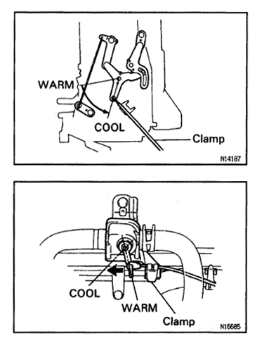

    Hard to tell what's all going on from that angle, but these are the two things that should be happening when you move your temperature slider:
    That being said, your coolant temperature at the heater core lines should be hotter than 125 still after warmed up.

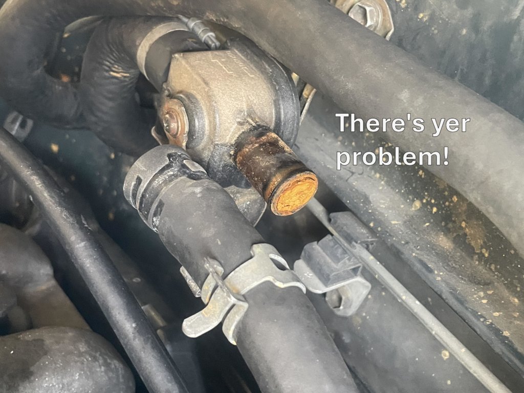

    It's a year later and the no heat issue is rearing it's frozen head once again. Here is where we are: In the past year we have replaced the radiator (old one had a hole) and thermostat and recently replaced the heater core. There is still no heat. We are convinced that there is no air bubble....squeezing all hoses (both radiator and at the heater core) results in fluid backflow, but no air bubbles. We are focused now on the actual flow of fluid to and from the heater core. Today in Alabama it is 55 degrees, we ran the Taco up to normal operating temp, can see fluid circulation at the radiator, thermostat temp is over 180, so it is open....but the inlet hose to the heater core is at 78 degrees and outlet about the same. So the question is why are not getting hot coolant flow through the heater core? As always your words of wisdom and encouragement are welcome.

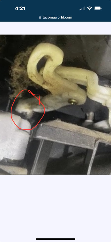

    Sorry bro
    this is my take
    From your vid
    This arm appears not to move the “warm to cool” rod as much throw as needed
    Also, after blowing vid up, said arm’s hole at the end looks “ a bit wollared out”
  15. Dec 24, 2024 at 2:28 PM
    ControlCar
    ControlCar My Moto: Help & Learn…period.
    Jul 22, 2023
    #429578
    3,124
    Steven
    Sugar Land TX
    1996 Taco 2.4L 2wd Automatic
    Clock Volt meter/LSPV Delete/Hyundai 16’s/FP gauge/after 9months of wrenching ZERO oil leaks
    Easy test is to push that affect arm in correct warm position, secure arm somehow, get up to operating temperature and see if there is a change

    So we finally solved it....we were correct in thinking that we were not getting flow through the heater core....turns out that the stop leak the original owner had added to address a radiator leak had completely clogged the inlet tube to the heater core....we flushed the core because this was a concern, then ultimately replaced the heater core....but we never checked the inlet hose to the heater core....plugged up like a big man that ate a cheese ball all on his own....thanks to all that spoke up here....great community.

    Cool beans, fixed. Occam's razor I'm definitely guilty of not practicing it. Merry Christmas stay warm my friend.

    Excellent!!!
    stop leak FTL…….again
