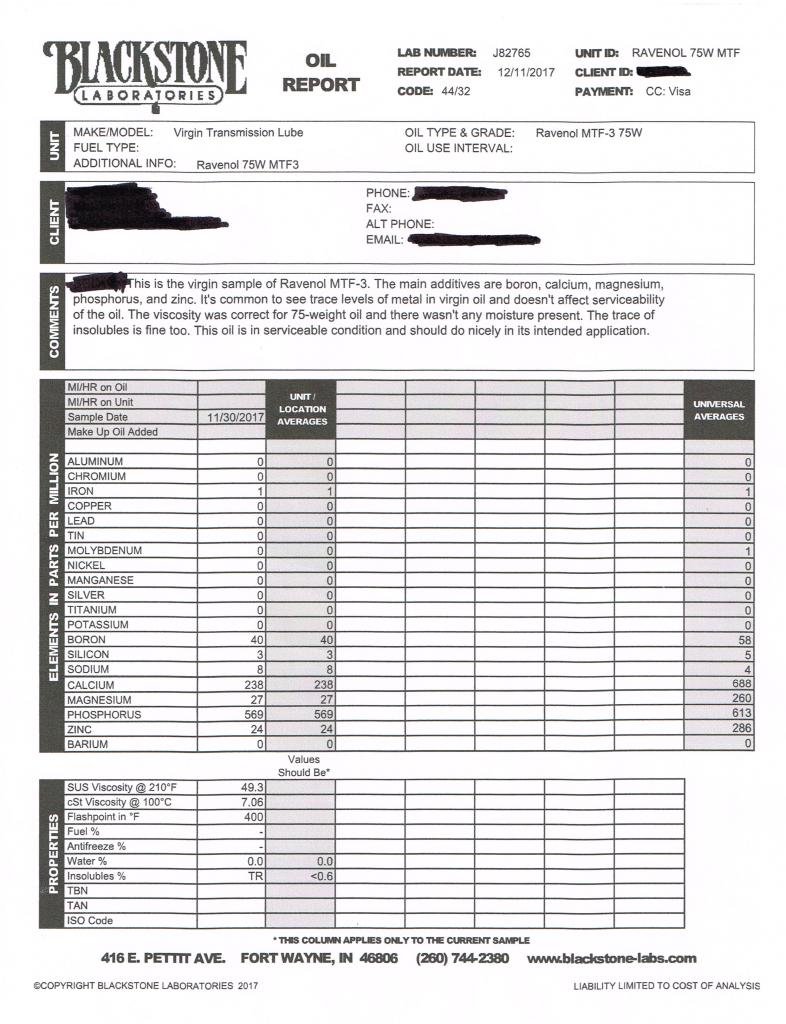

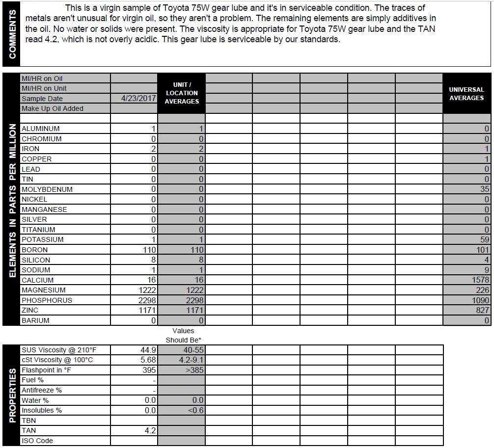

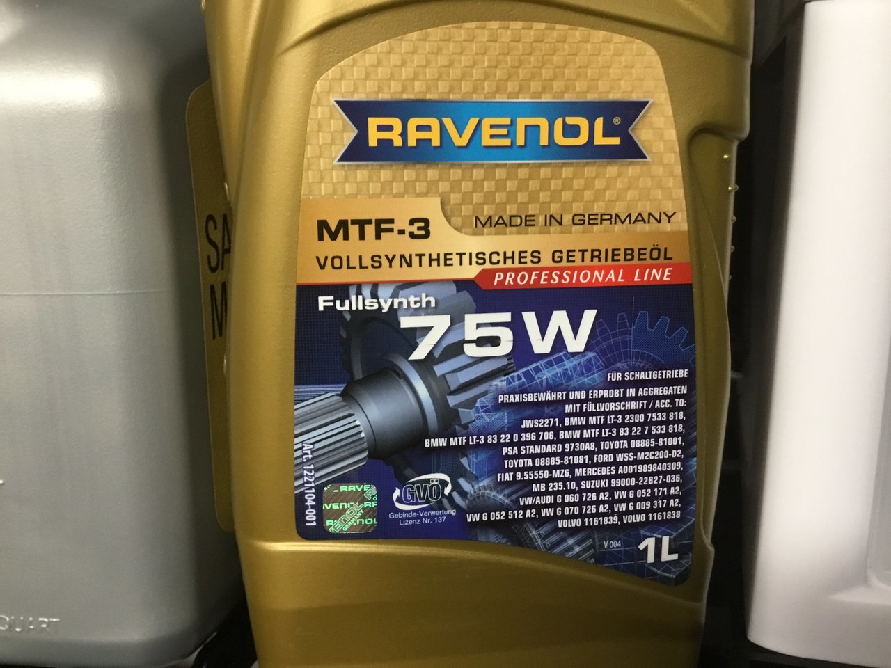

    CB087244-4F24-405F-BA46-1326C1A62B98.jpg As the report says, both oils are serviceable, but it also says that the Ravenol should do nicely in its intended application.
    As our Tacoma manuals state, “Use Toyota approved, ‘Toyota Genuine Transfer Gear oil LF’ or an equivalent of matching quality to satisfy the above specification.
    It says the same for the differential oil, engine coolant and manual transmission gear oil.

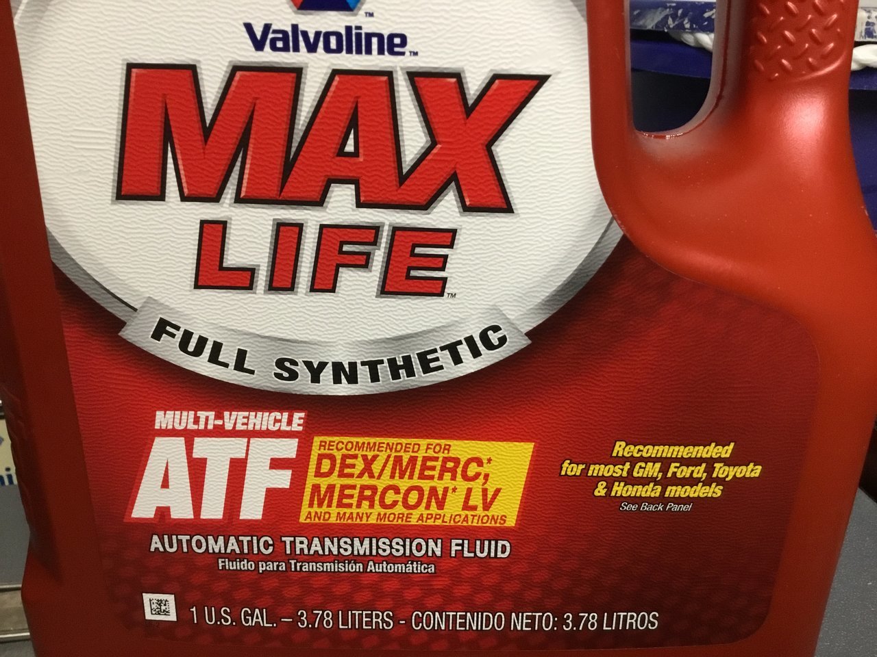

    For our transmission fluid, it says to only use “Toyota Genuine ATF WS” because using other fluid could cause deterioration in shift quality.....
    There are other fluids recommended by their respective companies that meet the Toyota ATF WS standard.
    Toyota doesn’t make their own transmission fluid, it’s manufactured by another company to meet Toyota specs. Or, a fluid meets Toyota specs and Toyota recommends it to use in our vehicle.
    The use of Dexron II or III for our power steering fluid is an example of that.
    Two different but equivalent oils from two different companies will usually have different additives. Or, one could say that those oils will never have the exact same additives. And, the different elements contained in the oils will exist in differing trace amounts.
    As many people on TW have stated, you’re covered by the “Magnuson-Moss Warranty Act” a United States federal law enacted in 1975.
    The Ravenol meets Toyota specs for 75W gear oil, just like Mobil 1 engine oil meets the specs for our Tacoma engine oil and Valvoline transmission fluid meets the specs for our Tacoma transmissions.
    The Valvoline transmission fluid is synthetic per its data sheet, containing no petroleum, and it’s just my opinion that’s it’s probably better than Toyota ATF WS.
