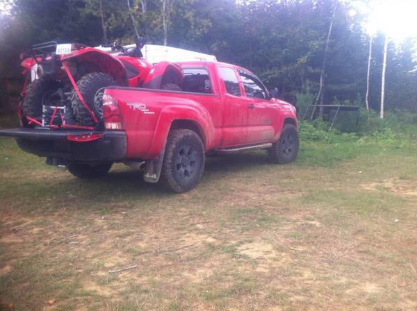

    I've been debating on lifing my truck for a while now and want to do it now. On of the reasons is when i put my four wheeler in the back it makes my truck sag too much. Theirs a local shop that said they can add a leaf in the rear and recurve my leafs to get a three inch lift and add another 700 lbs to my payload but they don't do front lifts. Ive talked to two shops now and they both told me to do blocks in the front even though I was originaly planning on doing 5100 Bilstein Shocks and Eibach front coils. One shop said the truck would drive horriable with that set up on the front and the stock leafs in the rear. Now I'm confused

    The main reason is for the bike in the back it's about 600 lbs. Then add everything thing else for a weekend extra gas, generator, beer and all the gear it's like 800lbs back there. That's too much for the stock leafs to handle. So I figured if I was going to spend the money getting a leaf added by this highly recommended shop that just does leafs then I should just pay a bit more and lift the whole truck. But I can't find any truck shops around me that do full lifts.

    Go with the Old Man Emu Dakars for the rear (Daks) I love them and have them on my truck. They don't sag very much at all. Toytec sells them for like $400. Loaded my truck down before and just squats a little compared to the stockers. There is also an extra leaf you can buy if you want to have more load capacity.
    A small block in the rear is ok but you don't want to go crazy tall. Full leaf packs are way better than a block. Axle wrap can be an issue with tall blocks, bad bad. Plus you don't get anymore load capacity from it, just lift height. Blocks also don't add flex when your offloading if you choose to do so because its still the stock spring geometry .
    If you want load carrying ability like I did for myself, look in to a nice set of aftermarket leaf packs you won't be disappointed . Be careful there ae packs for just flexing and wheeling and then there are ones that are designed to flex good and handle weight also.

    blocks with stock leaf packs will cause your leafs to go into negative arch whenever you go over a bump if you have weight in the bed; it'll be a matter of time before your leafs break/your pack becomes a wet noodle

    Probably close to 1300 fully loaded. But its not for when my truck is fully loaded. Even with just my atv which weighs 600 if I hit a any decent size bumps in the road and theirs tons around here it feels like my rear suspension is bottoming out
