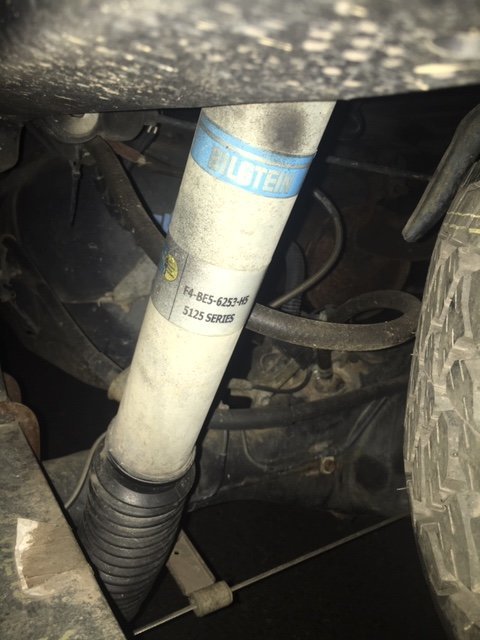

    I am sorry to ask another lift question..but here goes. I have an 04 DC and I am in the process of replacing the suspension all around. The suspension parts I have are all fairly old (10yrs) with 120k+ miles. Up front I have an OME setup with ¼ top plate. I have already ordered the replacement assembly from Wheelers and it will be here next week.
    Over the winter I replaced my leaf springs with Dakars (no AAL.. yet) and I am still running the Bilistien 5125s in the rear (going to replace).
    I am ready to order the rear suspension and plan to add the OME AAL to help with the weight in the rear. With help from another TW buddy, I will hopefully put these on by the end of the summer. My questions are regarding the rear shocks:
    1. The Bilsteins in the rear are f4-be5-6253-h5 5125 series (see pic). Neither Wheelers or Toytec show these as options in their kits. They have Bilstieins but not with the number above and Toytec has two options. I was happy with the performance of these (there still there) and I can find them on Amazon. Has the number changed? Which ones should I order if I go with Bilistien?
    2. I was also thinking about trying the . I know OME is designed to work with OME but wanted to see if anyone had experience with both and will they work with the Dakar and AAL?
    3. Last question. Do I need a longer leaf spring center pin when adding the AAL or will the one that came with the Dakars work?

    Bilstein 5100's are just overall popular amongst all vehicle models, so naturally, they're the most often chosen shock for "kits"
    A 5125, 6125, etc. are an 'upgrade' from there.
    With all that weight, I'd vote you go with a custom leaf pack.
    And I don't know about you, but with even less weight than what you're carrying, I found Bilstein 5100's to be way too soft in the rear paired with my OME Dakar leaf pack.
    I run Fox 2.0 universal in the rear and with the bed loaded, they're amazing over washboards and off road in general.

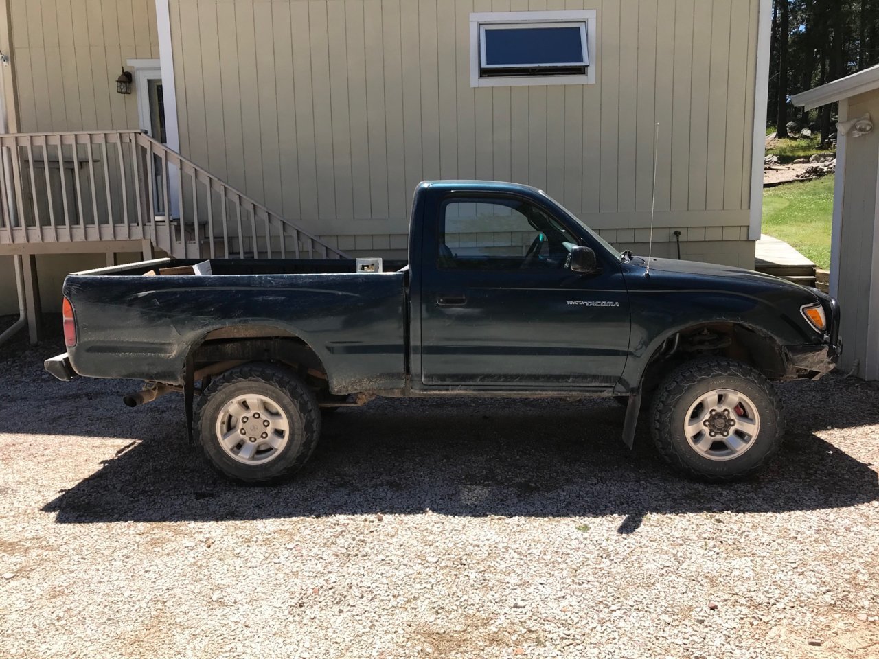

    Have the OME suspension kit with the Dakars, Like Madjik_man the truck is a daily driver and I have a 31 Mi commute one way and a 3rd of it is dirt road. That being said after the install the ride was really stiff plus it gave the truck a 70's muscle car rake with the rear end way higher than I wanted it to be. Even after installation of really heavy front and rear aftermarket bumpers it still rode stiff, so I removed the 3rd spring from the rear pack and it brought the rear down almost level with the front and the ride has since been way nicer, even with a load in the back (550 Lb motorcycle) the sag is very minimal. Eventually will go with the Bilstein 5125's when a replacement is warranted but for now the OME's are working out great.
    Truck with 3rd leaf removed.......

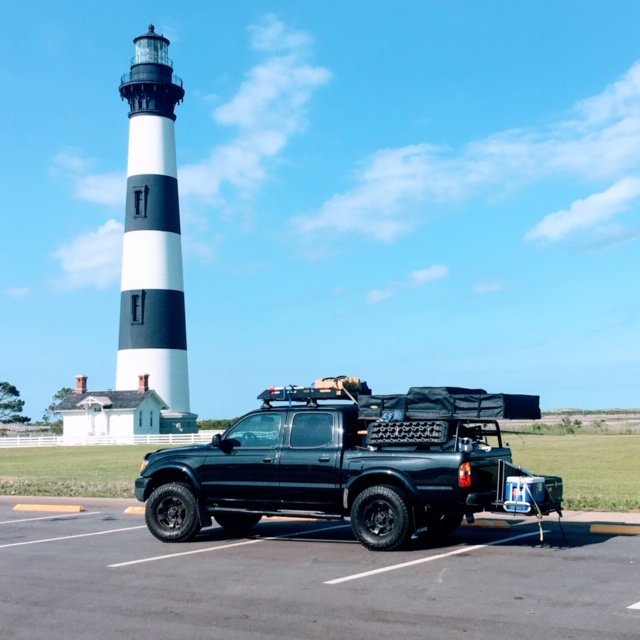

    5100s and OME 885 coils front, 5100s and AAL for the TSB leaf pack (overload left in) rear. Jeraco camper shell.
    Nicely done on this and your earlier assessment of the Bilsteins. I have the 5100's and would agree. The reasons stated went into my decision to purchase the set. Inexpensive, good on road where my truck mostly lives, and acceptable offroad performance. My truck does get offroad almost every day on rough and muddy construction roads and the 5100's are just fine.
    I will say the "bucking" on whoops can be jarring, but I can live with it since I only drive dunes a couple times a year.

    Definitely stick with the 5125s I can get you the part number I have. The bushings are smaller and need to be drilled out or replaced. Also the lower shock mount needs to be replaced to get that extra shock travel.
    I just ran through a full gas tank of 4 low with new 5125s and it was really really pleasant. It was a mix of very difficult rock sections and fire roads. Zero complaints .
    One thing to note with 5100 fronts is the noise they make when they compress fast. It makes a noticable hissing sound. But only on hard hits or big drops, it sounded like I lost a bead the first time I heard it. But everything is fine. I'll have it on the lift tomorrow just to give everything a check up.
