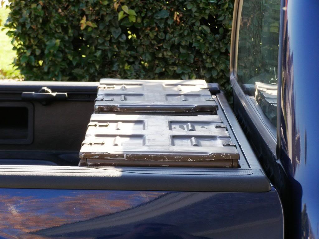

    I made my own tool boxes from ammo cans, there are two and I can mount them in different ways with the rails. I mounted them with bolts and wing nuts in the rails, they lock, now, so to remove them would require unlocking them. However they can be removed in a matter of minutes and still have handles to carry them or to tie them down if need be when removed.
    These photos were taken when I test fitted them. Now they have locks and are water tight (even high pressure sprayer proof) and I'll eventually paint them, though the redneck/trailer trash look makes them less tempting to prying eyes. The space between has come in handy for long objects that needed extra space.sideview_144974c6e3c5b6e9db47785f13269a51b7c71f39.jpgopenlid_3a850884017f1fa707355df832cecae549d2df0c.jpgboxes_5aa03b8a8fac8a08cf54eec658190533cc75135a.jpg

    I love this idea and I hope you take it as a complement that I completely want to copy it. I'm as cheap as is possible, and also love buying military surplus, this is absolutely perfect! Can you please tell me what the dimensions of the ammo boxes are (approx)? I can't wait to go to my local surplus store to haggle!

    Yeah this is pretty bad ass actually, and It seems like its an easy installation with only 4 holes needed to be drilled through each of the ammo cans
