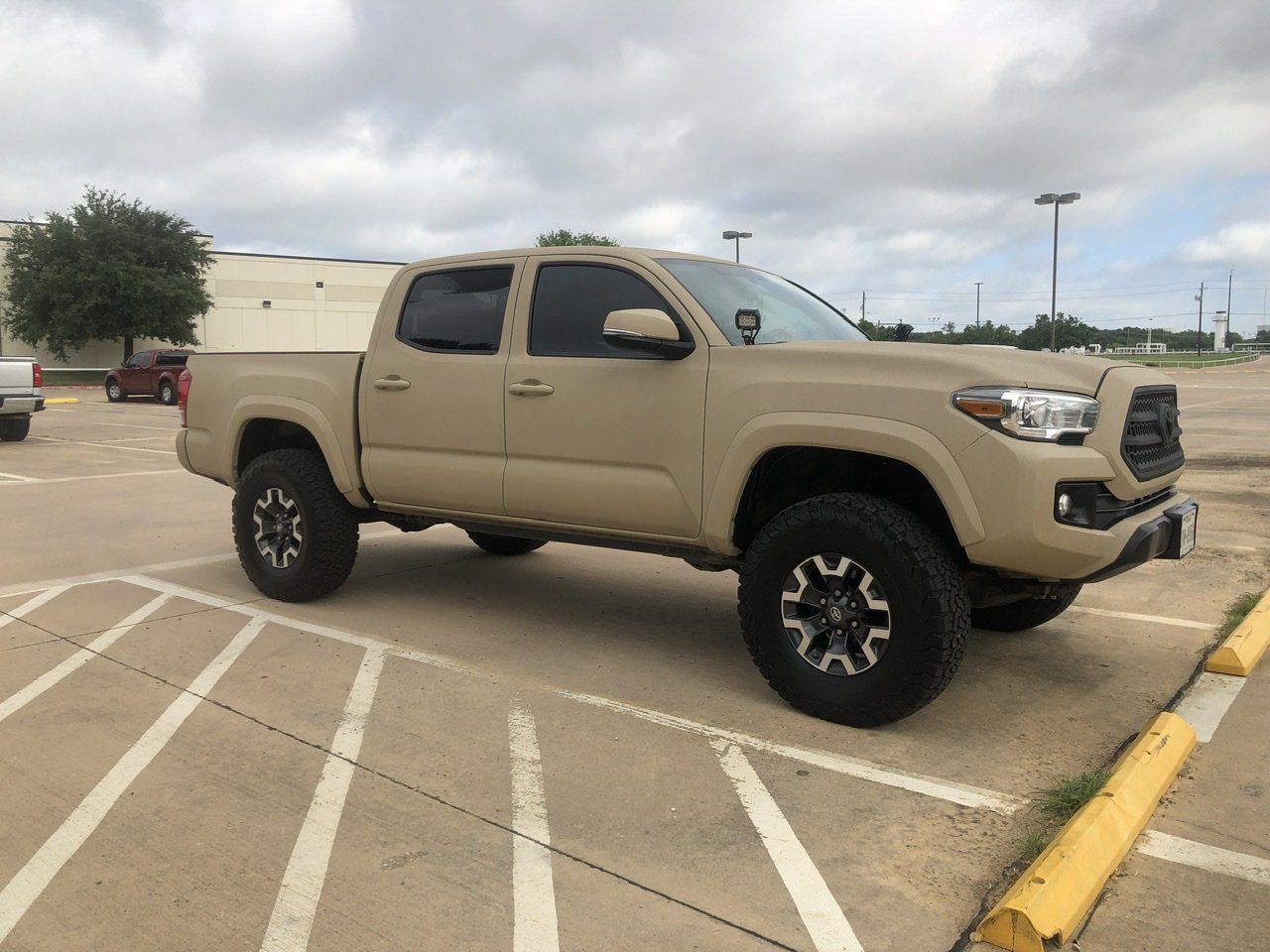

    Want to keep about same height as this. But I’ll remove the front spacer. I’ll keep read block if I do fox but aal if I do toytec
