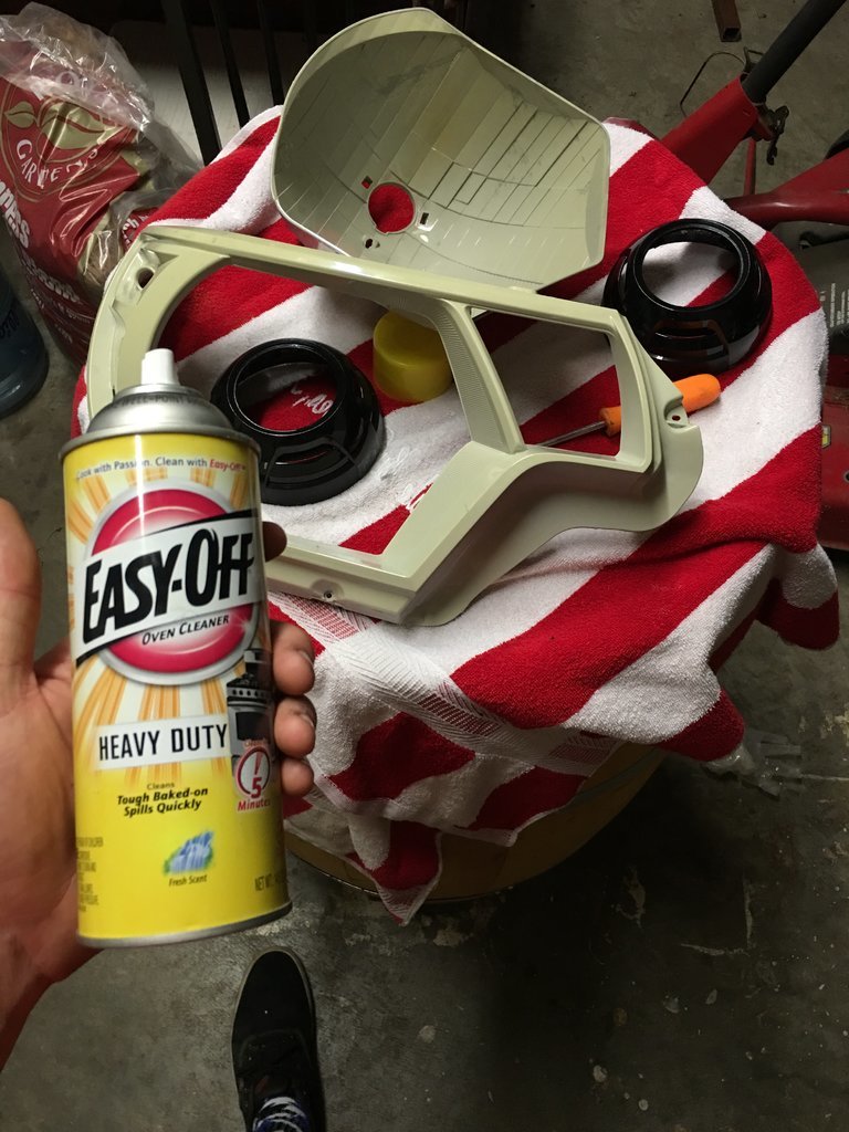

    Walk-throughs on splitting these is beating a dead horse IMO. So we're omitting that.
    These are the headlight guts, stripped of their chrome with easy off from walmart. Good luck finding it, but it is there. One can seems to be plenty but I bought two just in case.. (can't hide money):hattip:
    It took the shrouds about 30 seconds and the headlights about 3 minutes. Regardless of what other forums say this stuff works like a dream. Rinse with the ol garden hose and repeat as needed

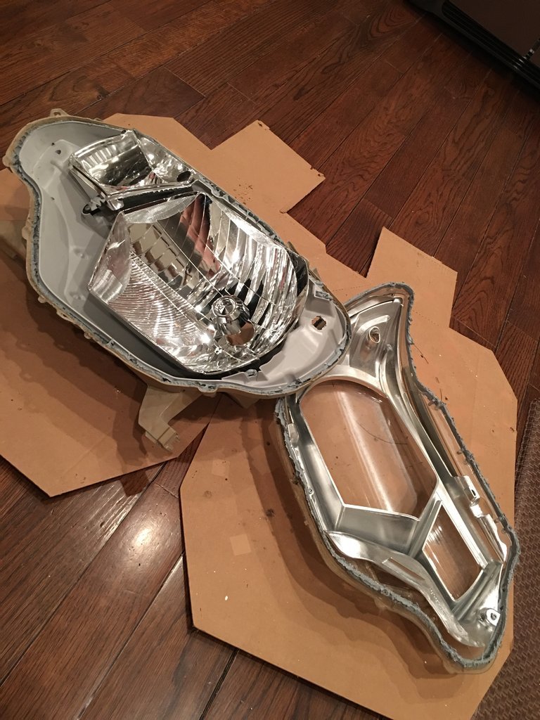

    Ahh.. no respectable write up leaves out key details. Thoroughly inspect and make sure you have removed ALL OF THE SCREWS. Set your oven to 225F and go for five minutes. I can guarantee they won't split, but you wanna heat them not cook them. Keep checking. Start pulling from the corner where the reflector is BY HAND. If you take screwdriver to your OE heads (the only lights you should do this to btw) and crack them.. make sure to post it here so we can lol at you. They should slowly start to come apart. Make sure to release the one way clips around the sides. This is my first build so I wanted to be frantic due to nervousness. Don't. Chill. They don't cool down for a while. Do not rush and break anything. If you live with a woman that cooks, wait til she goes to bed and simply play dumb when she wakes up and finds her oven smelling like shit and chemicals. :fingerscrossed:

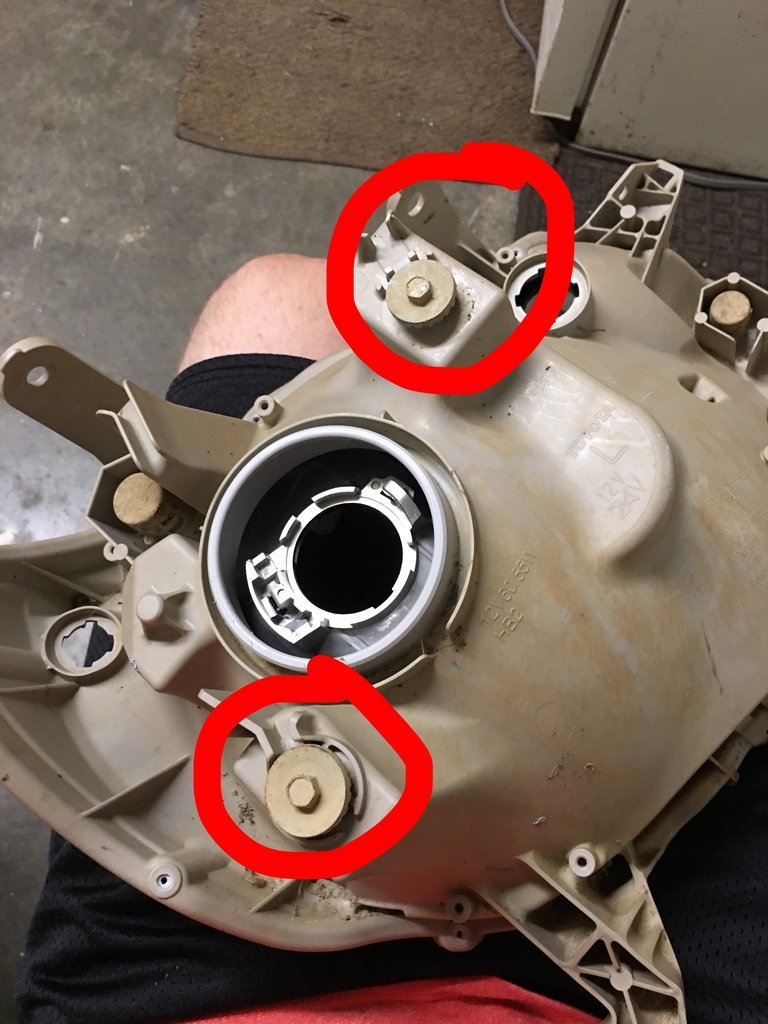

    Pulling the reflector is easy. Push the lip of the two clips over the ledge, and out.
    The running lights are just two Phillips screws. No bs there. The main dome for the light does have to come out for this to be done. Period. But, it's easy too. Get a drink and get comfortable, and loosen (counter clockwise, standard thread) the two bolts circled in red with an 8mm socket screwdriver for the next 30 minutes. Do not a grab a drill because we don't use power tools on delicate plastic. Once you have freed the dome from those two bolts, there is a ball joint that holds the dome in. Get your strong hand ready and pull until it comes out. With some control, ya animal. If that does not come out, you might have to get a fine bent pick and try to depress the tabs in there. If successful, the light dome comes right out. Shout out to SO Motorsports on YouTube and on here for that tip.

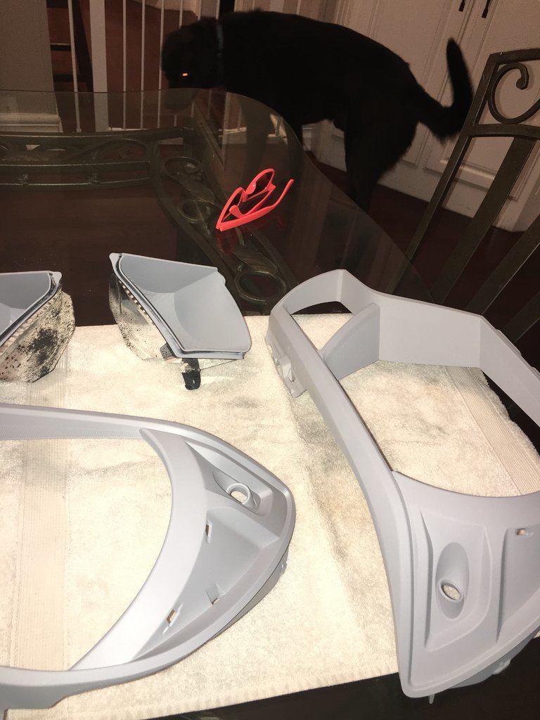

    Everything is primed up. I'm not a painter so take this with a grain of salt. Or the whole shaker. Whatever.
    After everything is stripped, don't rush. Let it air dry. Take a scuffing pad (equivalent to 15-1600 grit) and scuff everything. Use rubbing alcohol and wipe everything down. USE COMPRESSED AIR AFTER THAT. whatever rag you wipe it with will leave lint, there will be dust from sanding no matter what. That's the most important part. Make sure it's dry and shoot with primer. I brought my stuff inside. It's humid. If you didn't get in trouble for baking lights in the oven, try painting inside. Clearly your wife/mom is cool. Life is about growth. Let us know what happens.
    EDIT: scroll on down to where I grind the tabs off the back of the headlight dome. DO THAT BEFORE PAINT. I did not and it's a real pain to get the dust out off of the paint. Not a huge deal but clean up is a lot easier when not trying to protect the precious rattle can paint
