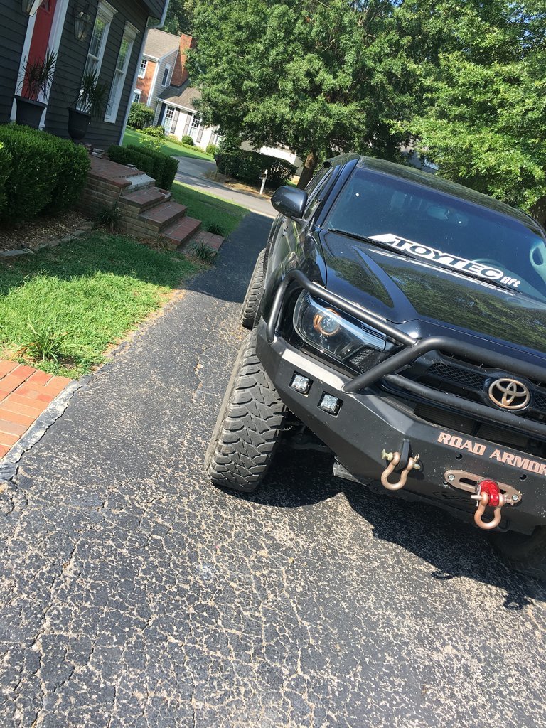

    Got a pic of what they look like? I mean how much do you really care about the cut offs being perfect?

    Looks decent but I'd rather take them out and shoot them with a 12 gauge than to know I did shit work, plus have ineffective lighting. Truck is so dirty from work nothing looks 'good' right now.
