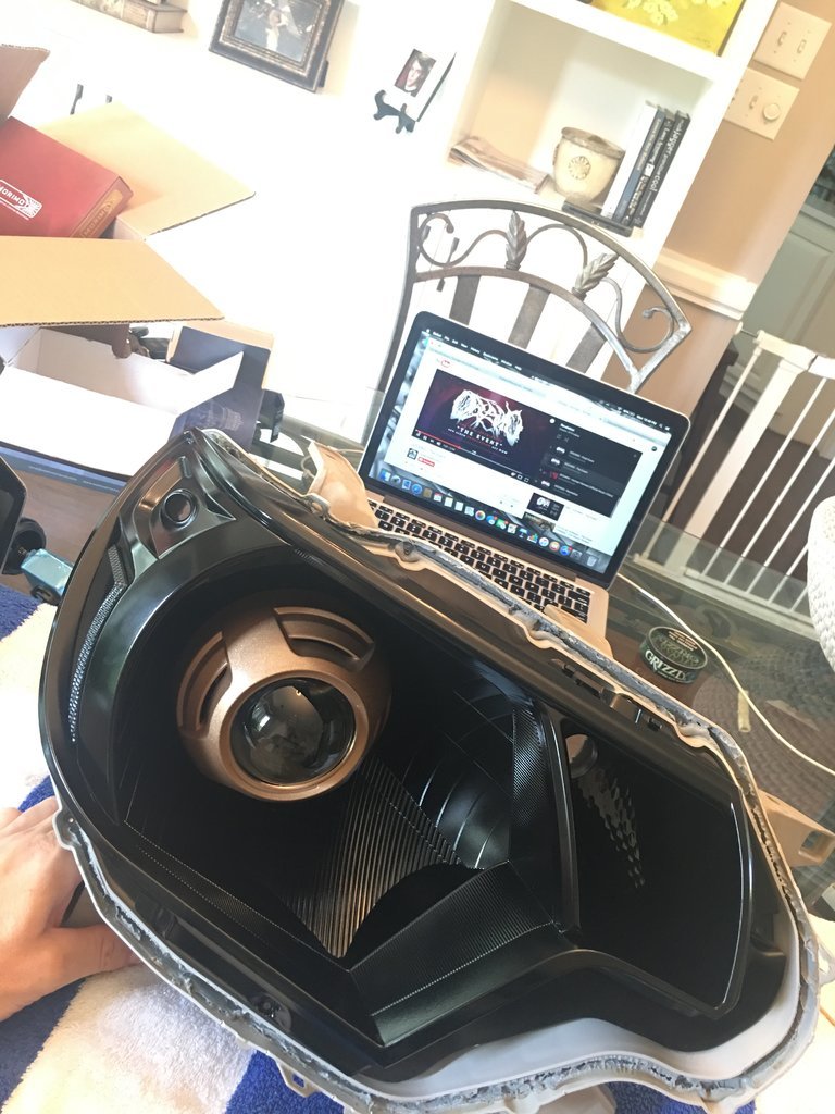

    Yeah I don't have enough left to even finish one light. Can it be done without splitting them again? I think not because I have to do more grinding i guess

    Unfortunately not. Gotta grind it down. Send them to me lol

    Can you produce pics of any kind of this said alignment?
    Would like to know what I'm needing to do. Obviously the back of the headlight is getting ground completely flat now too right?

    Yes then line the projector level with the vertical lines on reflector bowl and then mount it back on housing and install on truck without lense. Then do your minor tweaking to get straight cutoffs

    Yeah man that's where I muffed this up so bad. Gonna redo everything with lenses off. Sigh. Few more days I guess :crapstorm::D

    Shit man I would have said something a few pages ago (when I said to cut all the clips off and sand the back smooth) if I thought you were still using the factory H4 bulb socket for alignment. It's known to not be properly aligned for a retrofit. Don't get too discouraged though man, after I had mine on the truck for like 2 months I had to pull them apart and reseal them again. Pain in the ass for sure.

    Okay new butyl is in the mail but while that ships I'll go over the rest

    To come to terms with getting shit on like that but I'm good to go again. That being said, I believe I've hit just about every pothole on this road so anyone that reads this has no excuse. Lastnight I sealed the lights back up without putting the two screws thst hold in the main shroud:playball::wave::rofl:
