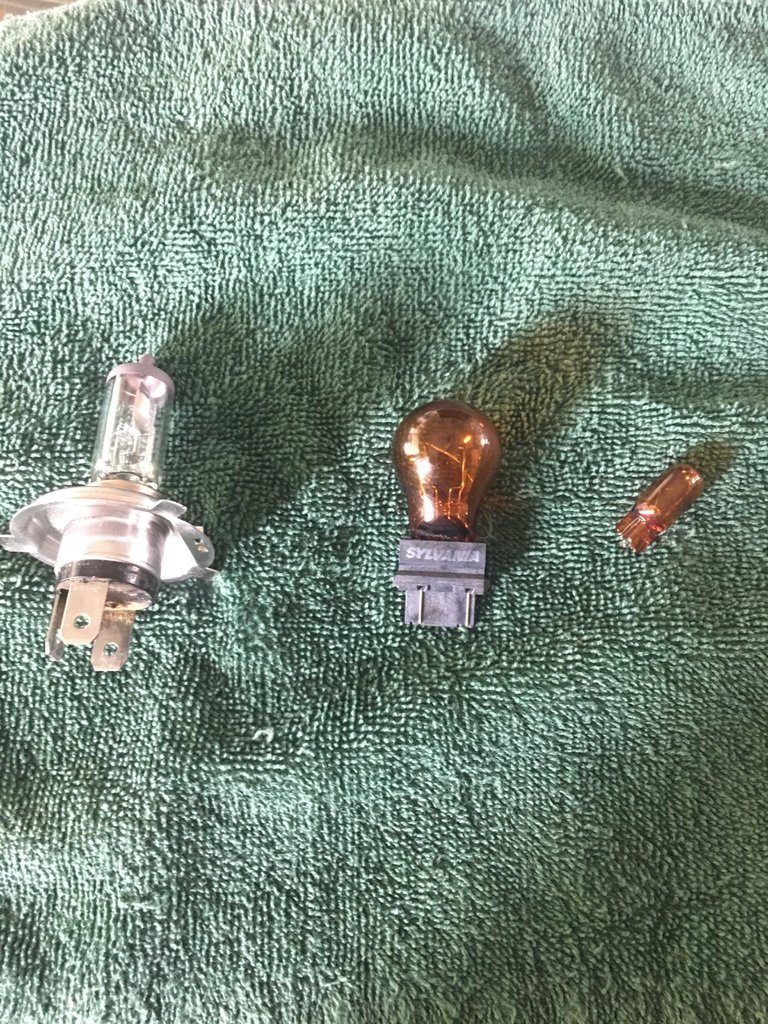

    OEM bulb sizes and information, from left to right.
    Headlight: 'HB2' size
    Running lights: '4157NA' size
    Side marker mini bulb: '194' size

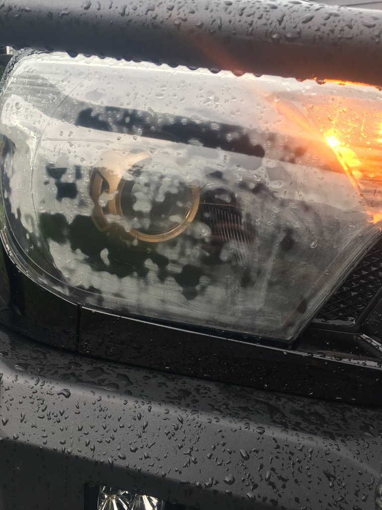

    Shit man. That's pretty much what mine looked like, but after about a month or 2. After I took them off the truck to reseal them I could literally pour the water out.

    Did you clean the inside of the headlights with anything? Looks like I see some weird lines in the condensation. When I did mine, I didn't touch the inside at all because I read something saying it's best not to. I did mine about a year ago and from what I remember, I've only had a condensation issue a couple times, and one of them was a couple weeks ago after a heavy rain.

    Looks like you didn't seal them yet? If so, then shouldn't be a problem to crack them back open. If you did seal...I would clean and reseal like others have said.

    Man... I did. I actually hit them with a little polishing compound. I need to find out what to wash them with after I unseal them. Then I am going to blow them out, and set them in the sun as to not get any water spots or streaks and be done messing in water I can't swim in :fingerscrossed:

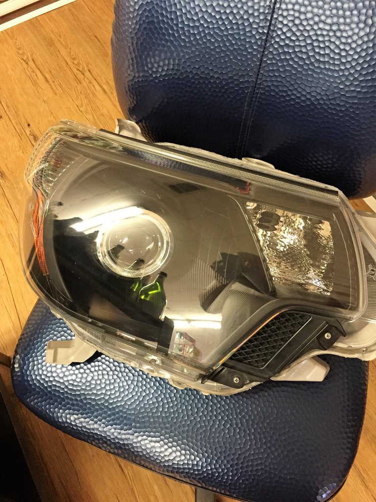

    I'm back on the grind right now guys. Gonna pull them apart, set the cutoff, and seal everything back up. Got some ideas with some clamps(lightly) and we'll see where it goes!!

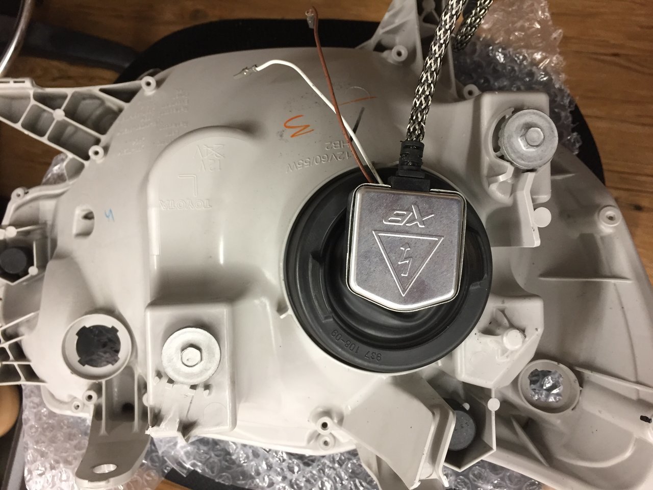

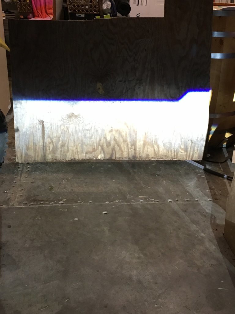

    Got the cutoff straight. There is no way to use the indexing plate without some creativity on your end guys. I will not be using it. I am going to put a few dabs of JB weld on the back on the lock nut and the threads and call it a day.

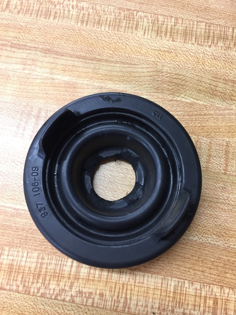

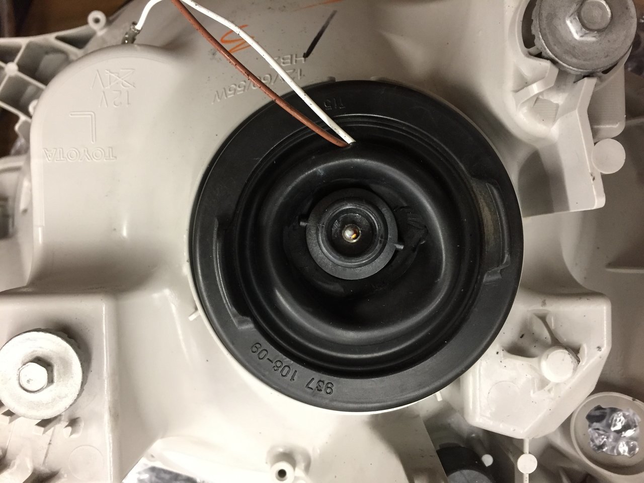

    here's what I did I trim the rubber boot so the adaptor could fit seal tight. also used Butyl Tape to reseal the headlight and to add a safety precaution add a bead of silicon around the headlight. hope that's helpful good luck.
