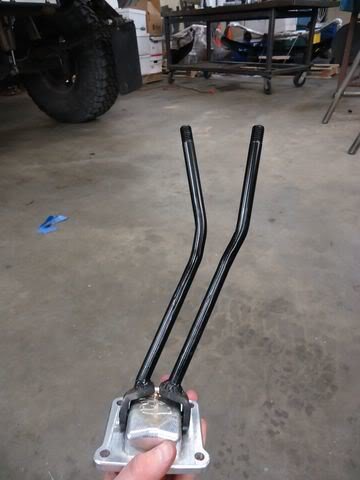

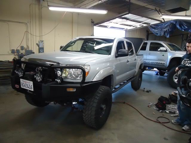

    Another RST FJ Case and Marlin Crawler into an 07 Tacoma We did another FJ Cruiser t case swap and conversion to twin stick and a Marlin Crawler Ultimate Taco Box install on Saturday on an 07 IFS Tacoma. Did all the wiring mods so that his add would work and his dash lights would work. Only thing left to do are a couple of detail things and he's good to go.

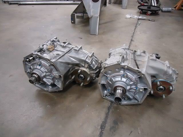

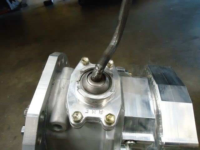

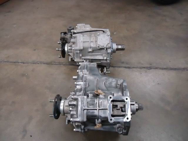

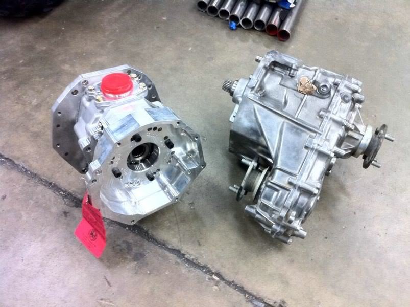

    The marlin Crawler Ultimate Taco Box with 4.7:1 gears and the RockSolidtoys FJ Cruiser twin stick T Case before they went into Josh's Tacoma.
    Here is the FJ Case compaired to the Tacoma Case.

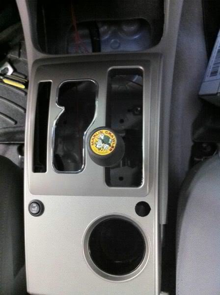

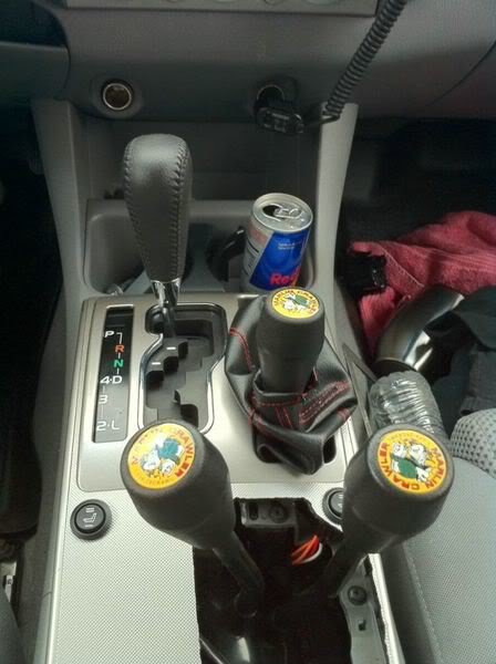

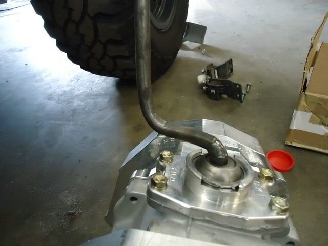

    And then here are the shifters. The first is for the Crawl box and the twin sticks are fro the FJ Case.
    Crawler box shifter and it's position in the truck.
    RockSolidToys FJ T case with Marlin Crawler twin sticks and the position of the case in the truck.
    We'll get more pictures up soon of what it looks like under the truck in an IFS Tacoma.

    Actually that's a good price. The price was around $350 but now I'm finding them at around $450. But I press for the lower price as I know they are becoming more plentiful.
    Not only do I do the twin stick mod I make sure that evrything in the case is good and I put new flange seals in it and I make sure the oil pump and screen are good to go as well along with the planetary gear sets.
    I want these things to be better than what you had in your truck to begin with.
