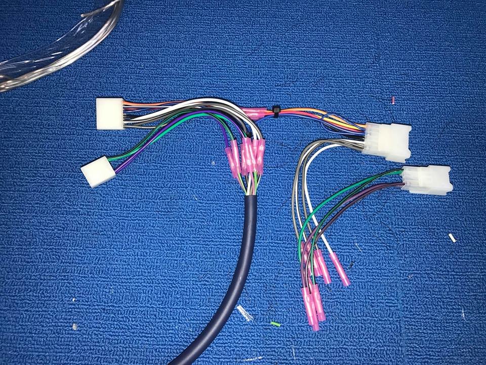

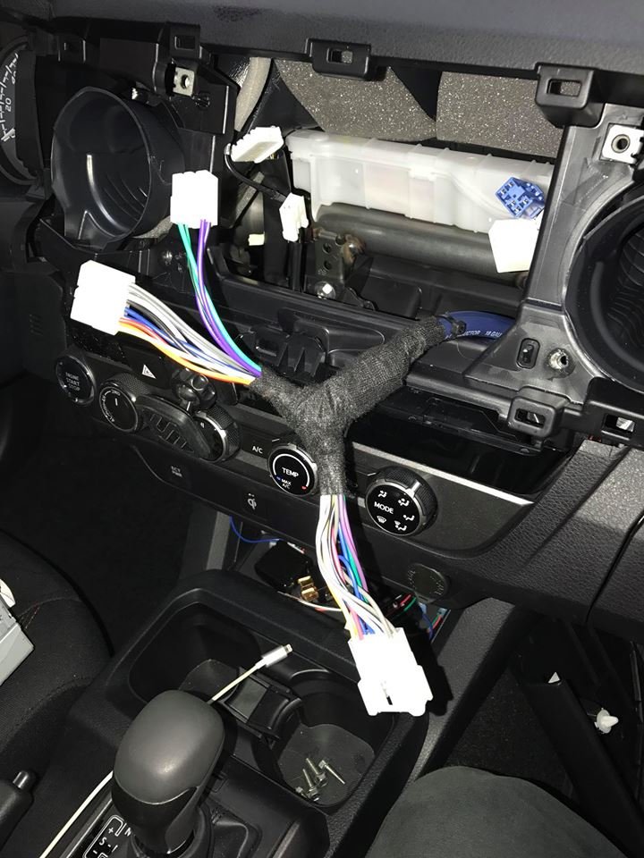

    You'll also probably want 2 packs of the 72-8104 speaker harnesses, just so you don't have to cut off the factory harness.
    Then I'd suggest 2 rolls of speedwire (9 wire multiconductor cable, offered by all major brands. Metra, stinger, install bay, etc)
    This will let you get the audio signal from the radio to the amp, then from the amp back to the dash into the factory wiring.
    Along with this will be the Metra 70-1761 and 71-1761 harnesses. These will allow you to make a plug/play harness to avoid cutting/splicing behind the radio.
    30123844_10160257180185646_8509104933953_bb277454bb734ddbd871793f50583cab77a9d8b6.jpg
    29790766_10160257180170646_3535425386470_e44cb30682d1f989597dcbdcc5445febacf5c0a8.jpg
    Unplug 2 connections, plug in your t-harness you created, re-install radio!
