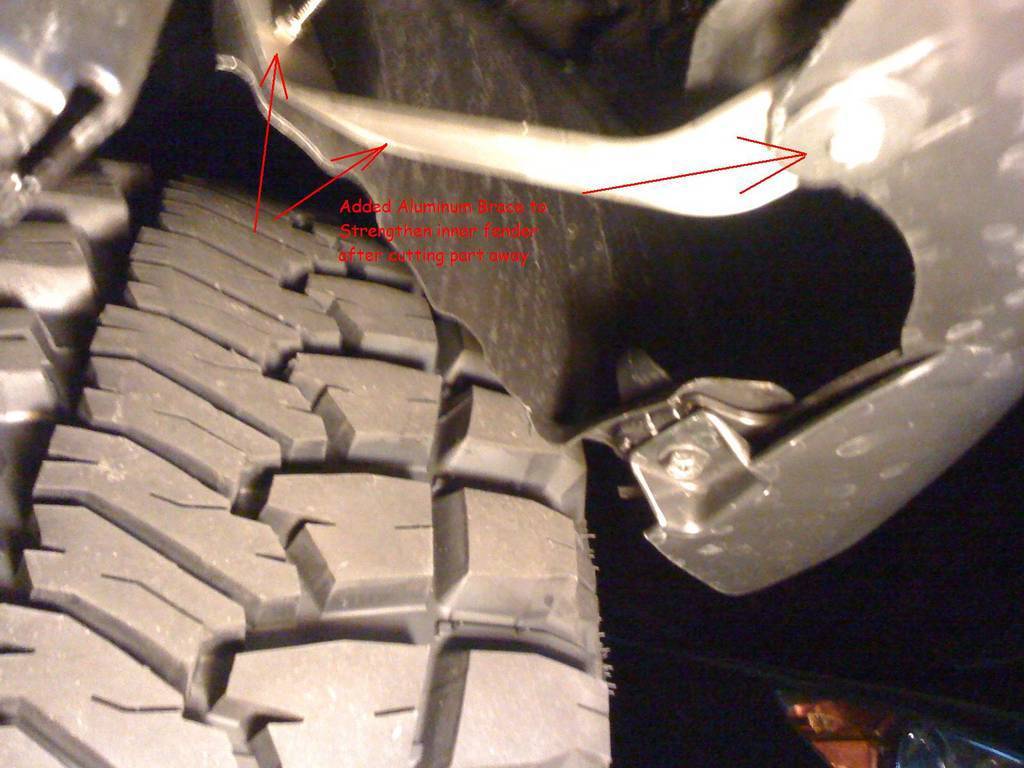

    Yeah the heat gun worked out well. But I still ended up trimming plastic.
    Here's what I cut from the front. I think you'll recognize these bumps.
    And a simple bracket I fabbed up to reinforce the plastic after I cut it, and also pull it forward out of the way.
    All the plastic on the ground in this picture was trimmed away from the new bushwacker fender flares to create additional clearance in the front.
    Never took any pics of the heatgun work, sorry.
