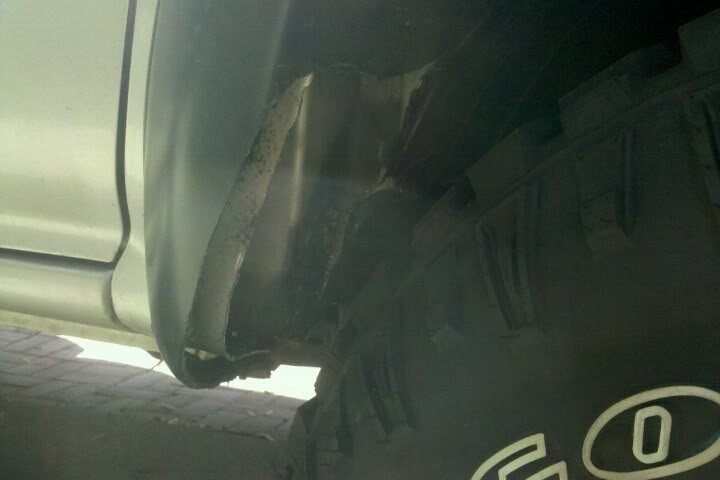

    haha let us know how that works out. they will have to do more than trim a little off the pinch weld.
    well since your not wheeling at all i may be wrong. but idk

    :cool:
    33x12.5x15s
