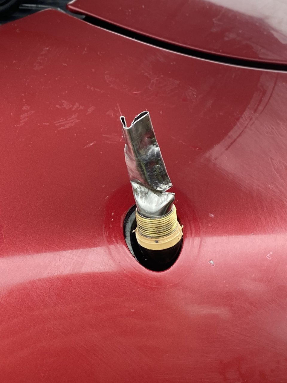

    I am struggling to remove the mast. I got the little chrome bolt like thing unscrewed which I have read a lot of people struggle with. I was able to get that off, aswell as the black plastic piece. I’m struggling to get the antenna out of the holder thing. Is there a possibility that mine is all one piece and I have to replace the whole assembly? Or am I missing a step…

    Got pretty upset over it and it now looks pretty mangled. I’ve given up on it for the time being so it’s just sitting with some electrical tape covering it but this is how it currently sits…

    Looks like you have the power antenna optioned on your truck. Not sure if you got it figured out but i just figured it out on my 95 tacoma sr5 so i figured id share for you or anyone else with the problem. I was able to get my power antenna mast out by taking the electric motor off of the tube that holds the antenna mast and pushing it down through the bottom of the tube with the motor removed. Tube comes apart from motor with 1 screw and you can use a drill bit and a long screwdriver to push it through where the motor was attached. Looks like you bent yours up quite a bit so you may be better off cutting the extremely deformed stuff rather than making it round to push back down through. Its only a pain in the ass because you have to remove the passenger fender liner to get to it and anyone who has removed those stupid square fender clips knows the pain. If you plan ahead you can just order a bag of new clips so you dont have to be so careful removing them with a pick.
    Installing the new power antenna mast for me was the opposite of removing the old one. got it from Amazon for $36 heres the link. Insert new antenna in from bottom of tube with ignition on, turn off ignition and feed the geared cable into the motor and sandwich the tube and motor back together making sure to include the plastic stopper that the gear cable goes through to prevent the antenna getting sucked too far down. 1 screw on the tube to re secure the motor. Its a little tricky but at this point youre on the home stretch. Now just put the assembly back into the truck and the top nut. BOOM.
    Quick note, while you have the motor off take it apart and make sure there isnt any left over geared cable from the last mast.
    Obviously if you cant hear your electric motor running when you turn on an off the truck you can swap the entire unit out for a non powered variant found on the other tacomas or a universal power antenna but that involves fishing the cable through the dash which isnt so bad.
    I kinda find it crazy that you cant insert and remove the OEM power antenna through the top but in my case both the old and new power antenna mast needed to be inserted and removed from the bottom of the tube as if theres a stopper that doesnt allow it to come out the top. Anyways hope this helps you or anyone else who reads this.
