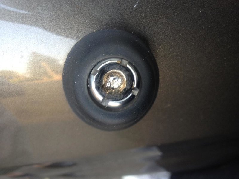

    Where can I get an antenna wrench or what can I use for it? I have a 2010 Tacoma.

    If its too tight to remove by hand, you can remove it with a crescent, a pair of pliers or appropriately sized open end wrench. When you reinstall it I would recommend just tightening by hand for easy removal if you need to go through a touch car wash or something... there's no need to torque it with a wrench. I've seen a few threads where users have reported the threads rusting and seizing in the antenna base, hopefully that isn't the case!

    Mine is broken down inside

    I have this but it’s to big!

    Thats a bummer. Do you have any piece of flat metal laying around that you can lay accross two of the slots to turn it? Metal ruler, hack saw blade, T-bevel, Washer, etc?

    Why don’t you drill it out. Take a bit small than the broken antenna stud and then drill down about 1/4 “ os so. Then you can use an extractor to back it out. I couldn’t find my extractor set and actually used a small square drive bit that I wedged into the hole. Come out with hardly any effort.

    This. The antenna isn't torqued down very hard so it should come out with an easy out just fine.

    Sorry I feel silly, I thought you where simply asking how to remove the antenna... lol. At work I use these to drill out stuck or broken off screw shanks etc...
    https://store.snapon.com/MultiSpline-Extractors-1-8-Multispline-Extractor-P635483.aspx
    Should work just fine for the antenna shank too. I use a #30 drill bit with it for a snugger fit and sometimes tap it in with a hammer for extra bite... but this isn't necessary. Good luck.

    Get a set of left hand drill bits from Harbor Freight, they're under 9 bucks. Start with the smallest one and and get a small hole started, then move up to the next size... should spin right out. A little PB Blaster never hurts either.

    For whatever reason as I was backing out my piece that was sheared off, it stripped the threads. Does anyone know the component that contains the thread piece the antenna screws into or a solid suggestion for the entire assembly for me to install by chance? Any help would be greatly appreciated. Thanks in Advance.

    Found my antenna a little loose a few days ago. An open-end 8mm did the trick. Nothing special.
