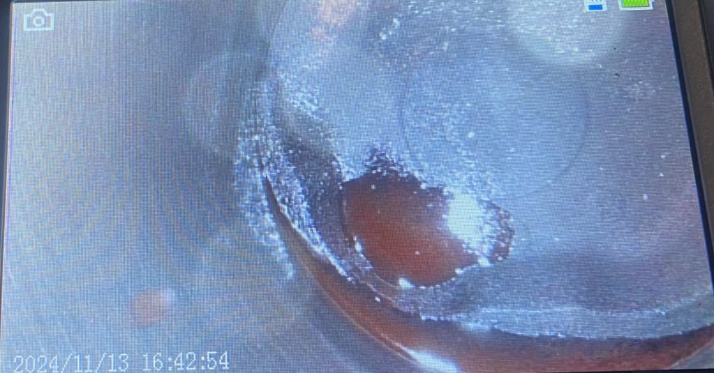

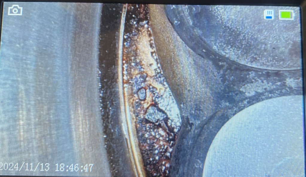

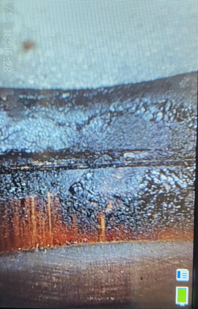

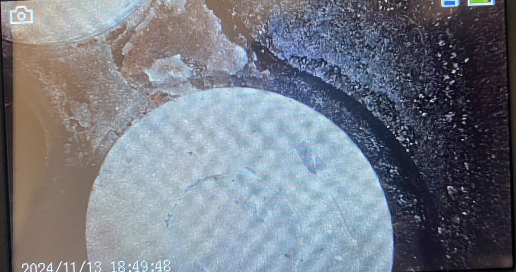

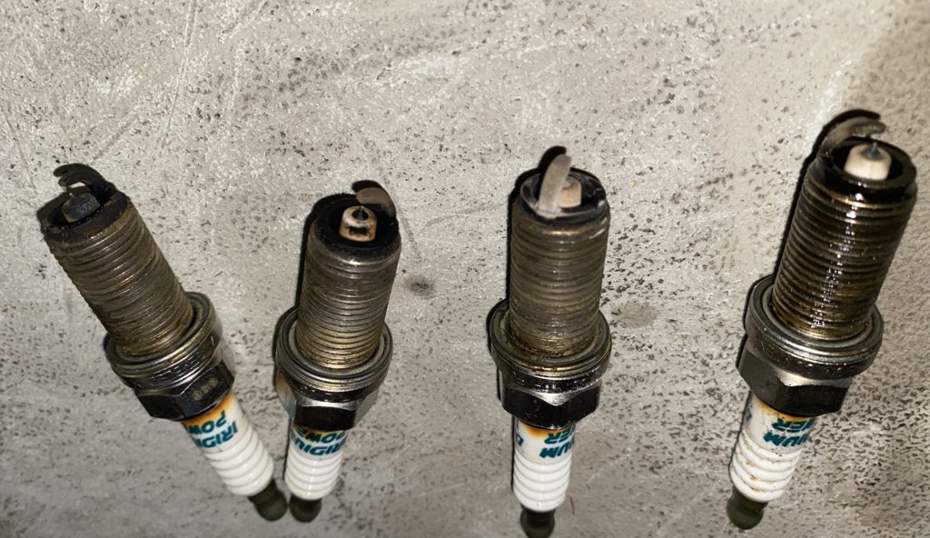

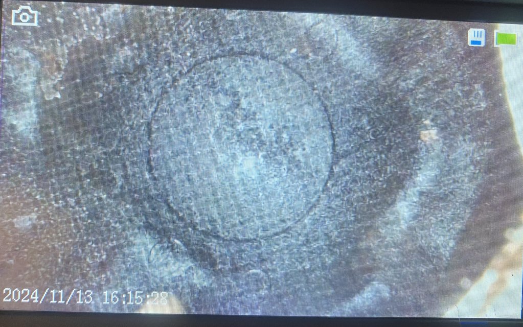

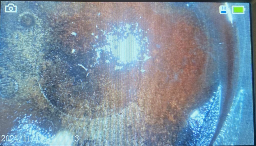

    And... the results are in.
    P302 is the only code it threw (tripped the code last Wednesday, the last day it drove).
    Compression test and visual inspection were a little abnormal at least when thinking they'd be similar to this quick diag from SMA:
    https://www.youtube.com/watch?v=CiwyPgrlbEM
    Compression Test:
    Cyl 1: 97
    Cyl 2: 80
    Cyl 3: 37
    Cyl 4: 107 (oil in the cyl)
    Cyl 1 showed coolant leaking in with cooling system under pressure
    Cyl 2 had a giant puddle of coolant just sitting there already and didn't show any leakage like #1 during the coolant pressure test
    Cyl 3 looked steam cleaned maybe, but had no sign of coolant dripping or pooling etc. during the coolant pressure test
    Cyl 4 had a fat puddle of oil that came in when I removed the spark plug (theres a hose from the secondary air filter that seems to leak no matter what - I even replaced the hose with a new OEM so I'm guessing there's too much pressure in there from something? I think I also saw some vertical scoring on the walls of the cylinder - will have a clearer image with head off.

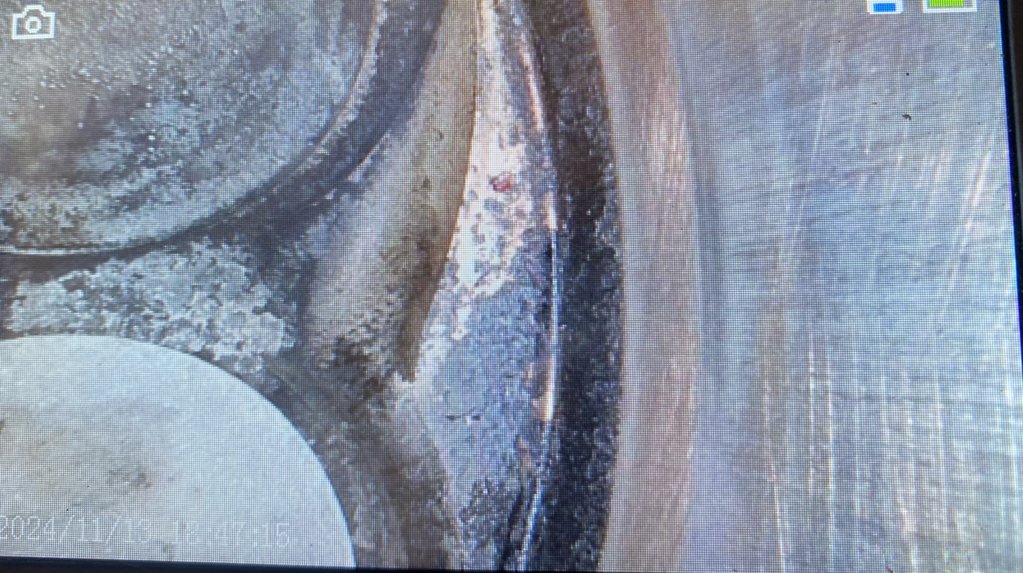

    Spark plugs in order 1-4. When I removed them I at first thought Cyl 3 would have the leak (that's what SMA's results looked like on the leaky cylinder). But it turns out it was the one with the super low compression (and no coolant pool?).
    I took more pics of the top of Cyl 3 the low contributing cyl.
    Not sure if that last one indicates a crack between the valves - the camera (and camera operater) wasn't the best.
    At this point I'm thinking of tearing off the block tomorrow and taking it to be cleaned / pressure checked / lightly surfaced (or decked .010 to add a .030 head gasket ala @BassAckwards here:

    Cyls look fine to me, that scoring at the top occurs at what some call the ring ridge, the space above the first compression ring. It's just carbon buildup and if a little chunk of it gets scored or whatever it isn't a problem. Oil probably came from a bad spark plug tube seal when you pulled the plug out, I wouldn't worry about that unless you scope the intake and exhaust runners and find it there too. I'd have that head cleaned and tested (decked), check the block with a known good straight edge for warp using the square/box method and slam it back together with some new seals.

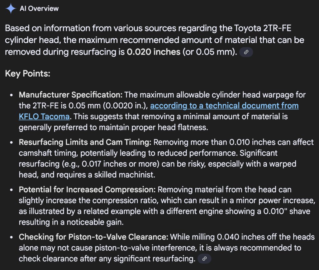

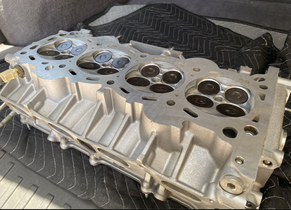

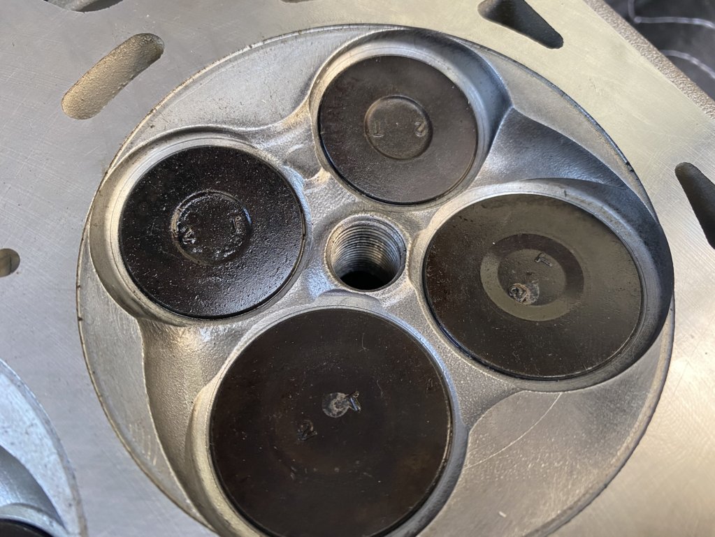

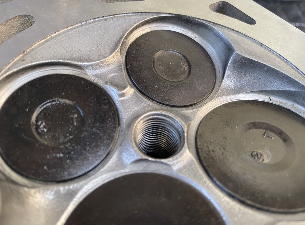

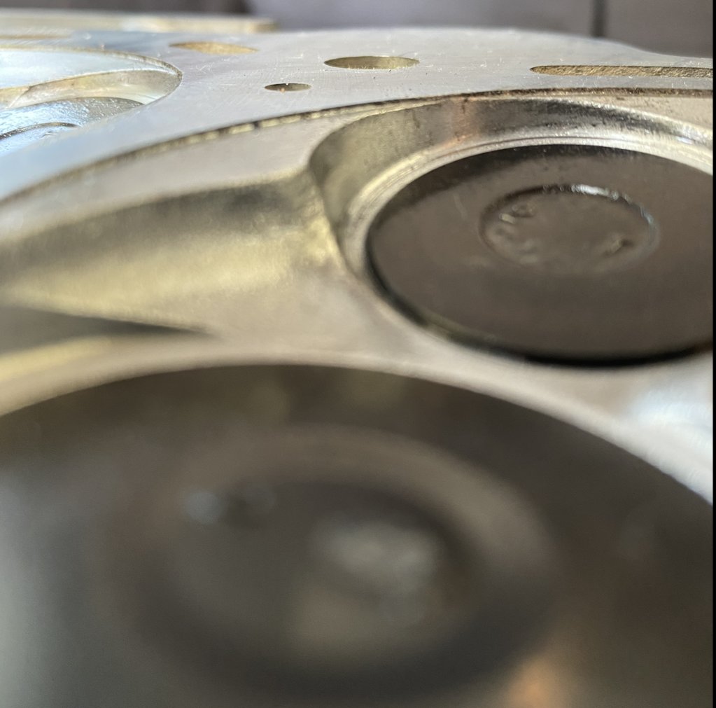

    Well, unusual things happened today. Picked up the head and received a phone call from the machinist who owns the shop. I've been going to his shop for other stuff for four years. Never really knew him other than smalltalk but super polite guy and 5 star Google Reviews for years.
    He literally is never reopening his shop after today. I am not sure what his "big problem" was that he said he was having on the phone today, I can only assume political issues and I don't need to get into any more detail. I couldn't even pick up the head from him and he said to get it from a neighboring shop and pay them to pick it up. Seems likely I'll never be in communication with him again.
    What he was able to tell me is he took .006" off of the head's mating surface and I think based on the note that was stuck in the head when I picked it up he may have lapped the valves? They were wet and he did say he at least replaced the valve stem seals on the phone.
    Is .006" too much to where it will mess with timing codes when I put it back together? @Torspd @Dm93 @Speedytech7 @BassAckwards @TnShooter
    This is what Google said:
    And on TW
    https://www.tacomaworld.com/threads...ylinder-head-2-7l.777264/page-2#post-27793363
    I don't know which route to take - use an OEM HG? Get a .030 HG from Mahle like @BassAckwards (although he had .010" removed for his head to be in spec with the .030 Mahle)?
    There's no way to measure the factory HG from my engine as it was at the machine shop and he said he didn't see it this morning on the phone, I asked him a couple times.
    Pics of the work
    That's what he charged me. I didn't ask to do anything other than pressure check and check flatness, and new valve stem seals, but I think he went and maybe did more. Valves were wet while everything else was dry?
    Well, with all the stuff going on that can't be mentioned about on here in CA, there's one less. I was basically his last job before not returning to his business and I'm trying to figure out some stuff.
    New factory short block $2300+tax $350 in the head (up until now)
    @BassAckwards do you have any documentation stating that this would be a standard OEM HG thickness?
    I'm just a little scared about the hydraulic lifters and if I miss anything on the new OEM short block (Part 11400-75381 in case there’s information on parts included in it somewhere online - dealer parts guy couldn’t find a parts breakdown for it on the phone from where I picked it up) I need to move over from my engine.
    The lifters are all stiff and I hadn't had major issues with compression besides cyl 3 so I'm not sure if it's worth it to find something to insert into them and press the valve and let the oil out.
    This is the video where a head is put on a factory short block which I have too. I've been referencing along with the FSM you guys helped me gather.
    At 22:00 he installs piston oil jets. I'll have to open up my box with the short block to see if it comes with them. It's definitely got the counterbalance shaft / balance shaft timing assembly like the one in the video (I could see through the handle hole in the box). I don't think it would hurt to reuse mine if I clean them from my OG block.
    https://www.youtube.com/watch?v=NDvHgneYmYw&t=1388s

    Well that certainly sounds interesting. I wouldn't sweat six thou, I suspect there's greater variances than that in the heads when they're brand new.
    I'll see if I can find info on the lifters

    .006 is not a lot at all.
    I seriously doubt it would be an issue.
    Not unless you got really unlucky and had the chain and gears worn enough to add up to the threshold limit. (which I don't know the "number")

    The .020” was a number I got from measuring my old OEM gasket. I’d throw a .030” mahle gasket on it and soldier on. Nothing to worry about imo

    LC Engineering may also have some information on stock head thickness.
    Otherwise, find an OEM gasket thickness, then go a little thicker to compensate.
