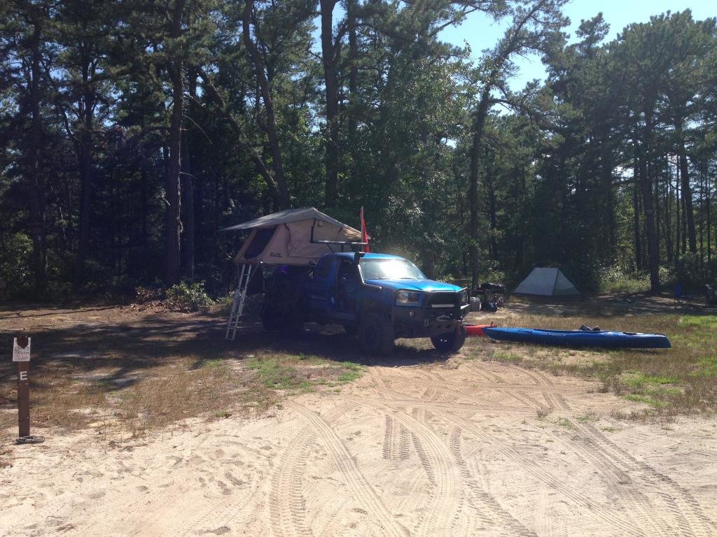

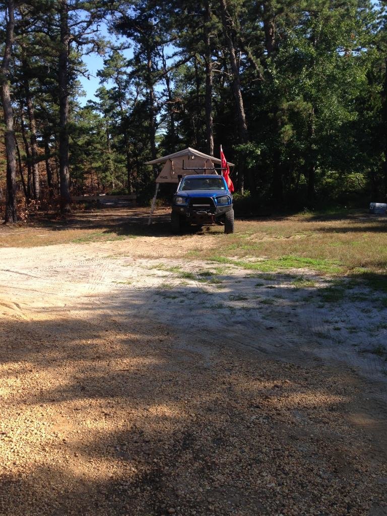

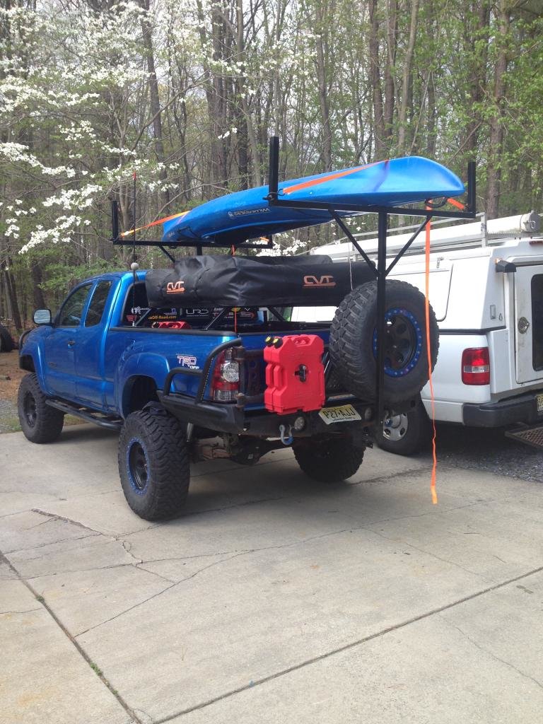

    Took the truck out for a camping/kayaking excursion this weekend, new kayak rack did great. I'll post some details on the rack build shortly
    95068B2C-8BCE-4BBA-AB4C-173164896E48_zps_08f71659a551702253e2707b0f79f73471ba42ba.jpg
    CE850458-01EA-46D9-98A3-4FA73303BC38_zps_77de9044aa9ee8d8b48813471fd7ec9fcd4ef8a2.jpg
    Waterside camping FTW!
    0B255C77-9A63-4043-9CBF-45327C240E37_zps_f090920df3a11ca8250a5666c814bbf134280d7e.jpg

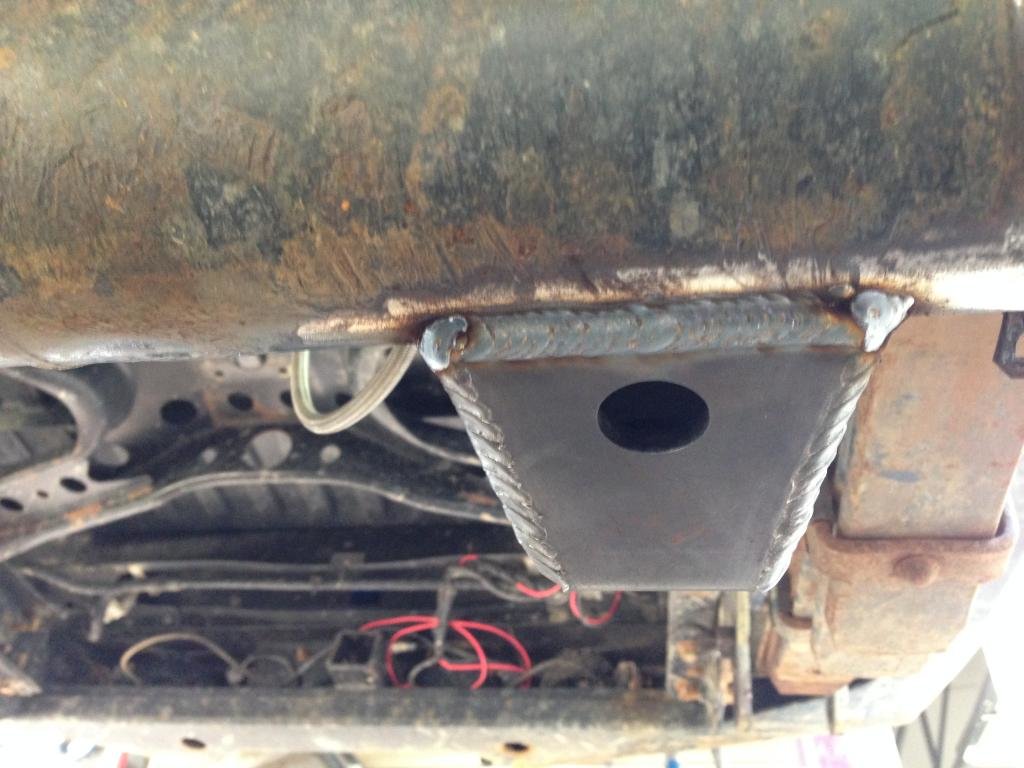

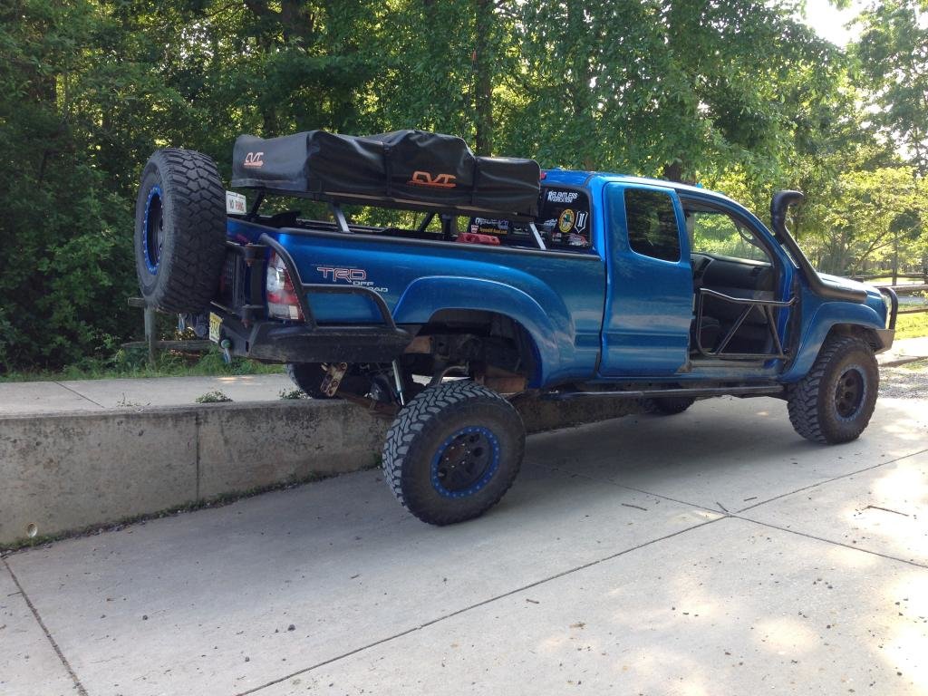

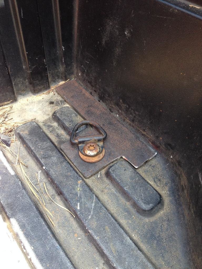

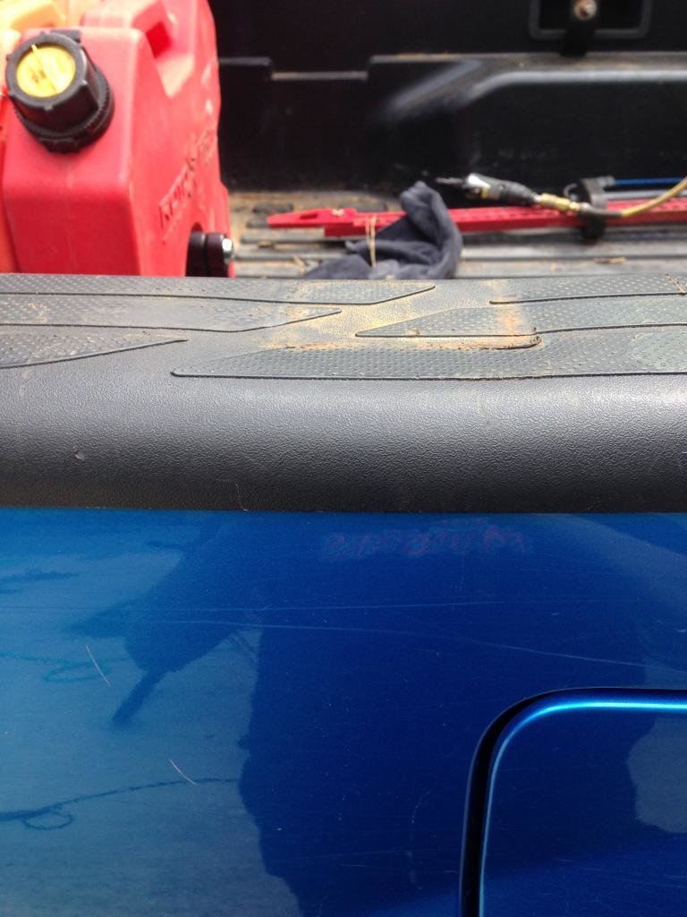

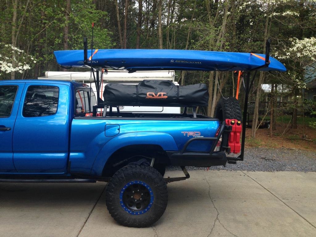

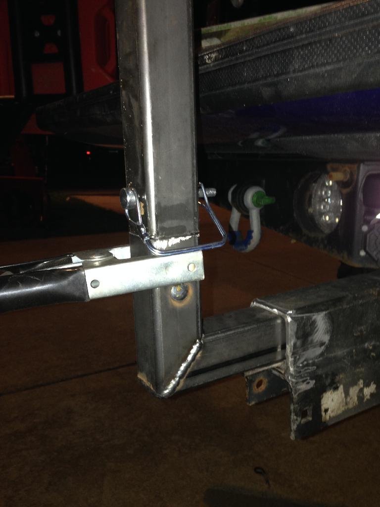

    Here is the Kayak rack I made, it should be able to haul 3-4 kays with ease. I made the rack so I could keep the bed rack installed as most of the time I'll be camping when I'm taking the Kayak anywhere, otherwise I'd just load them in the bed.
    My previous bed rack design was lacking in the mounting leg area so it had slightly crunched the top bed rails.

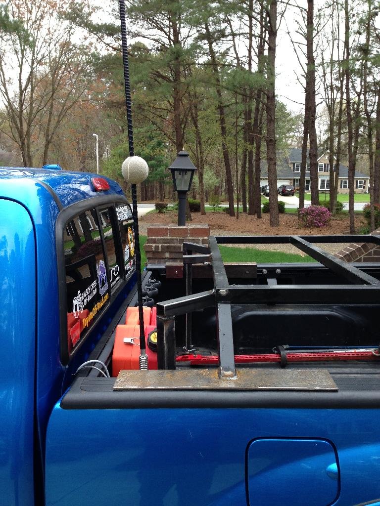

    1FEAF1A3-1F96-46A0-B2B6-AFD09594B552_zps_9b1bc9407379c89269c283c0e6cf596ffcf1785b.jpg
    Plan was to fix this at the same time. Bed rack v1.5 was born. Cut the old mounting feet off (3" length of 3x3 angle iron.)
    BEDB9372-AA86-4FE1-AB54-DCCCA54B411D_zps_94bf04221c33a1b07e13abd5c4c8bce7462b566c.jpg

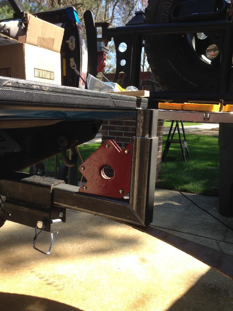

    New mounts made (15" length of 4x3" angle iron), which allowed much more surface area for distribution of the weight.
    D3436E61-AA73-4485-8C3E-61C9B285AA6E_zps_59007bc51bc8d9c4cc1e59f5a9e5b6bb5c813a57.jpg

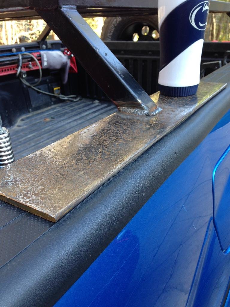

    Then started a little extra mounting with some 3/16" plate
    2580E71C-074F-4F40-84FE-0ED6BB2D8A4E_zps_5c9ded2b475b278acbdab4c442b8b66c10c863c9.jpg

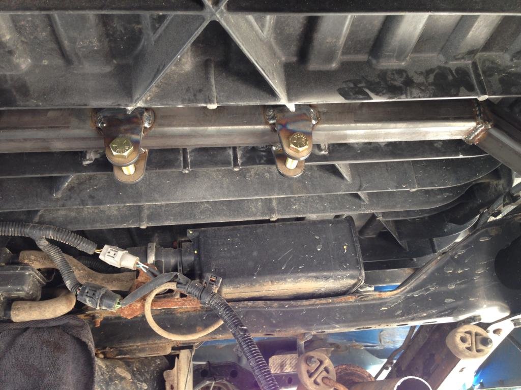

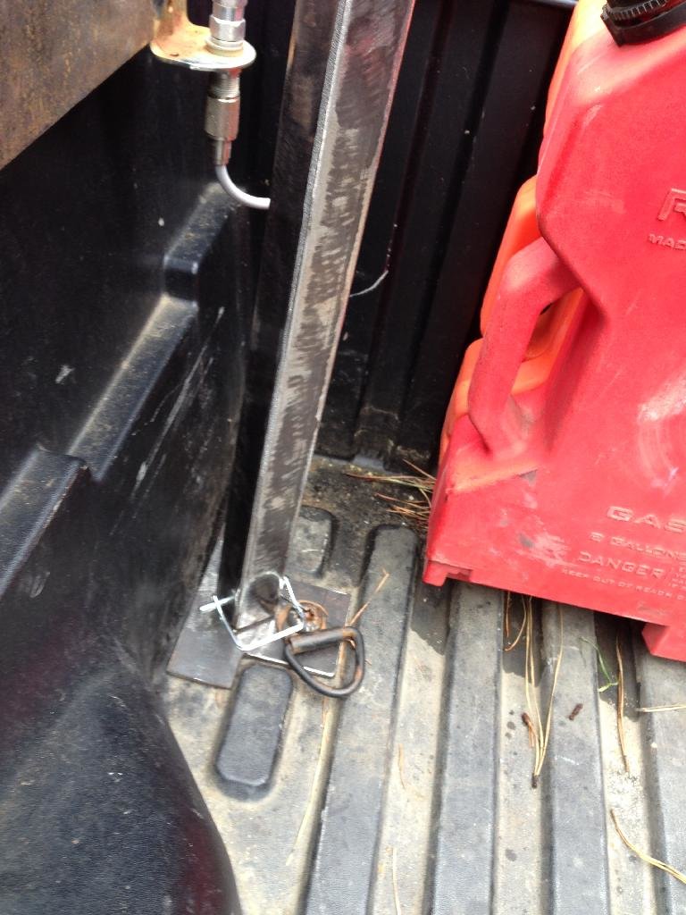

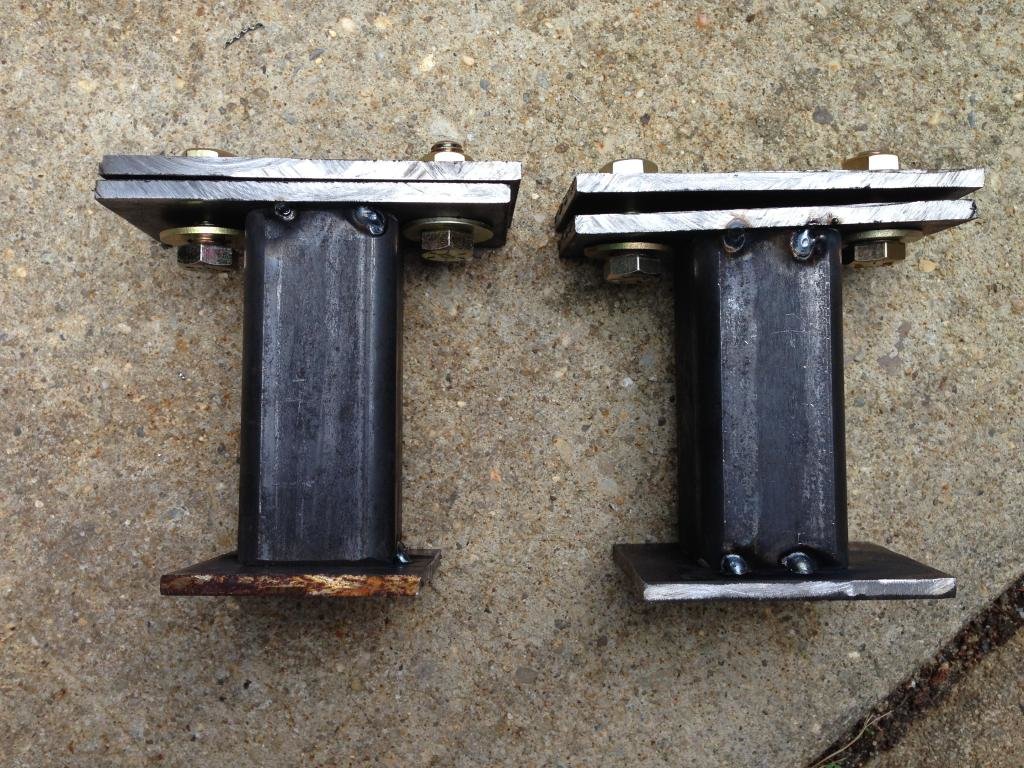

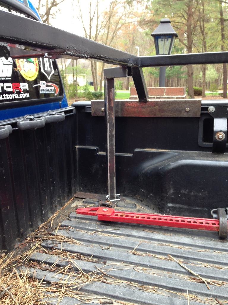

    Made quick disconnectable feet that tie into the bed box itself
    07AE2934-1EC0-4E1E-AE72-A2943E559BE4_zps_5e456c3bbdbb1dff95885b4b0a4fa04a13ba0c23.jpg
    AA4070F6-31E7-430E-9731-8FEAF3DFDBCC_zps_13e9a3dd33344ea5c5f625b44c63adb64a384a22.jpg
    29B01ED2-2681-4755-9452-BA8D55D08A80_zps_23a16da173e7420468f85b854e6bf80674877225.jpg

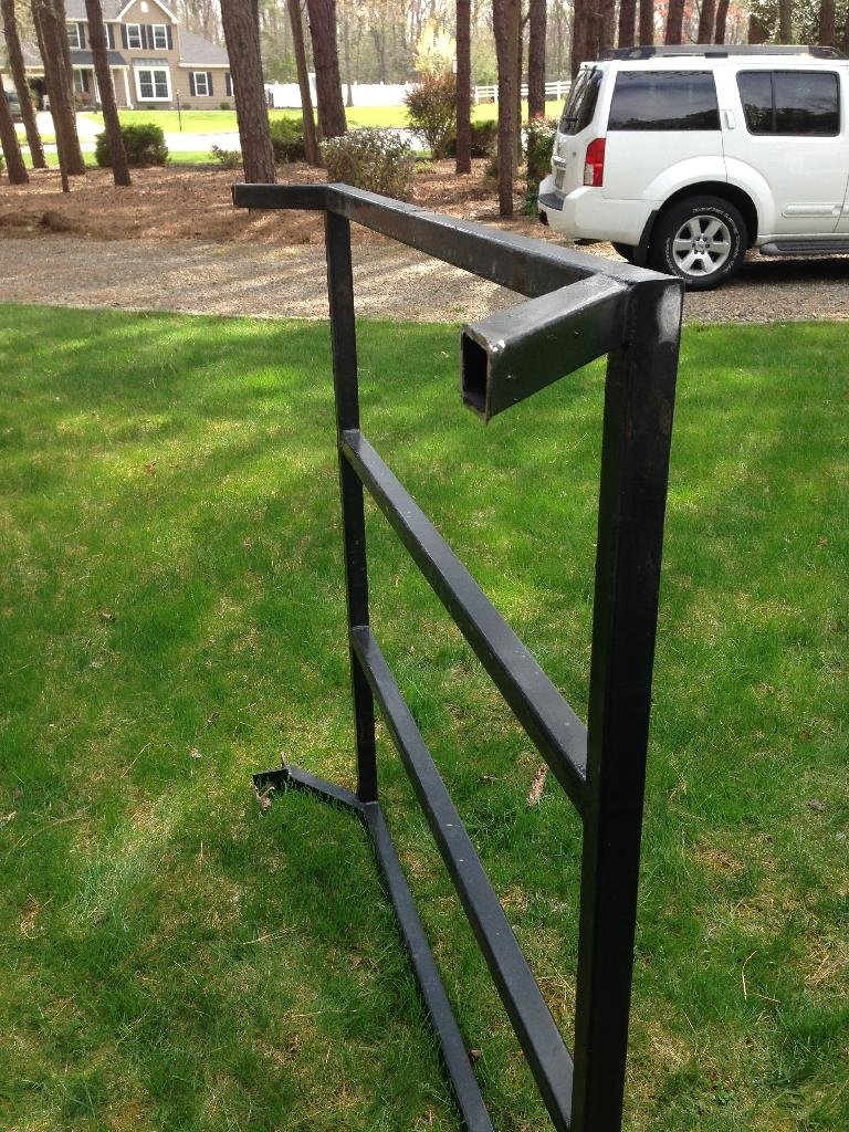

    Then proceeded on to make a rack for the kayaks with some left over steel I had and a receiver hitch I found on the side of the road :laugh:
    745C4F18-5391-49AC-B257-5D39084DA445_zps_be4c16e5cbce371fd2bc290744453914f5d8562f.jpg
    F4808668-2F3D-4F5E-BE66-77B8C1371863_zps_9a4f8f1b7d3d23f080d10140f9e9a1219d98379e.jpg

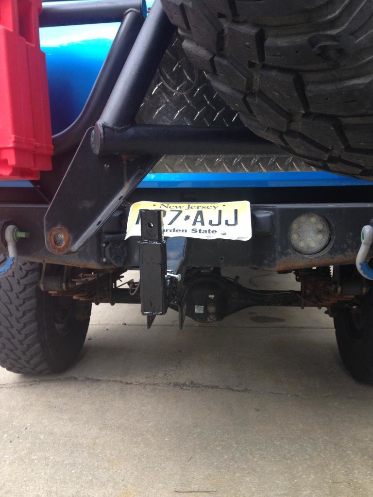

    Rear rack disconnects so I can still use the swingout without having to remove the rack from the receiver hitch.
    5C68ACC3-659B-4D26-A10E-DA84B7C230E0_zps_d72b6c3d58c823f838087da004ad2c60d449779a.jpg

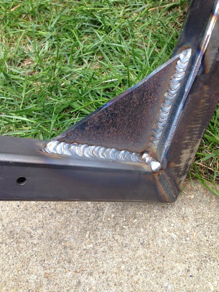

    Put some gussets on the 90* bends
    462E4F3B-E439-4950-A257-A35B79433651_zps_ab0e945191ef4836ca6a31179ad820eab6bbab5c.jpg

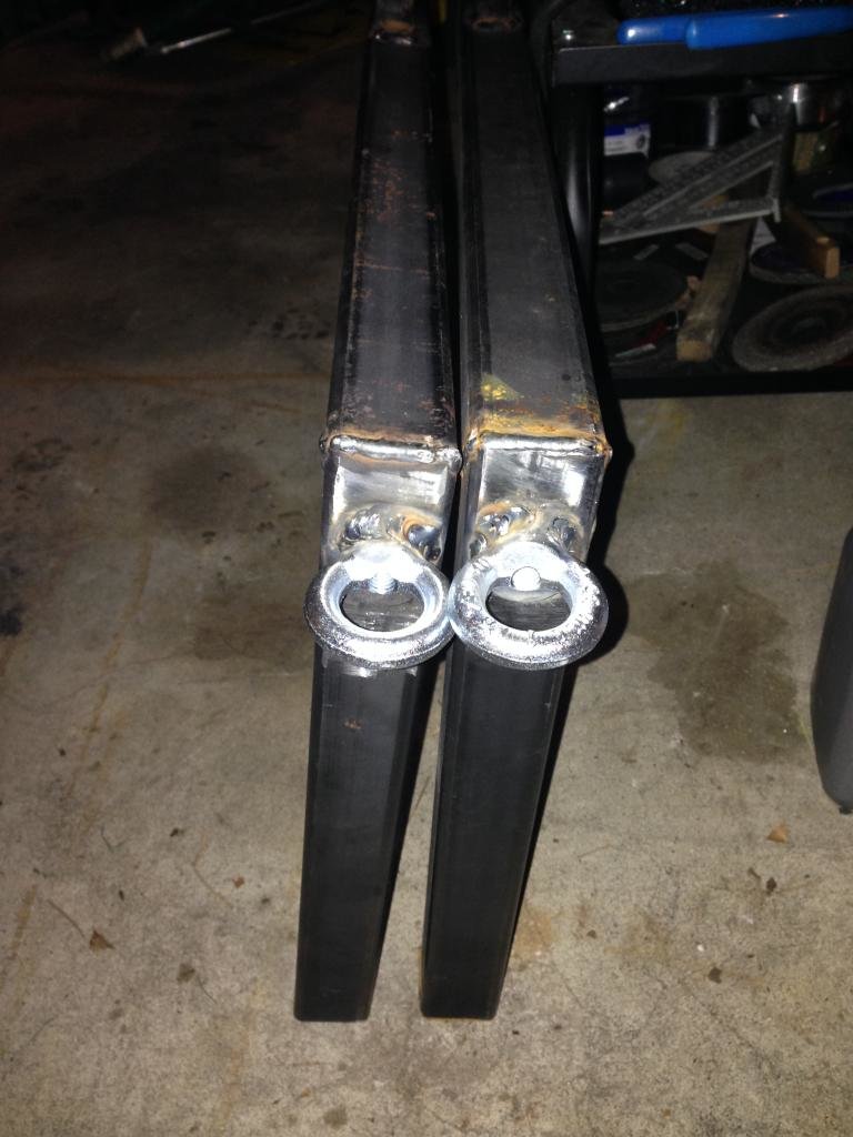

    Welded on some tie downs
    5ED61838-EFE5-44E2-A225-5003BA9C79DF_zps_c9f62ac5930892f2ffedeac0bb5651396a84b485.jpg
    Slapped some paint on and it is finished, and it disconnects in about 2 minutes.
    9E6EC781-C04E-4200-8258-476C353C4338_zps_5059a1b8dbb6547a7f44b454ac8fa24c7ac200d7.jpg
    851174D9-B31A-449F-A1A8-728E93DFB0FB_zps_172356de2f86663f7c9367a8c0275bd900f26584.jpg
    Since making it I have added some padding so the yaks won't get scratched, other than that it's working pretty well and it didn't cost me anything but a bit of my time to make.
    Casper66 and Pirhett like this.

    Looks great!
    Also looks heavy as f***

    Thanks Steve. It's not too bad, I used .120 wall tubing for the main cross bars and .083 for the supports so I'd say it weighs maybe 25 lbs per rack, not too bad really. I think I'm done adding tube to the back tho :laughing:

    No I guess that's not to bad then... Must have Moar black pipe!!!! In cab or around cab :anonymous:

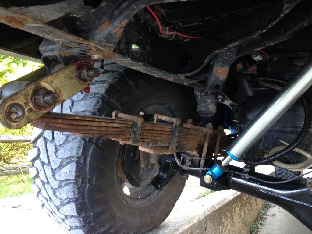

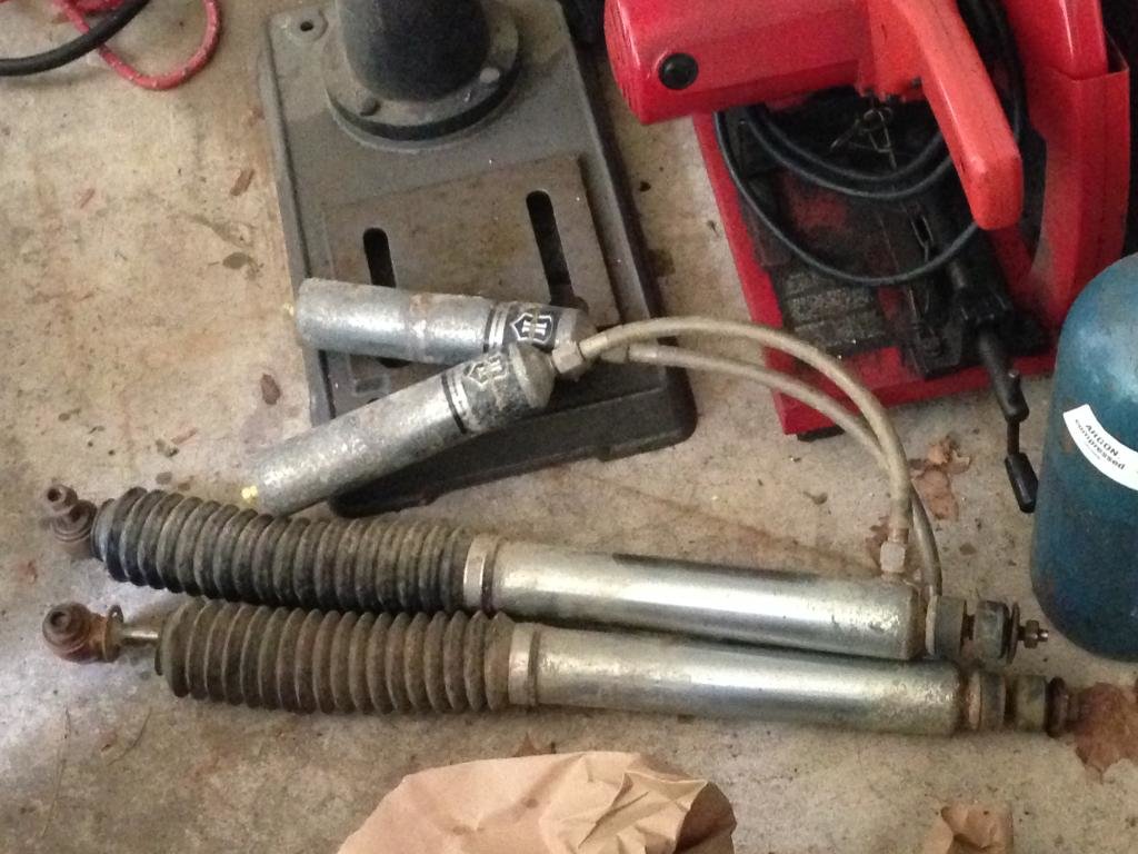

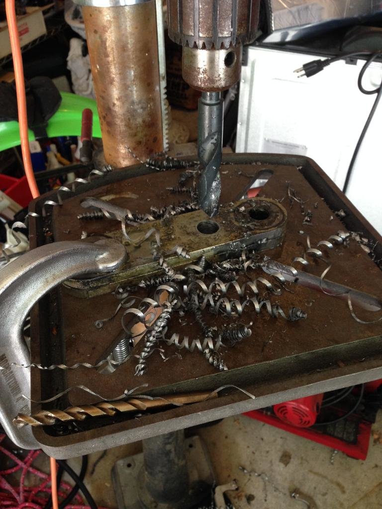

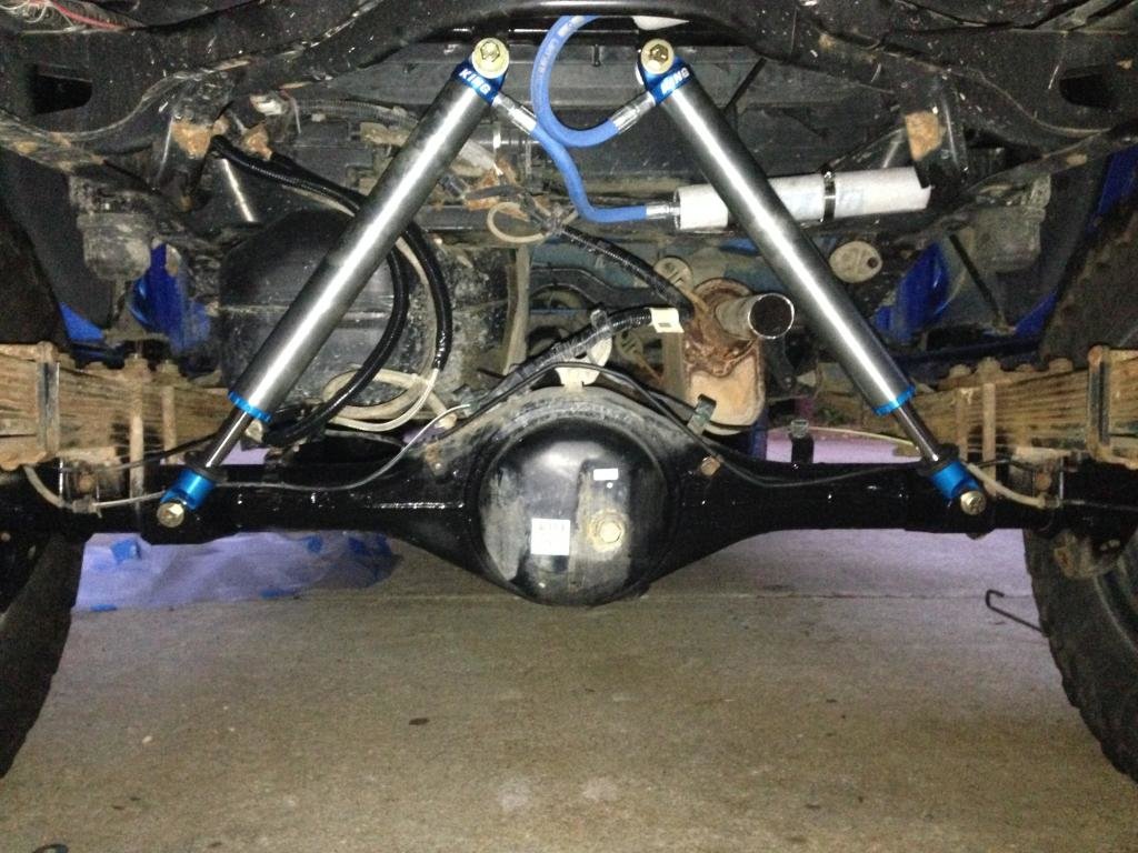

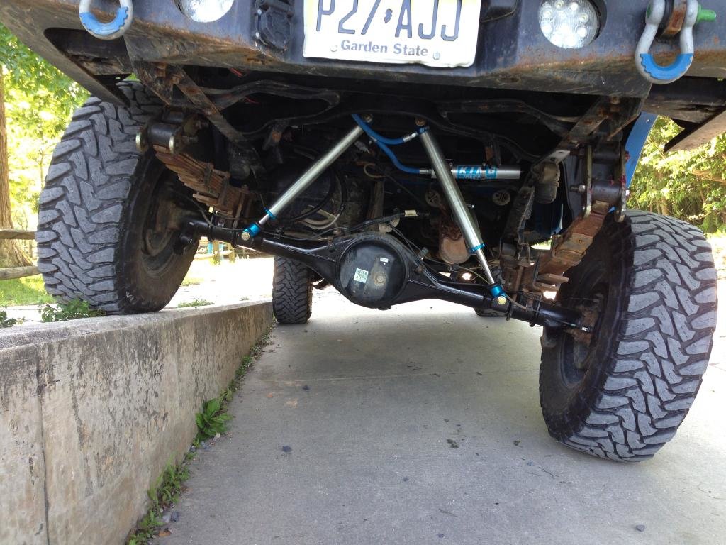

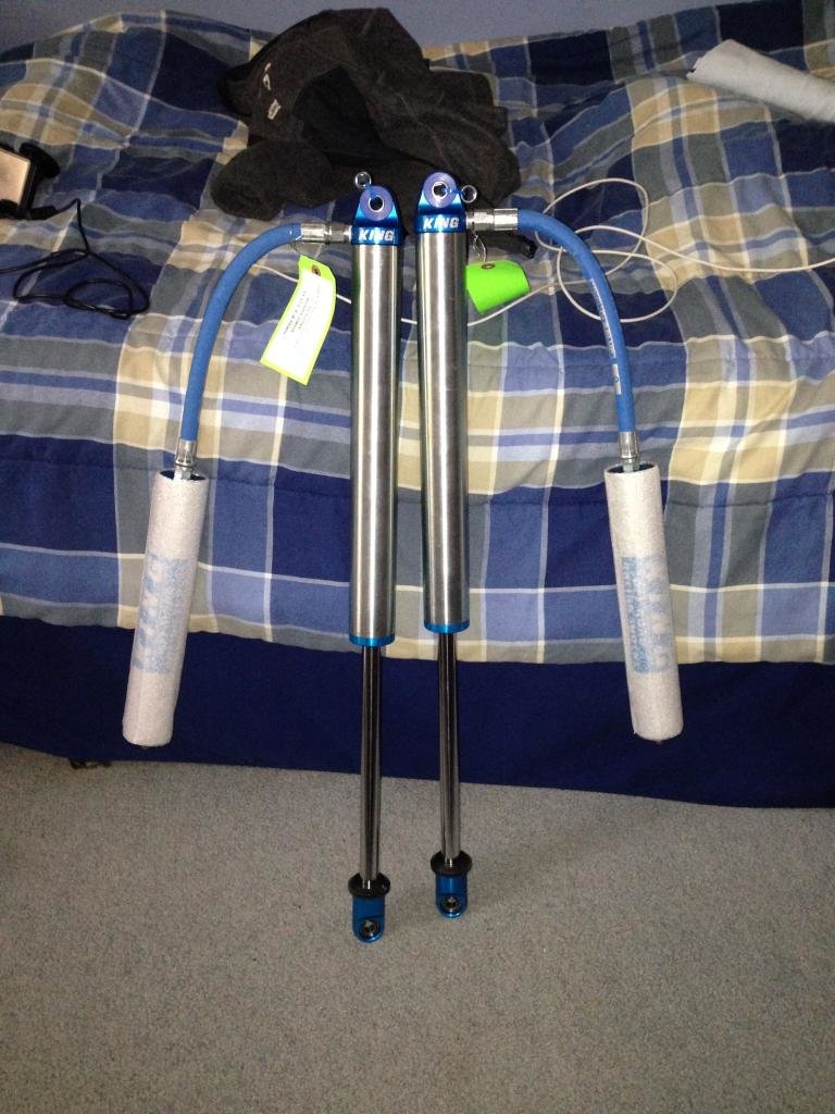

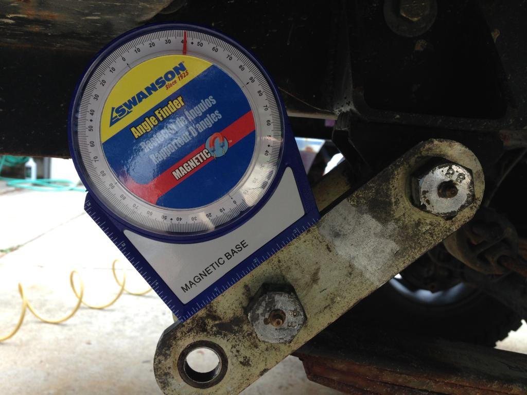

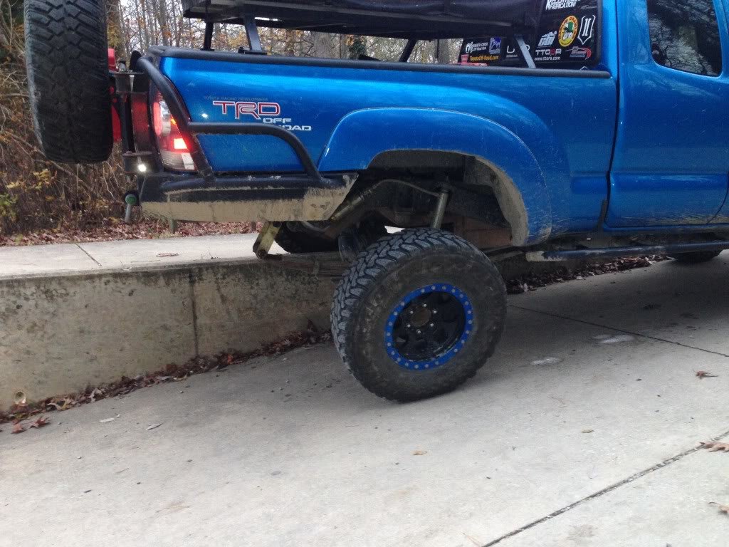

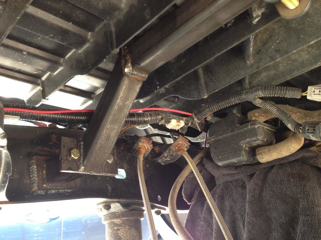

    After I did the shackle flip my current shocks were a little too short and the 6" shackle I had used was a bit too long so I went to work on fixing those issues. I've seen the shock relo kits that some people offer and I am not a fan of them, mainly because of the price and seconly people have issues with the tires scrubbing the shocks at full stuff and are forced to run wheel spacers. The final cost of everything I did (minus the shocks) was ~$75 and a bit of my time.
    So I decided to inboard the shocks and retain the bed, here is the outcome:
    2.0 Icons sold to another TW member, plenty of good milage left in them.
    F3015297-8015-4A2C-BD20-0B2736A27878_zps_a949b5d0e4dc0fea505a7ad28d0d19481e357abd.jpg
    Shackle redrilled to 4"
    E6D29D55-2BBC-4A86-8F05-68455FE46934_zps_7431b3c8dbc4e2a729fcb6aa30abb1f28be912df.jpg
    Mucho better shackle angle at ride height
    60088346-B2DD-4926-B43E-EB48239A2B94_zps_d18c3cbf8d0c26a2a22189f047ac350666bf08b2.jpg

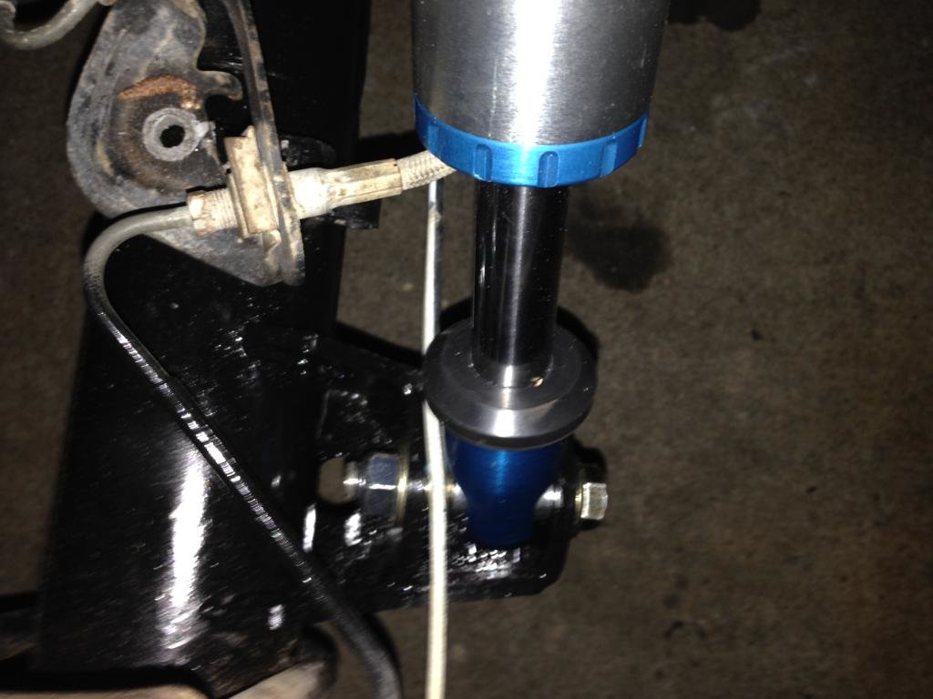

    In with the new, 12" stroke remote resi King performance series.
    C2233454-CA9D-490B-A0BB-CB78304E7A1A_zps_371cac8f6d73080163bd1f7445451aaac8cd64a5.jpg

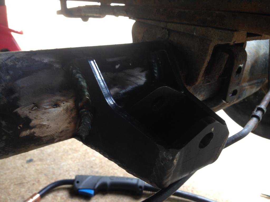

    1/4" axle mounts should be able to take a decent beating
    116CB1A9-FF53-44F6-985D-EFFDFCE49CE1_zps_a194a8f6f9224d6b6413189820bae034ecd22df4.jpg
    Burned in
    4252D7A6-BD10-4FB0-AF86-75D12CB1F91E_zps_c322913bca29df3fcbf1696dd4989097313a60f2.jpg
    25D468AD-054A-414F-85E7-F9C740B26F71_zps_a0447eaff9c0bd752f858c2e1319ac7528a4d55a.jpg

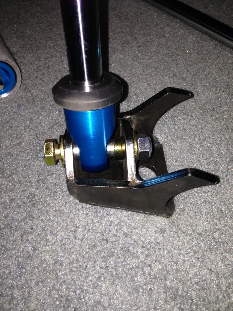

    Top mount is home made with 3/16" wall tubing and 1/4" mounting tabs with bolted disconnects in case I need to change mounting angles
    ECD188D4-FAB2-4F92-9C4C-7B06C0CD5E53_zps_c80f4d7b355a1f311983860573872f257a4749dc.jpg
    C9159C60-7DFB-4664-BBED-D9446C4A1EDA_zps_3e1f9417d30585a24b9515e16b448ff640ffe81c.jpg
    97459509-0116-4BE7-AFE9-7514C71DB5CF_zps_b3ad4633e86632ab854d993071c413fe10cca081.jpg

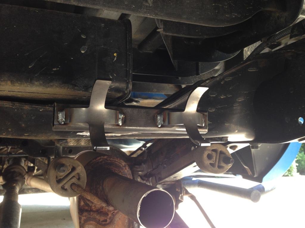

    Resi mount, unfortunately the gas tank was in the way on the other side and I spent some time thinking of the best way to mount it and couldn't come up with anything so I just tucked the other resi up between the spare tire cross member and zip tied it :anonymous:
    5F5C3CDF-09EE-4D4E-851B-3AAFCDF9CEA8_zps_5827e40852145ffae50fb4d761fd5838940667c8.jpg
    Ride height
    B6FECBEF-4AB8-4804-AF73-0579D33B210F_zps_9bc1fac3d011b3e4ff06f575df5dbb89c4631e86.jpg
    Eventually welded another tab on to secure the bracket where the hard/soft brake lines meet at the axle, just kinda dangling here in the breeze :eek:. Also had to cut off and reweld a couple of the stock brake and ABS mount brackets so they didn't interfere with the new shocks.
    0D3D5CC3-D116-4A17-934E-14AD0870D6C7_zps_5ddc3bcb9e29b20353b6bbf8d973e8e5cce841ea.jpg
    Not quite full stuff or full droop but you get the idea, I may need to extend the bumpstops by an inch or so to keep the leafs from going into negative arch.
    B7806FD4-9474-4059-AC64-4662B49C8770_zps_46f9d9a5c579dcd8a9cd2119b9e39c2c148be9ff.jpg
    864D2971-72B5-4B17-AED0-EE70A598C730_zps_0c6d83b1da7a9b00108efa9f7a6df8a5f5df14bc.jpg
    Here's a comparison shot and you can see I'm not even at full droop and with the 4" shackle and new shock setup I will get a decent amount of more travel compared to the old setup and it feels like the travel is causing less binding and is overall more fitting for the truck.
    Old
    New
    988AEDD8-F771-462F-B139-6E73AA2C1357_zps_c4f09454d18b3e8f259f6c4ac5a63d95fe62616b.jpg
    Was pretty happy with how it turned out and I haven't noticed any adverse effects of inboarding the shocks I've had the truck up to highway speeds and also some fire roads doing 20-30+mph and it feels about the same as with the old setup. I kept the old shock brackets on for now but might cut em off later if I get hung up on them. The shocks ended up around a 30* angle at ride height.
