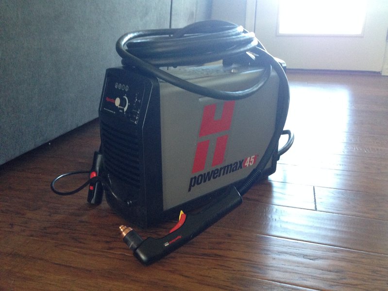

    Got this bad boy yesterday, have to finish running a 220 line for my compressor but I'm looking forward to ditching the suicide wheel :)

    Thanks mang! Looking forward to using it. Got a couple projects lined up where it will come in handy.

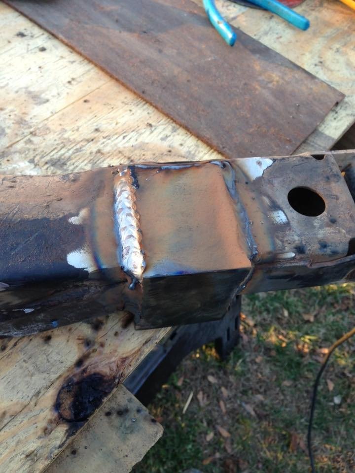

    I have the miller 211. It is 110 or 220V depending on what you have available you just have to swap out the plugs. I recently finished running a 220V line in my new house for it so now I run it on 220. It did up to 3/16" on single pass on 110 but now I can do 3/8" on 220V.
    Here's a shot of Craig's crossmember I did on 220, 1/4" angle iron melted pretty good :D

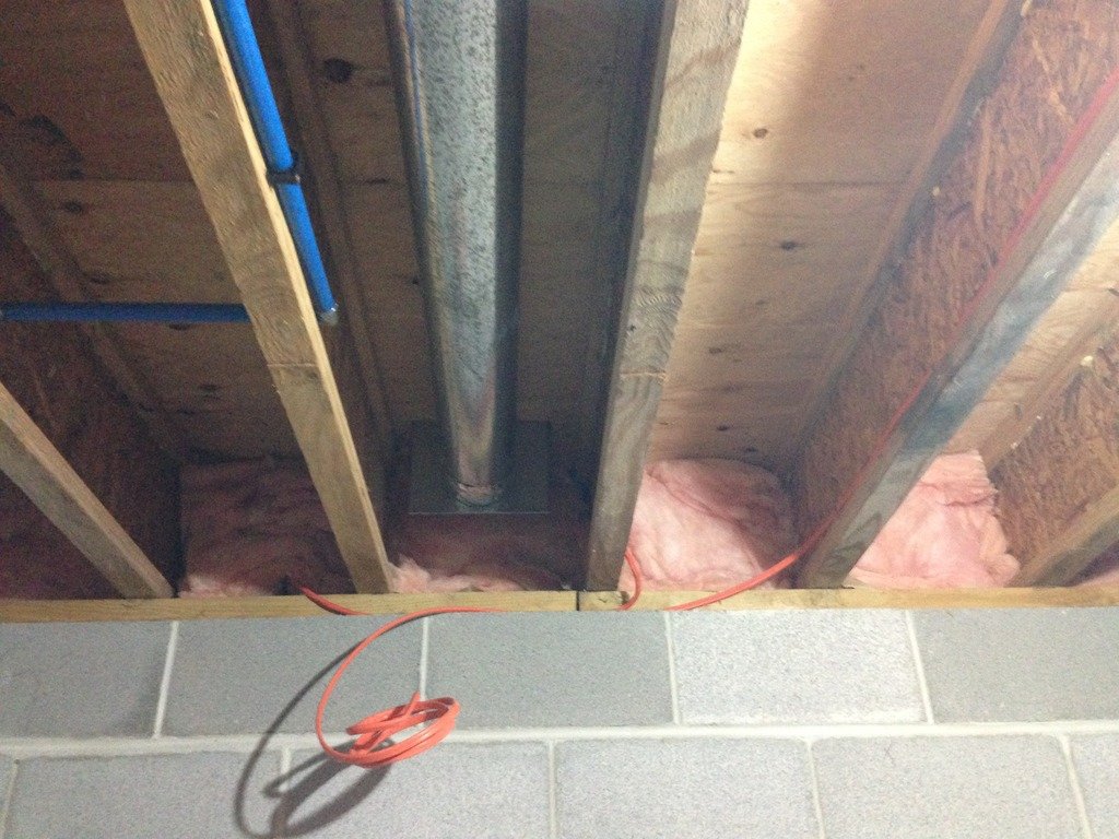

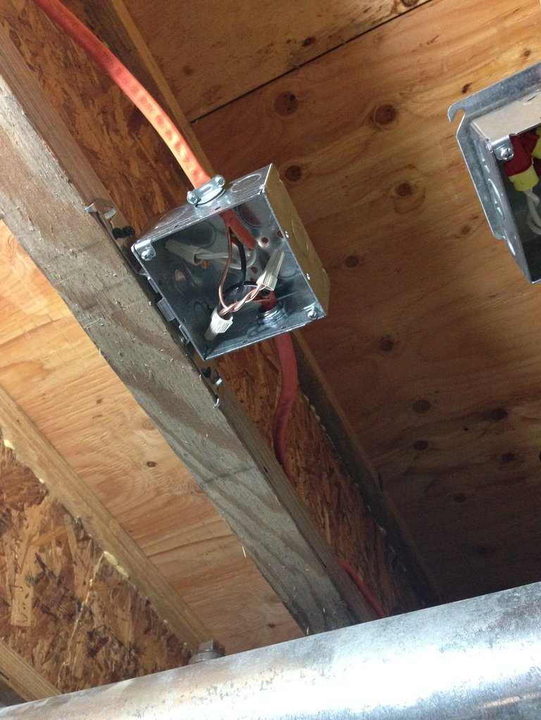

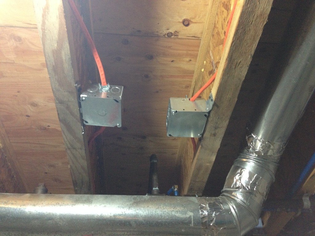

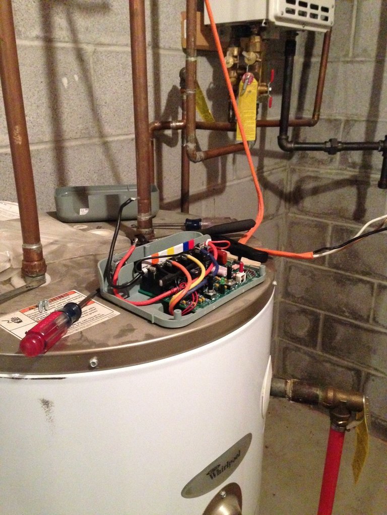

    Worked today on getting the 220V electrical ran for my compressor. My house had both electric and a hot water heater and I no longer use the electric hot water heater, so I disconnected it and spliced in a junction box to run into my garage. I did a similar method for my welding 220V line, but I used the dryer line since I now have a gas dryer and no longer need the plug in the laundry room. 10/2 wire should be good for 30 amps I believe I that will be sufficient for the compressor.
    3DD109D5-6791-49B5-A008-DF36FDA208B3_zps_cc2f08727ca1dc5884a07c4856f9566229d1ba1e.jpg
    FEA3CBF7-A40E-417A-87F8-5D15B573C333_zps_76572765f58a97b82e72248223d67ff7a39a703d.jpg
    Left is the line for the compressor (10/2 wire) and the right is the line for the dryer (10/3 cable)
    FD2C05F1-FE5E-4200-8DA1-A5219146F90E_zps_b0e05647414a22c3e9a662b2517bde20ea99c778.jpg
    Ran the line into to garage, then I will hardwire the compressor from there or maybe install a line disconnect for safety measures
    5D644E0B-0106-4DE7-ADF0-F6A615577AE5_zps_2230dbeeaac2f57e557175bdaf62d18342254d59.jpg

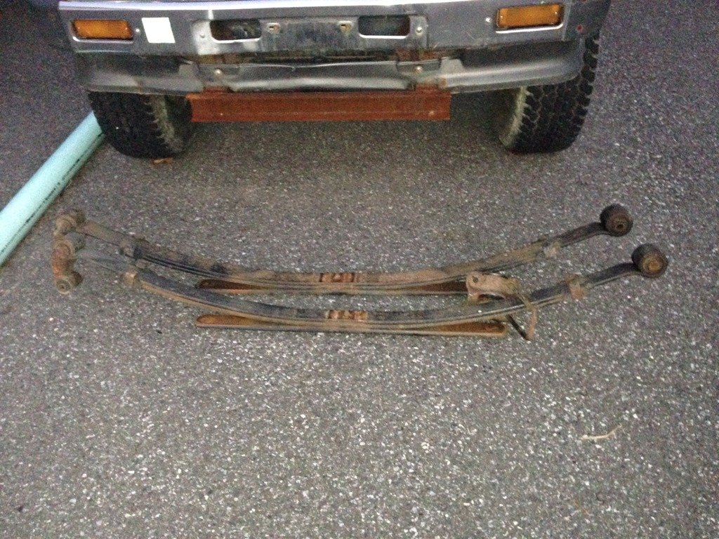

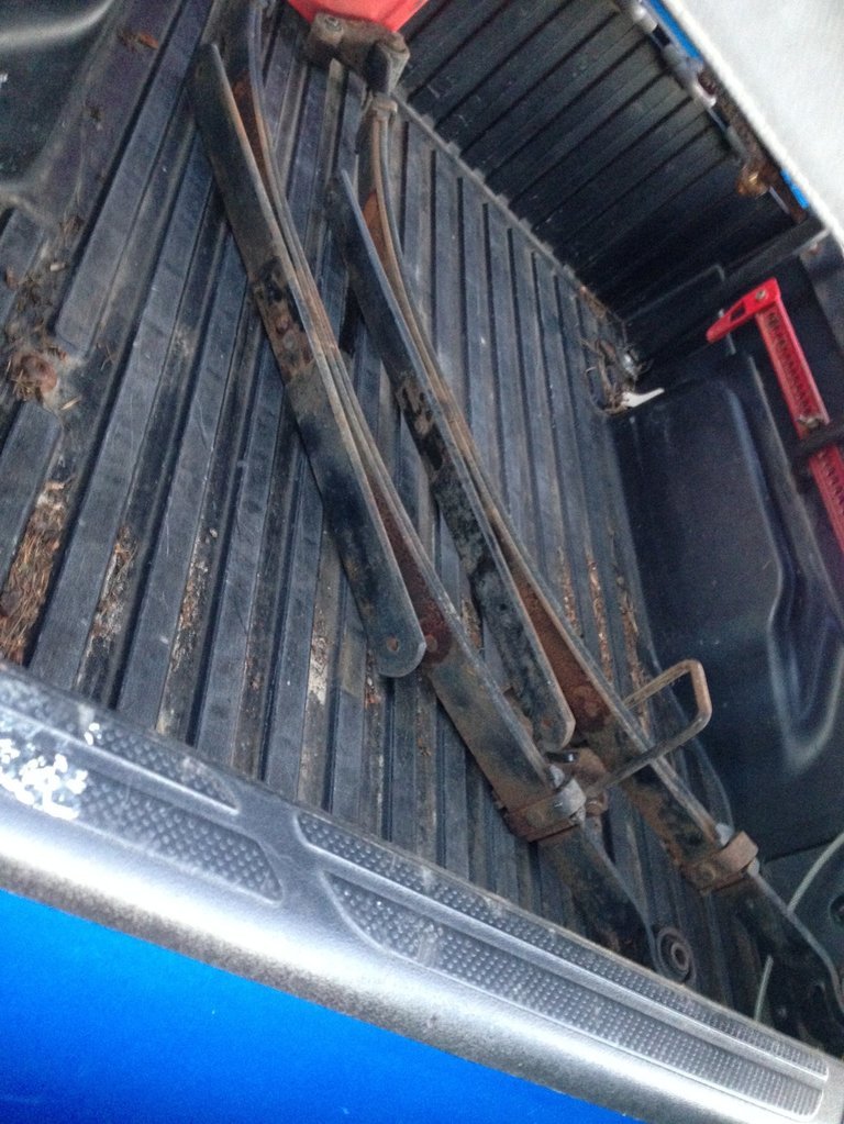

    Stopped at the local junkyard and picked up some chevy 63s, gonna need some new bushings but they are in pretty good shape

    10 wire is good... Disconnect isn't necessary if the breaker box is in line of site which I'm assuming it isn't
