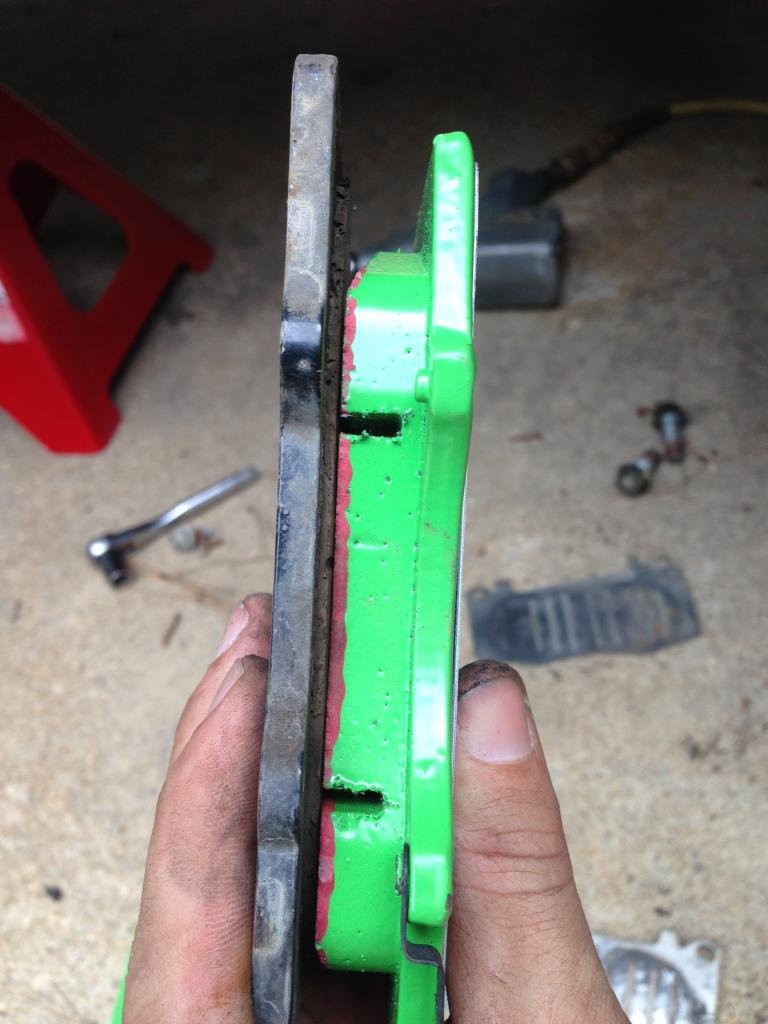

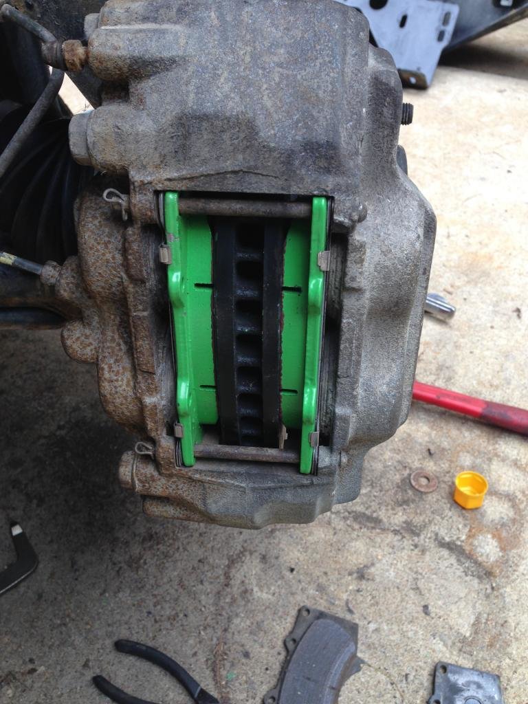

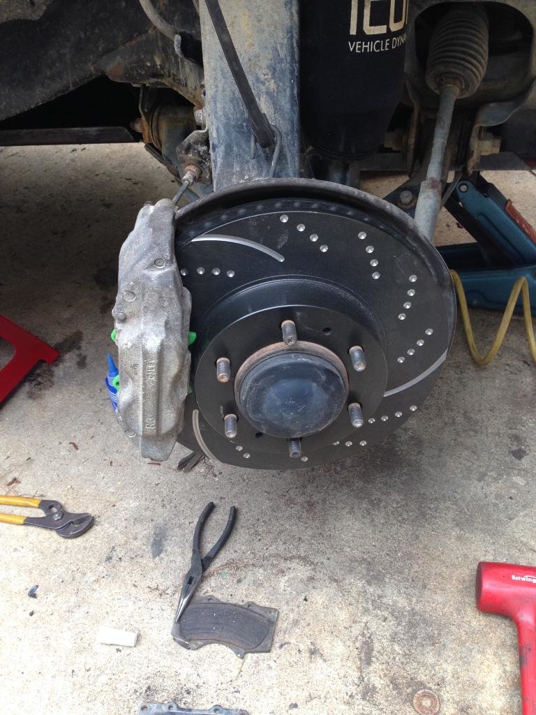

    New front brakes, EBC rotors and pads. OEM pads lasted 38k and were at the wear marks. :eek:

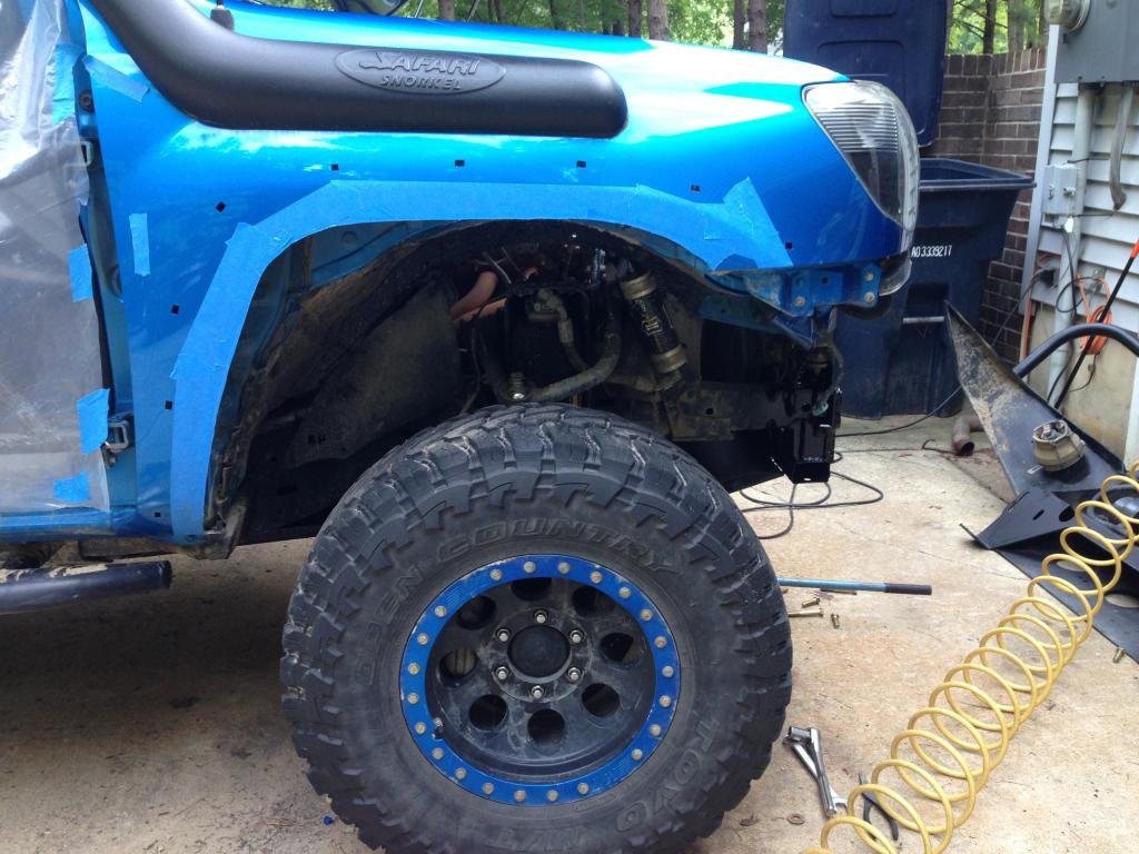

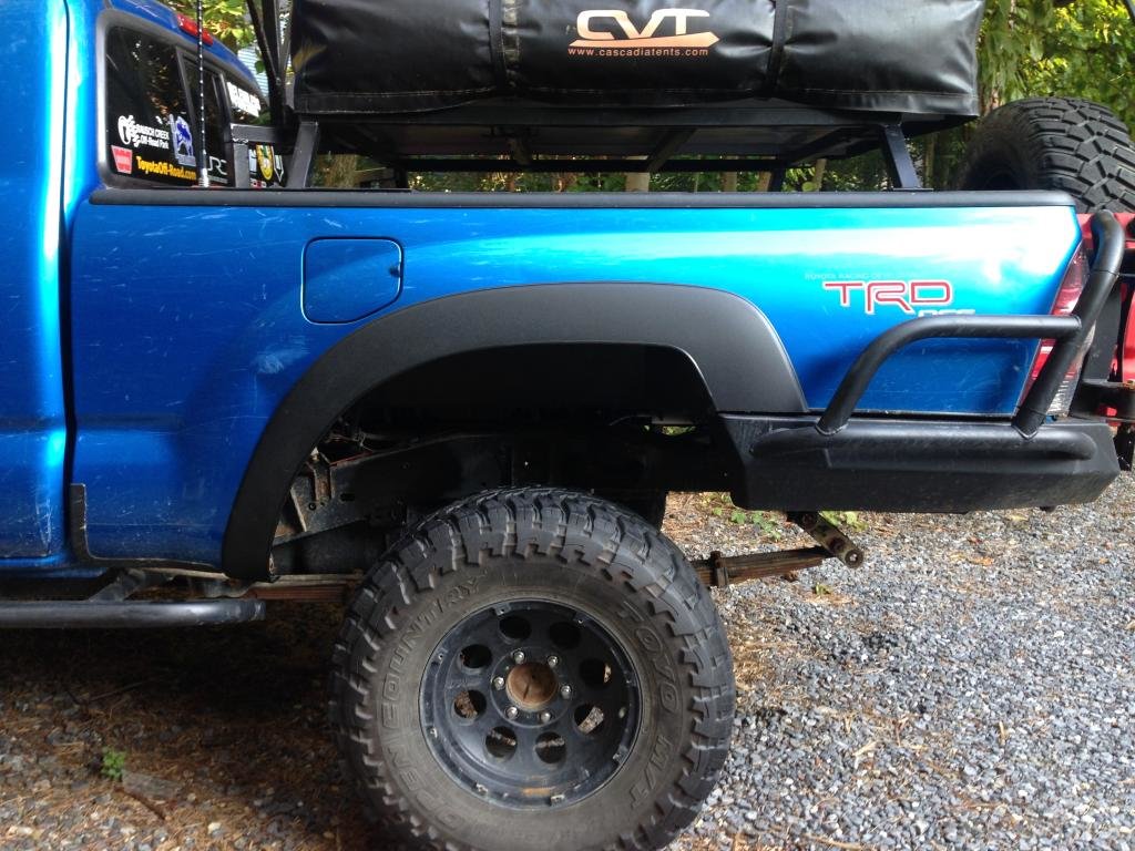

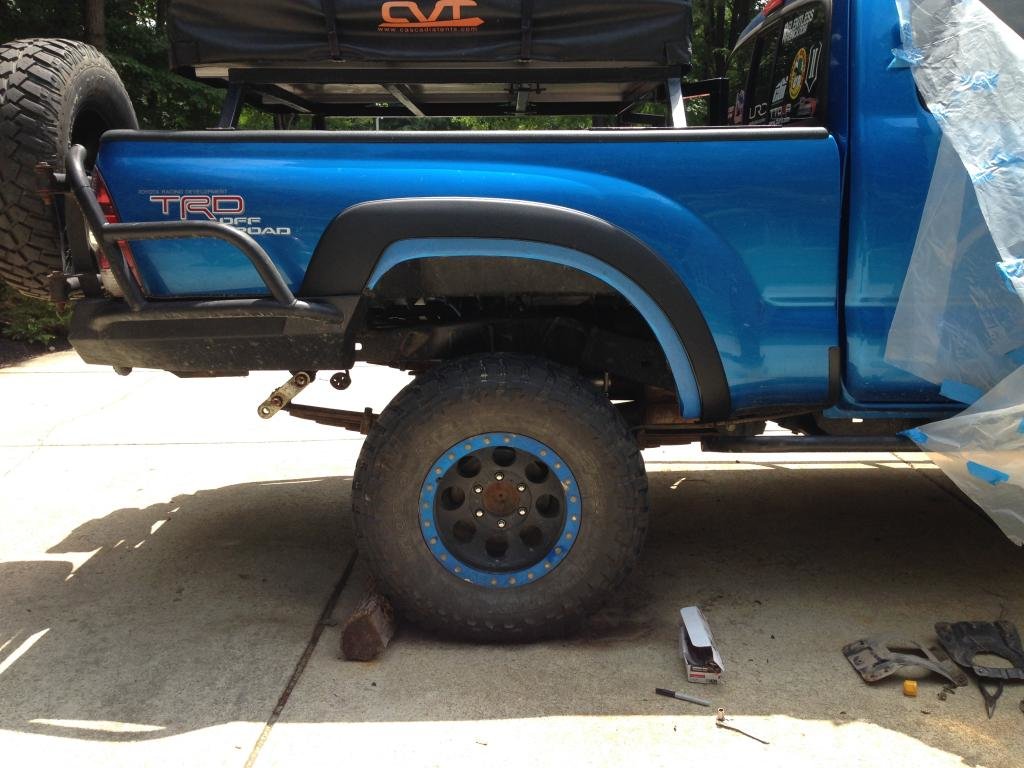

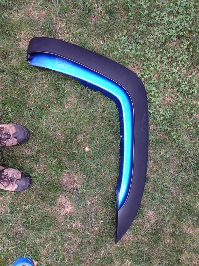

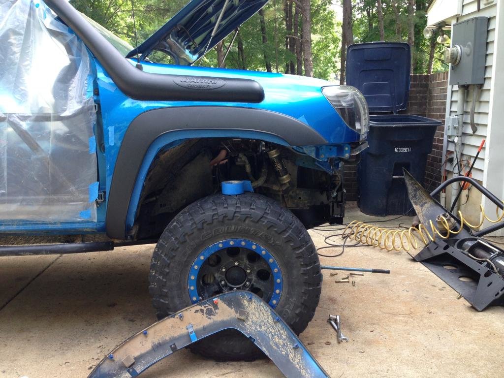

    Also got my fenders chopped in preparation for some new tires. Took 2" out of the front and rear fenders to match the flares HomerTaco did for me.
    BD4C86EB-9A5A-4AEA-AF33-A3576577B555_zps_64a20a95ba46f0b71f3e04a3b8ec8649e7cfb61f.jpg
    EE468B86-BB4D-4E5E-9B59-B7A00E1F89BA_zps_60562f5a2945198e34d86fea9d6e205442c8fdb1.jpg
    5025CDAB-F446-42F2-BD22-B8A5E697B4A6_zps_2dc4c3137d54b0c38884d257660237dd28a318cd.jpg

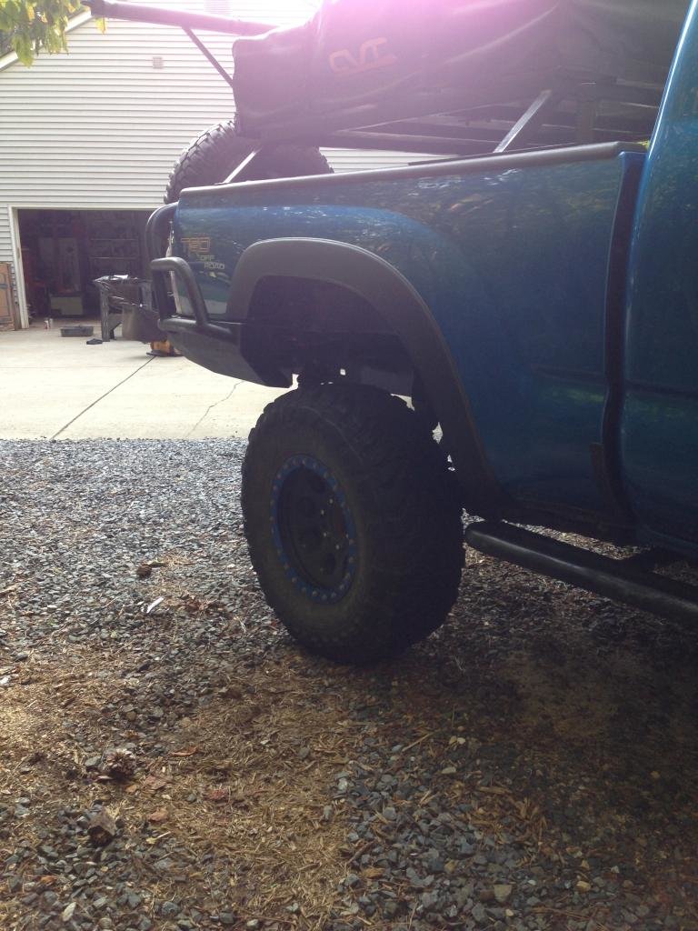

    Kepst the rear flares lined up with the rear bumper and cut 2" out of the rest of them, should have no problem clearing the tires in the back

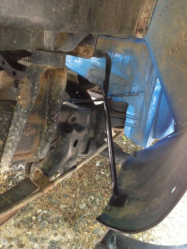

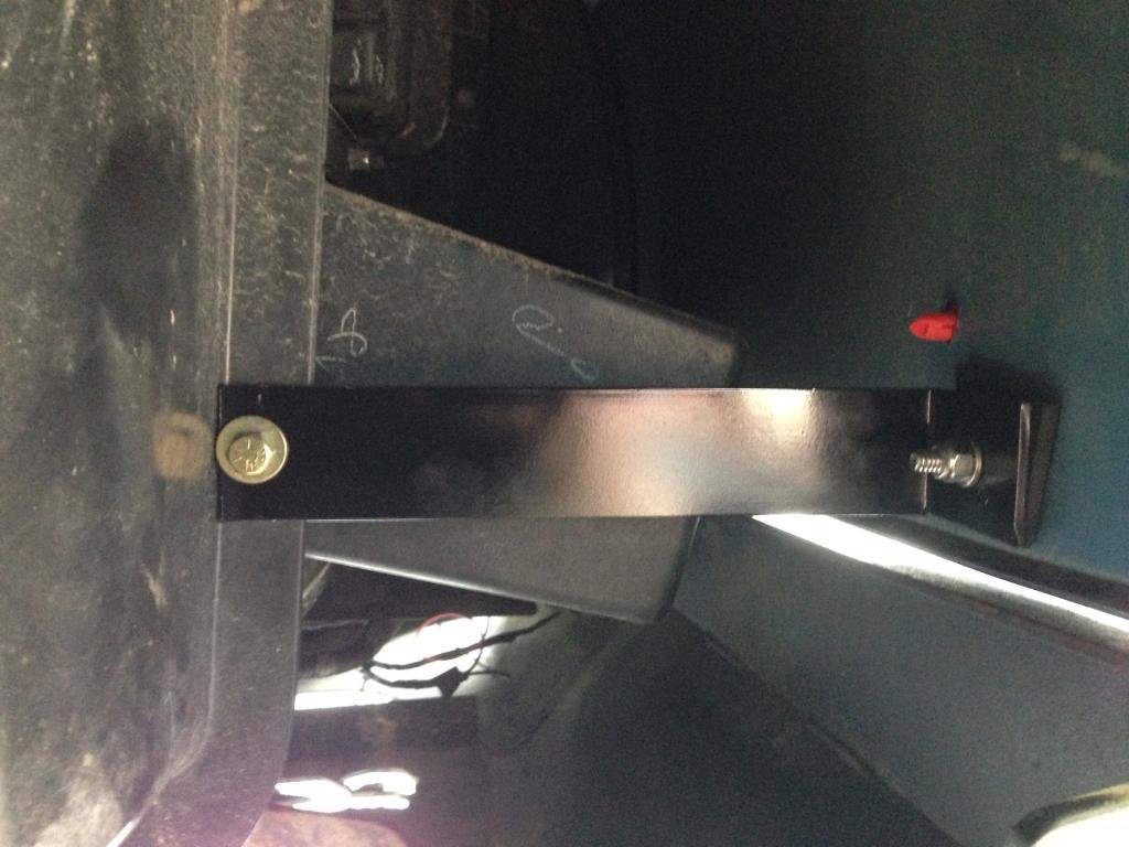

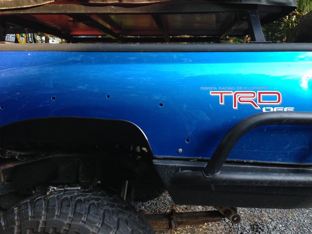

    After cutting all the bedside supports out I noticed they were flopping in the breeze so I made up a bracket for the back and reworked the front one
    Drilled a hole in the bed to mount a new bracket
    FCC412AA-185A-4A9F-8218-AC3EC27FDC7D_zps_0aef795c099eec037d96635a64d8b27ea63b3904.jpg

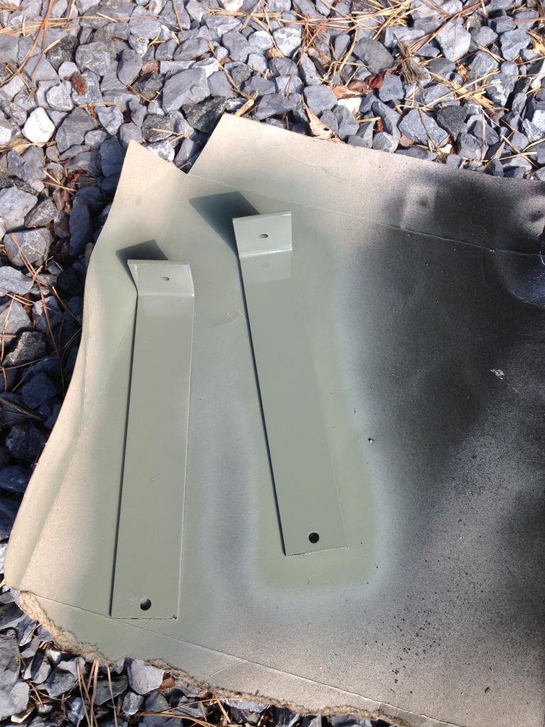

    Some 1.5" .120 aluminum bent to fit.
    F351FB58-57DF-40D5-846A-57E77046605E_zps_40c6960ec29e8adb427ef4110d80da51ed8ab383.jpg
    Bolted with SS hardware, this bolt will be covered by the flare once it's on
    5B4D7EC6-D1B4-4131-9B81-0417E8214D74_zps_f07422c63631b7256b9c2fc470dd30331453597c.jpg
    Bedsides much sturdier now, no flopping around in the breeze now lol. I used a peice of rubber between the bedside and mount to keep the paint from rubbing off.
    29DB0B68-037F-421C-BD54-DEC503BAA4EC_zps_f2143c7a8fcf89906d891d45c6412ac65a770cc5.jpg
    Front mount was cut and reworked and welded back together.

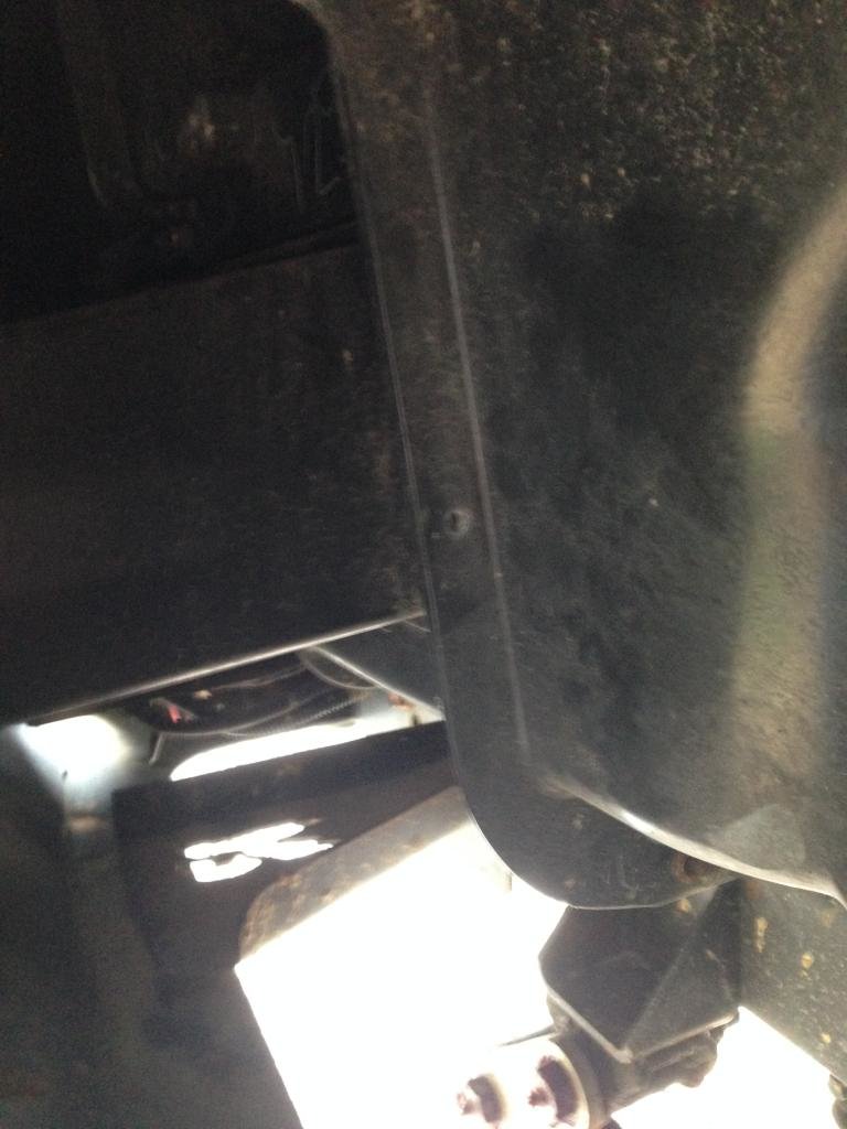

    Finished product, just need to trim the front bumper to match the new flare line. I think they turned out pretty decent! :)

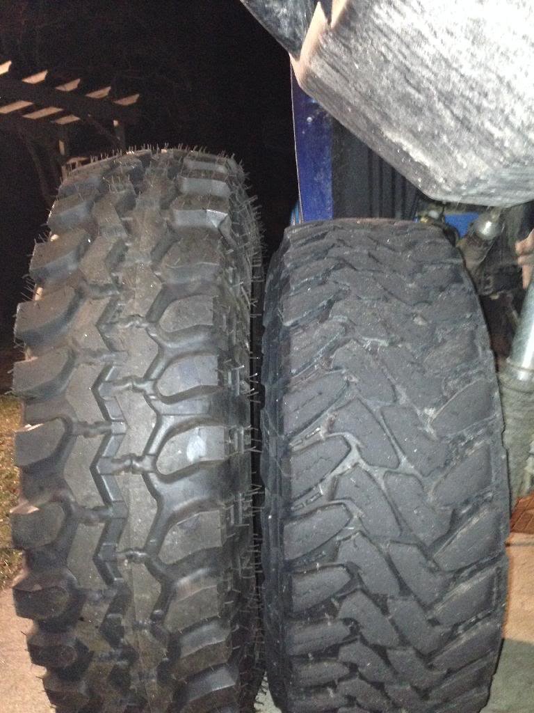

    Sneak preview ;) New setup is quite a bit bigger than the 285/75 Toyo :eek::eek:

    Better be 37"

    Looks like 36s. What did you use to cut the flares?

    36x12.5 tsl yes sir. I used an air body saw and a 32 TPI blade. Cut the fenders like butter.
