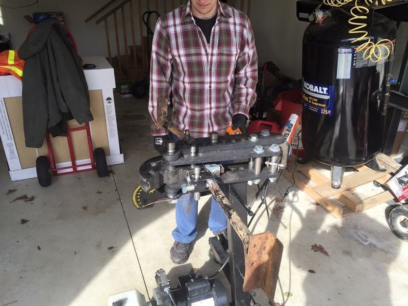

    Has some fun melting Craigs truck today. Also finally got around to picking up the bender. Put it to use the first hour brought it home, straightened out Craigs crossmember for the budbuilt skids. Then we did a turtle dance.

    Investing in a bender.. Cage soon?

    A couple of them actually. One for the taco and one for the runner. Plus I have a few side jobs to build some shit for a couple people. Can never have too many tools

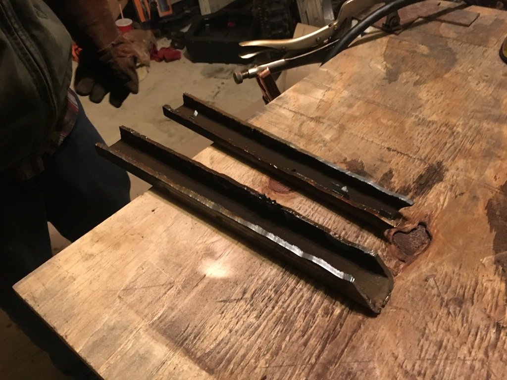

    Tack welded the studs finally...

    Ahh. I've thought about doing that as well.
    It's too bad they're bolts and not actual studs. It would be nice if they were pressed in like on a hub
  10. Feb 6, 2016 at 7:59 PM
    #790
    HomerTaco
    Mar 28, 2010
    #34129
    45,875
    HomerTaco
    HomerTaco
    HomerTaco
    Agreed. this was the next best thing. Like it wasn't hard enough to take the damn 35 off anyway... :rolleyes:

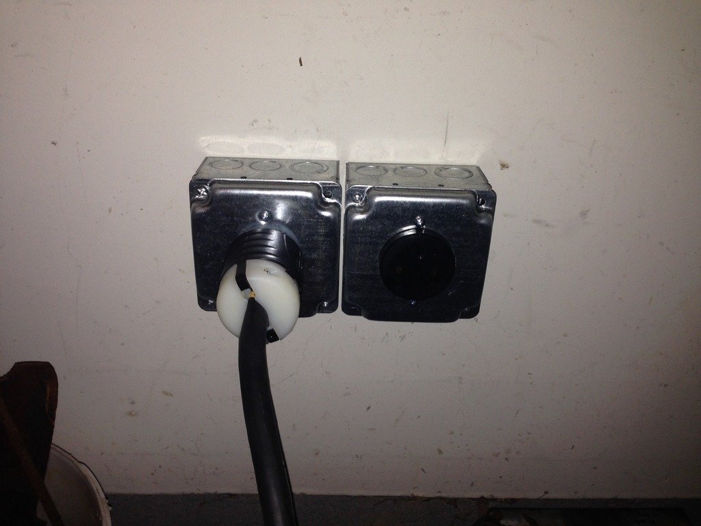

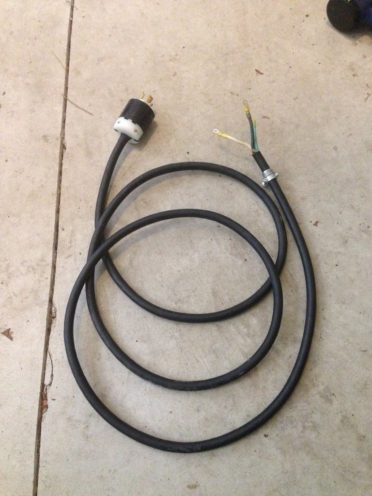

    Finished my compressor install this weekend. Made up a 220V extension cord.
    7E974824-DCC5-4068-B13F-DEBD0738C2B2_zps_cd8bb438f8dc2b8556005628aaae54bbb078249c.jpg
    Ran a 30 amp 230V line into the garage next to the welding receptacle.

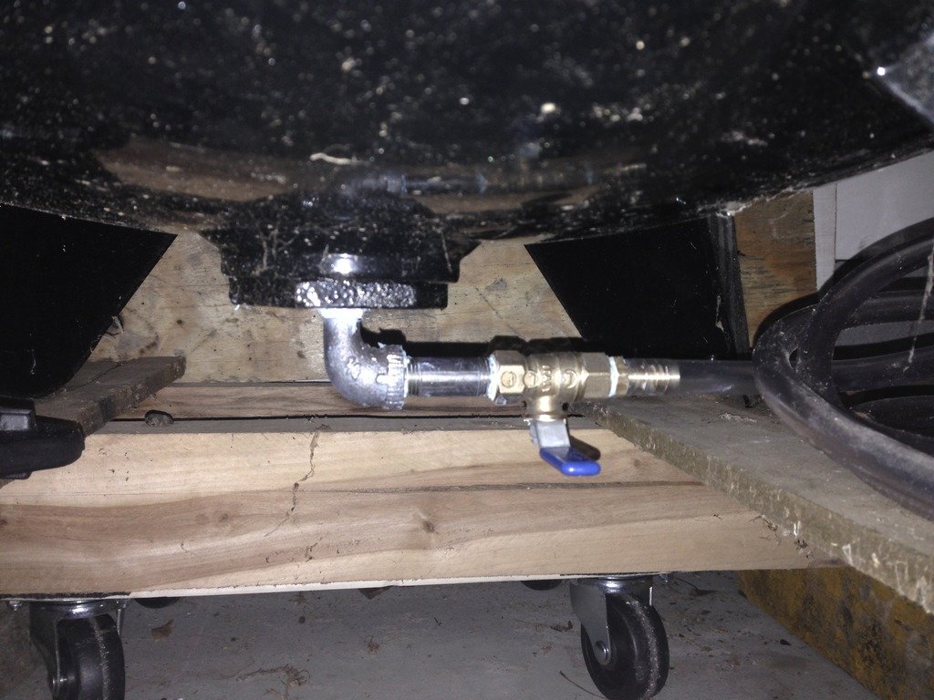

    Replaced the petcock with a nice ball style drain valve with some tygon toobing so I can blow it down into a bucket or outside

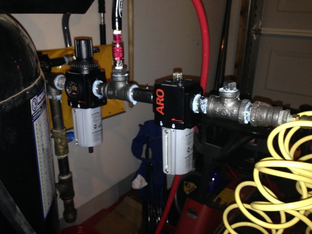

    Manifold is split into 4 different sections with several isolation valves. I probably over engineered the crap out of it but oh well haha. 1 section has 175 psi directly from the compressor, 1 has a regulated line I can set to whatever range I would need, the 3rd section is tapped off downstream of a filter/regulator assembly for dry air for the plasma cutter set to 90 psi, and the 4th is downstream of the lubricator for the air tools.

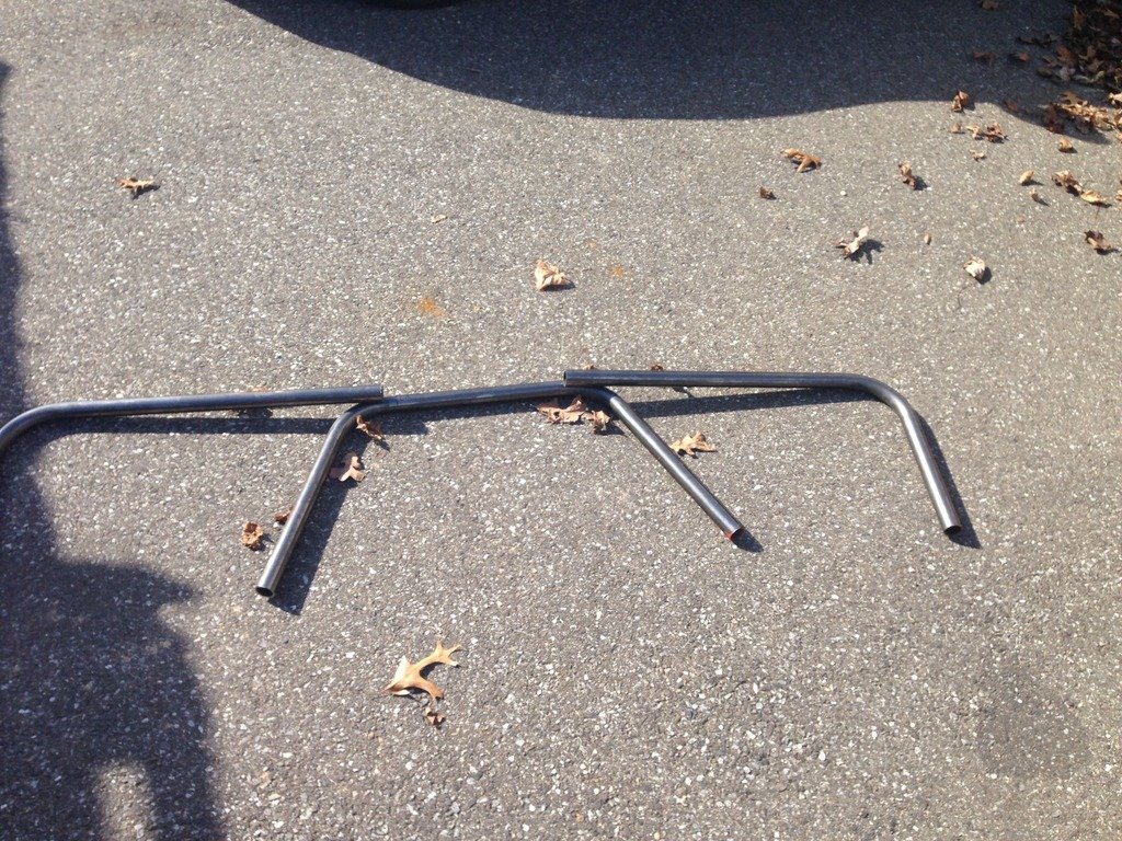

    Then Josh stopped by to drop off a soft topper and while we were BSing decided to make him some light hoops for his bumper. Just need to be trimmed and notched, they will be very similar to mine.
