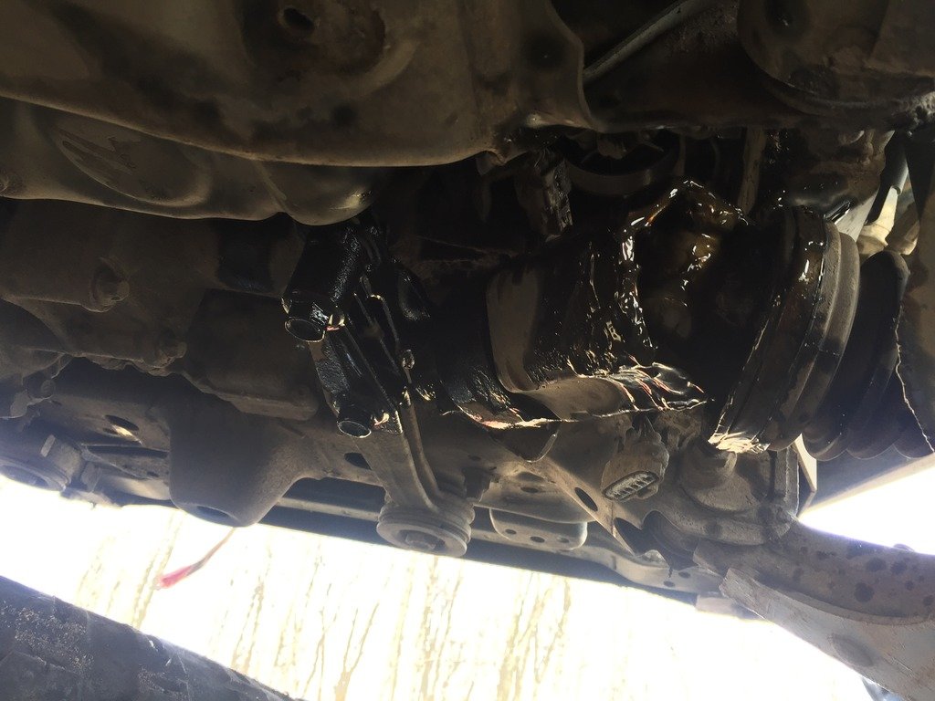

    Went to Rausch to do some wheeling this weekend, was a great time minus the carnage. Craig subbed his truck and blew his rear differential and I broke my front ADD tube.
    35s swallowed
    Ran yellow jacket backwards and got jammed up in a hairy spot. Compound low, locked F/R and skinny pedal and this was the result. We were able to make a trail repair to get the truck road worthy to make it home. More pictures of Rausch to follow once I get unpacked and relax a bit

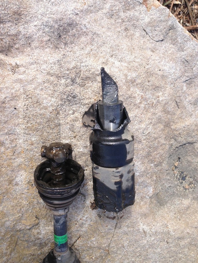

    Hm never seen a cv break there..

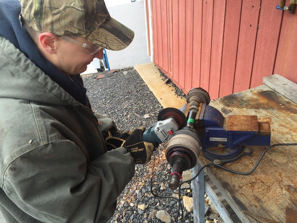

    Thats the differential tube extension, the CV didn't break. I cut the shaft off and reinstalled it in the hub so I could drive home

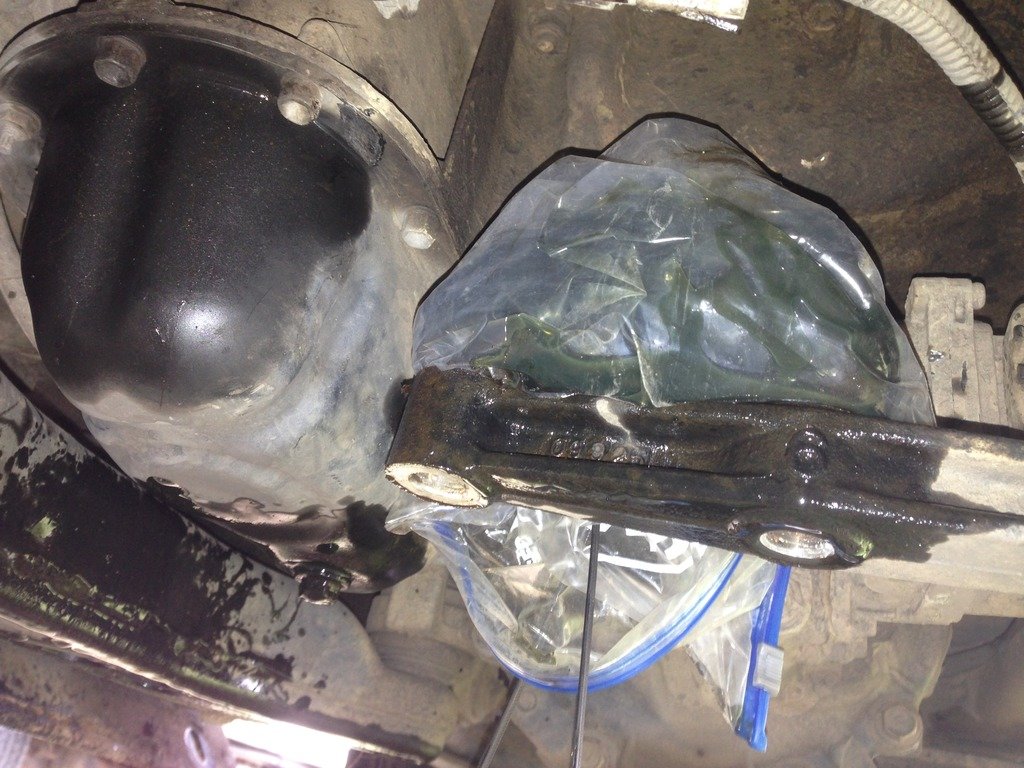

    So a new diff housing on the way I assume haha

    Yeah I will get one from the FJ cruiser without the ADD to simplify the system.

    Zip lock backs and zip ties ftw
