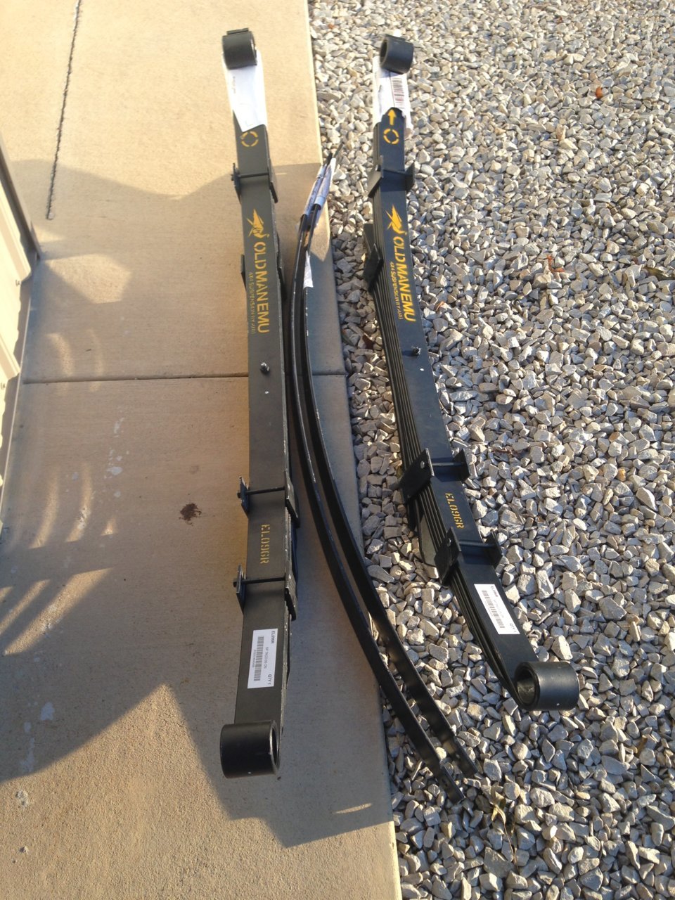

    Tonight was expensive night for me. After wheeling at AOAA heard some funky noises in the back of the truck, turns out the OME leafs were compressing so far the shackle was actually bottoming out on the frame. The springs are way past flat and beat. The Dakar leaves treated me well though; think I've had them for going on 7+ years now of nothing but abuse and wheeling along with a heavy rear bumper.
    Looks like they do not make the CS047R anymore, so I went with the EL096R with EL46XL AAL and energy suspension bushing kit. My old 3* axle shims from toyotech are also crushed I think they were aluminum. Hoping once the new bushings get here I can get rid of the factory front hanger bolt and replace with a greasable one so that I don't have to worry about the squeaking and seizing up nonsense. Going to get a new set of ubolts for the rear as well. Also ordered moar parts for the diesel :anonymous:

    you had OME this whole time?? surprised you haven't gone with a longer pack already...

    Your shims been crushed for a long long time though.

    Yep, they've treated me pretty well for all the abuse I've given them. If I start messing with spring lengths then I have to adjust shackle flip mount, don't want to go down that rabbit hole at this time. These dakars should last me long enough until it's time to get rid of leaf springs completely and put a real axle under this thing :D
    That's true, surprised they haven't just fallen out lol
    I've been very happy with the OME. I used to tow with this truck a lot more until I got the f350 and the dakars had no problem handling the weight even with a shackle flip. Towed my tractor and even a car trailer with that 4Runner on it a couple times.
    Never had any experience with deaver springs but they seem very overpriced for some bent pieces of metal. I think I'd have a local shop make me a set before I shelled out that kind of money. The Dakar came out to $550 shipped so the price was right for me. If you can get a used set that haven't been beat up it might be worth the gamble, but nobody around here I know has them so I have no real world experience with them, only Internet tales from others. Maybe they are worth it but I know for my shackle flip setup where I placed my hangers with a 4" shackle works great for the Dakar leaf springs and gives me a 45° shackle angle which is right in the sweet spot.
