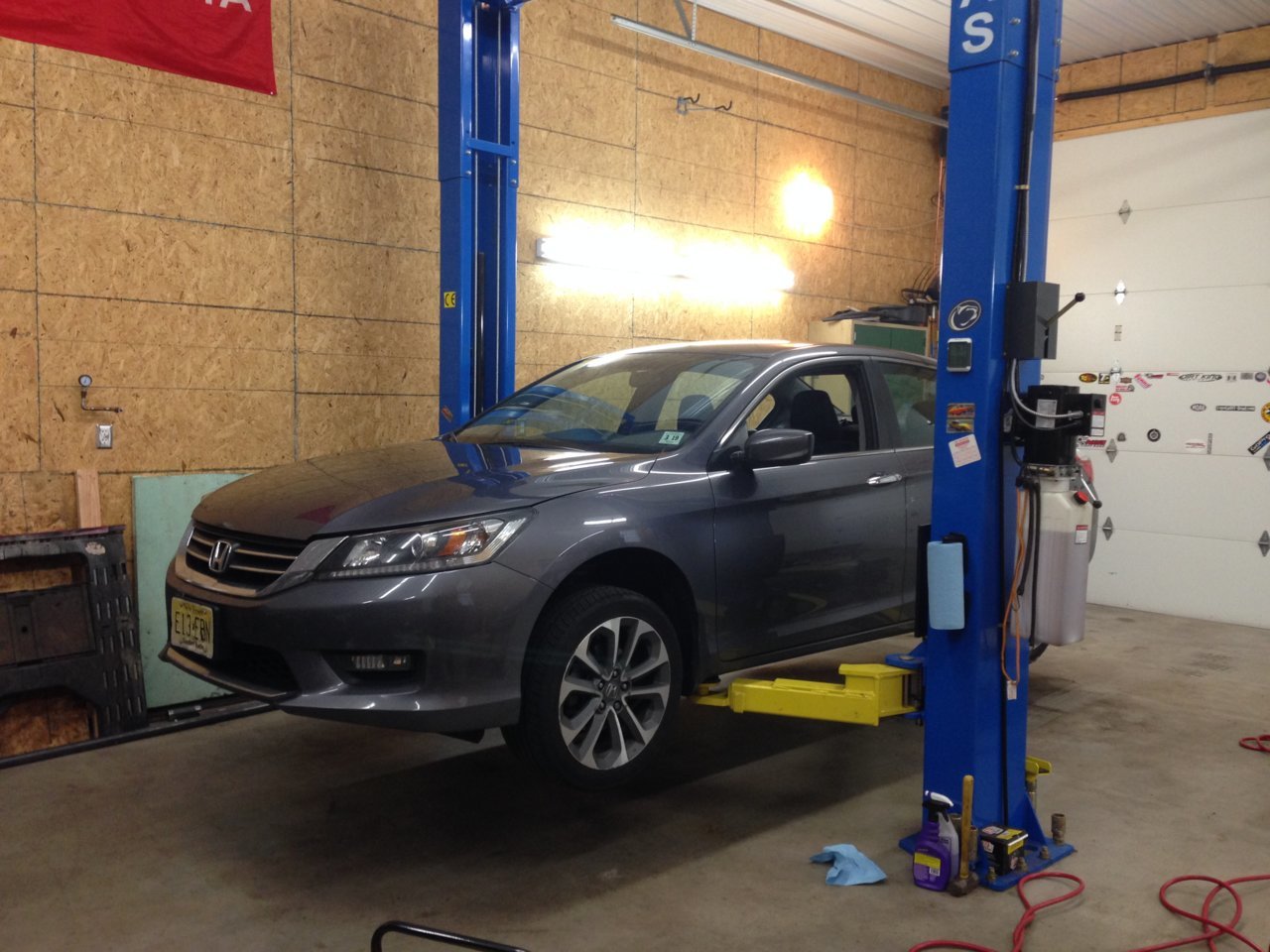

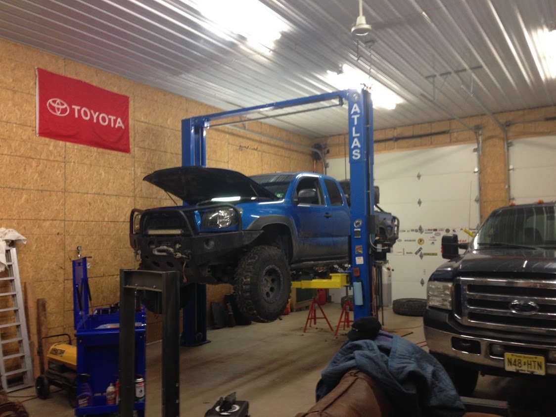

    This weekend I had another line of higher priority maintenance. Pumped glycol into the floor heating for the shop and fired it up for the first time this season. Then it was brakes and oil for my dads "dog catcher"
    Oil change and tire rotation for the daily beater
    Good thing now is the lift bay is free and I pulled the taco in and started taking it apart, perhaps next weekend I can wrap it up. This week will be busy with work and the turkey celebrations. Every Tuesday, Thursday, and Saturday's mornings are also taken up with pheasant hunting so I have much less free time to be messing with this poor neglected taco

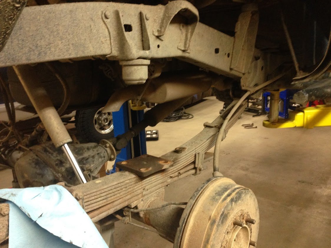

    Nothin too crazy. Replace leaf springs and bushings, axle shims, Ubolts
    My rear locker is stuck on too so I need to see what's up with that.

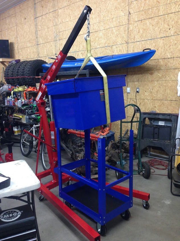

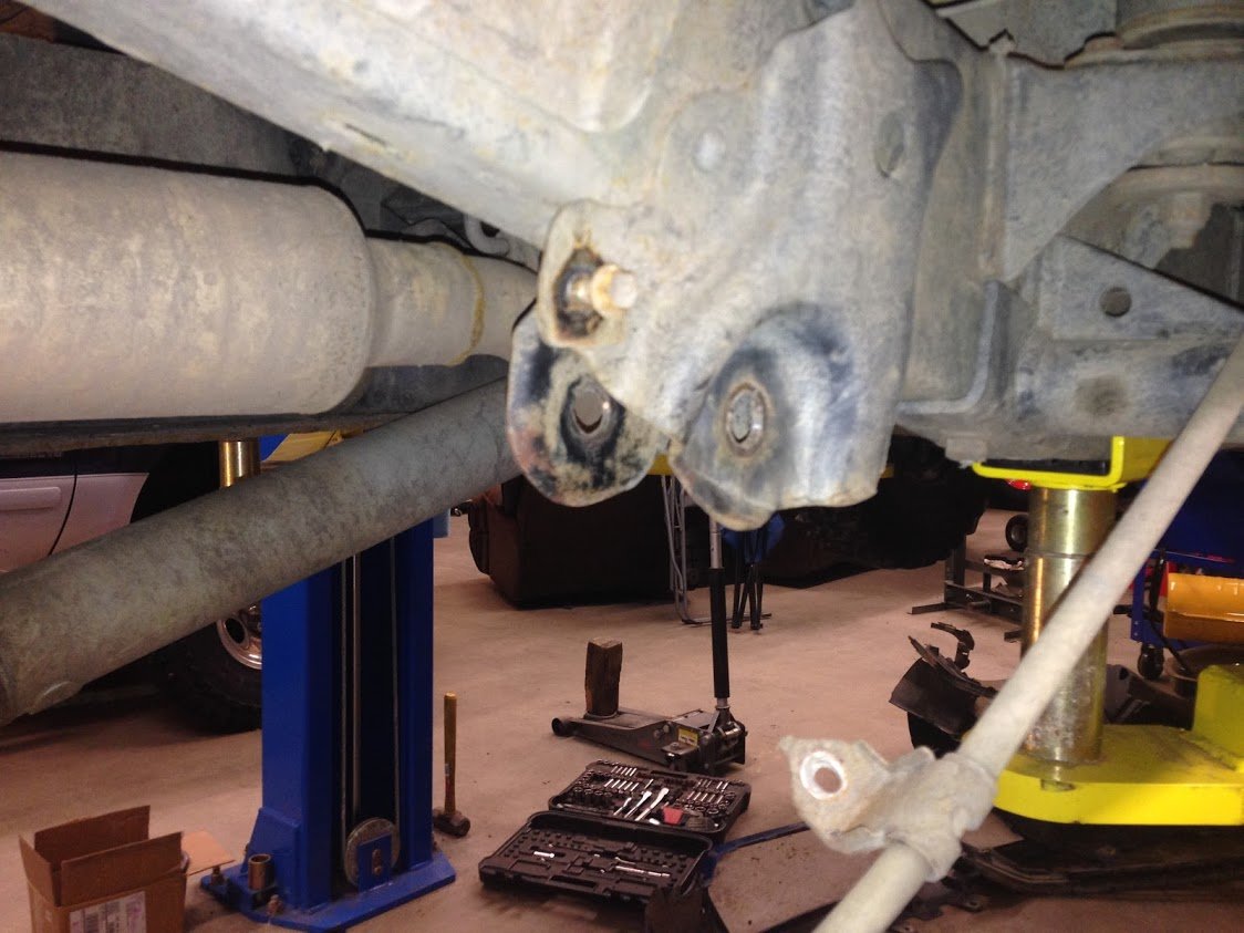

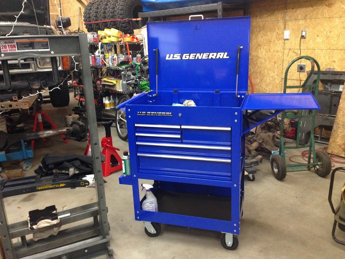

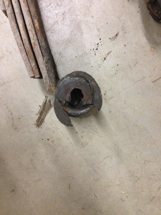

    Got a new mechanics cart for the shop, should make reaching for the tools i use most often by the lift easier rather than walking across the shop. HF box get good reviews from online and can't beat $180.

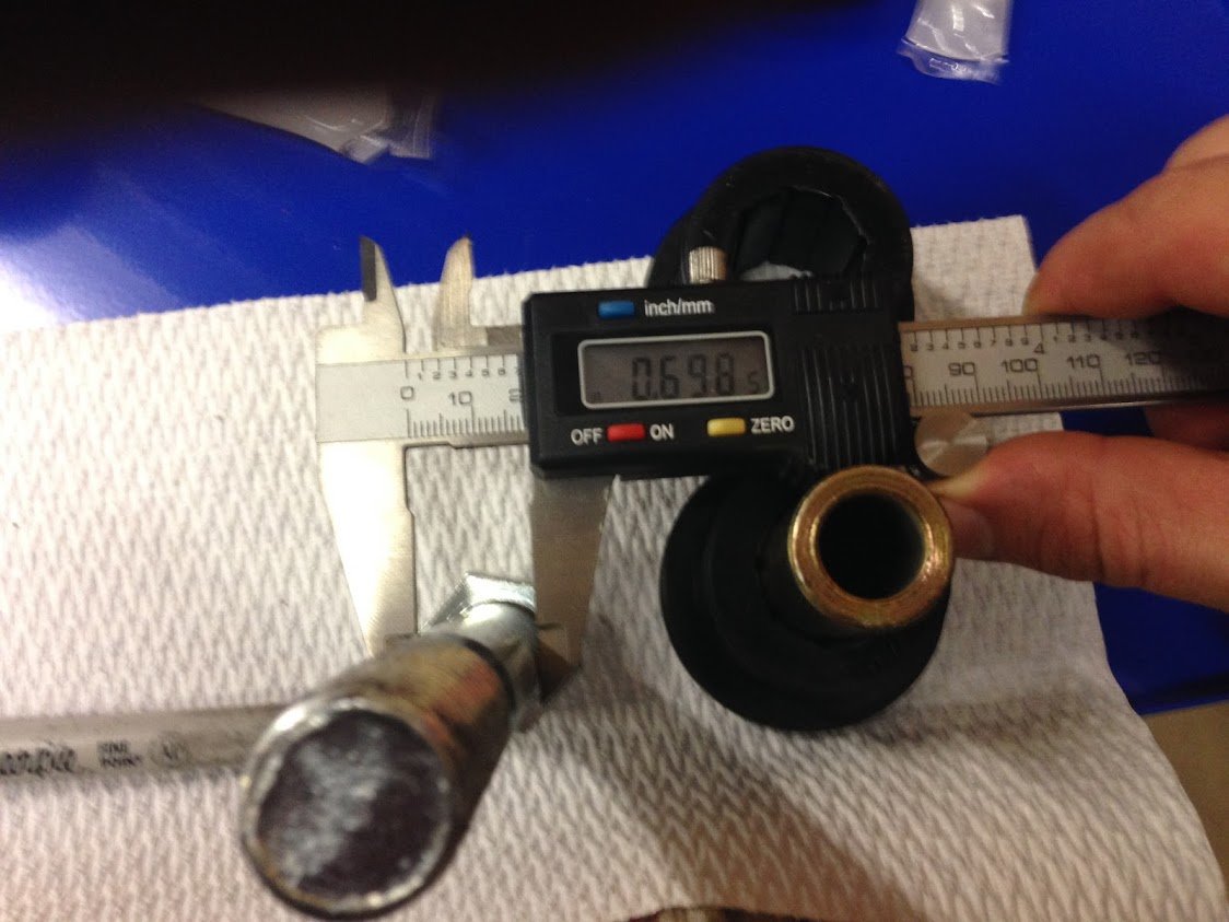

    Bushings out the wazoo, unfortunately none are the right size :bananadead:

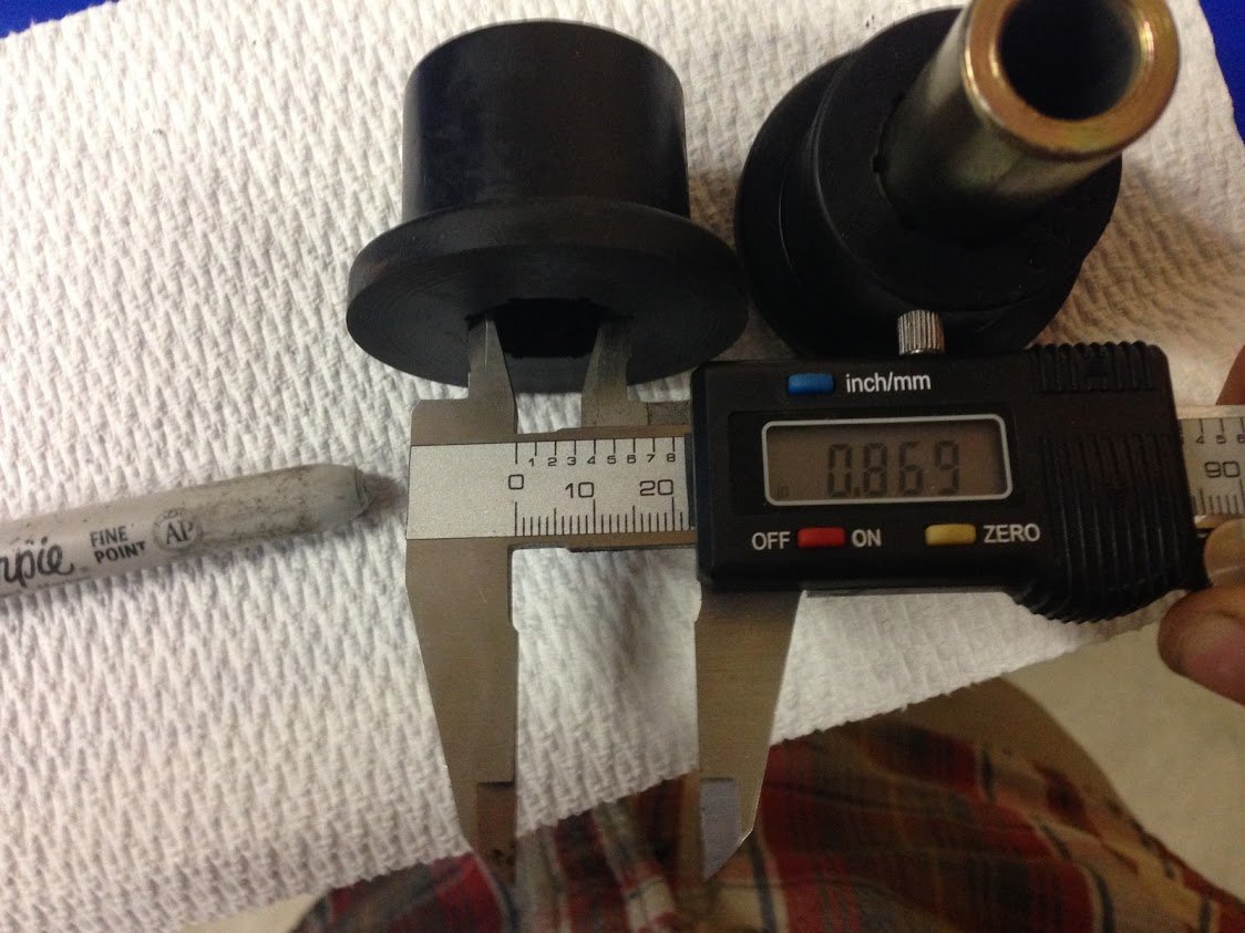

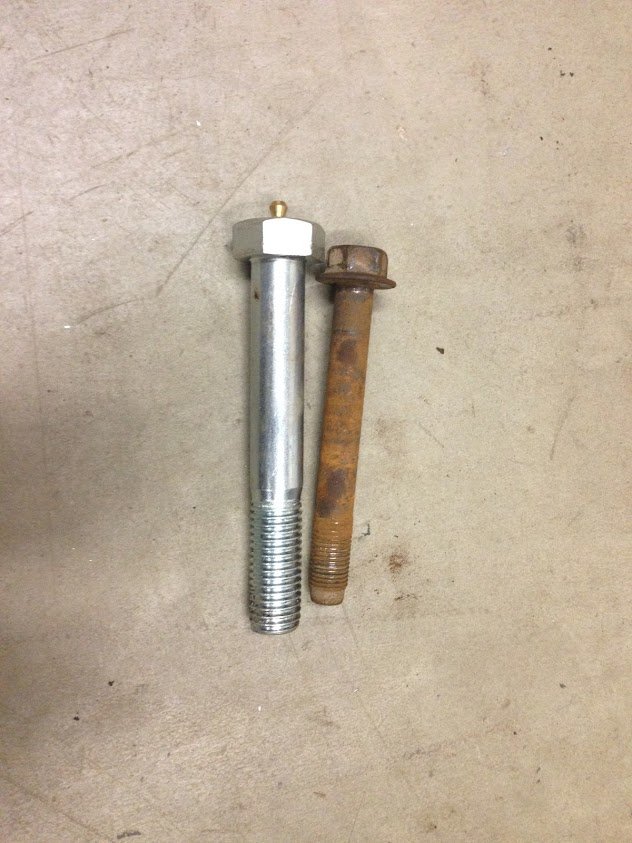

    I had a greasable shackle set up on the back I forget where I got the bushings from originally but the energy suspension kit ID is too big for the greasable bolts, and I threw away my OEM sized bolts years ago lol

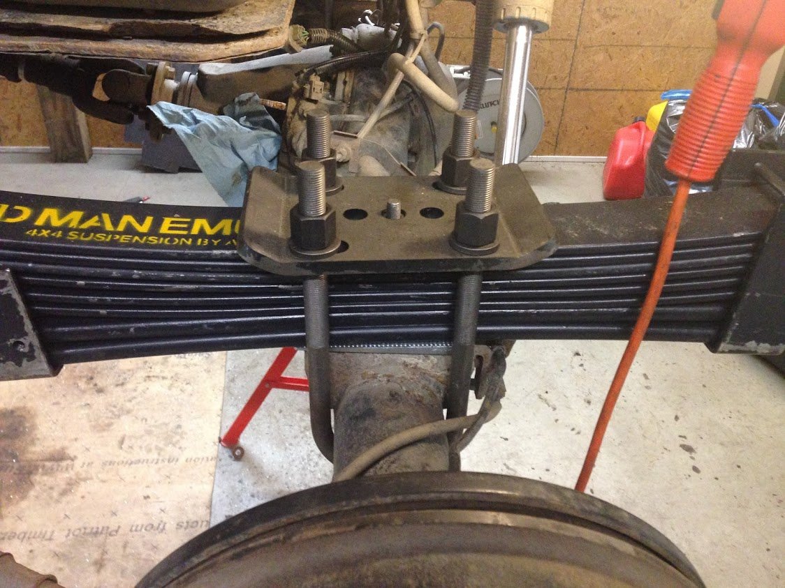

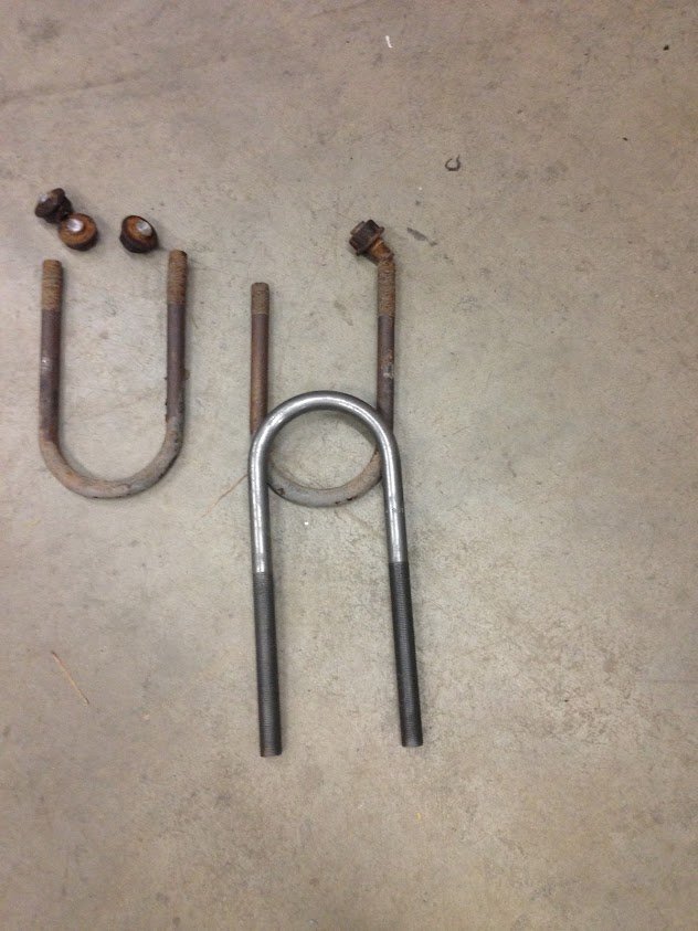

    Broke all the all-poo ubolts with the impact and breaker bar trying to remove, that was fun :rolleyes:. Going to replace all-poo with the ruff stuff 5/8" kit, mucho better

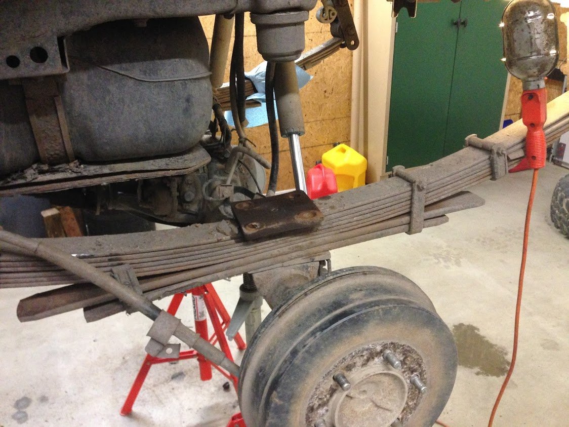

    Old leaf spring bushings look fine yeah? :oops:
    Dirty, rusty, crusty mess
    Energy suspension leaf spring bushing ID(0.869") is a bit too big for the greasable bolts
    Greaseable bolt OD (~0.7")

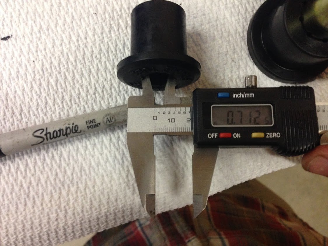

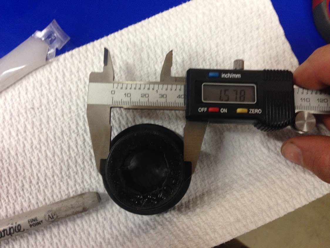

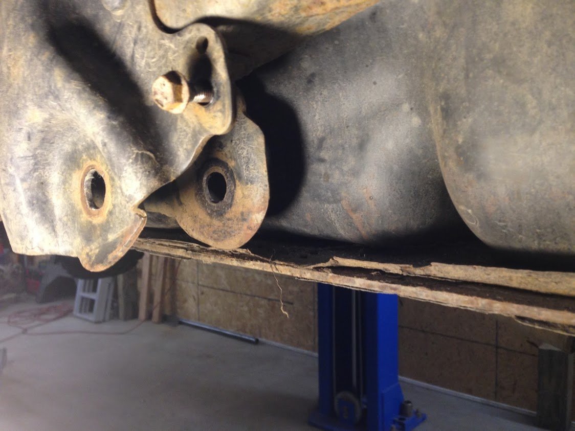

    My frame tube bushings are good but I need to find a leaf spring bushing with an ID of ~0.712" to fit the greasable bolts (below is the frame tube bushing)
    Energy suspension OD ~1.5"

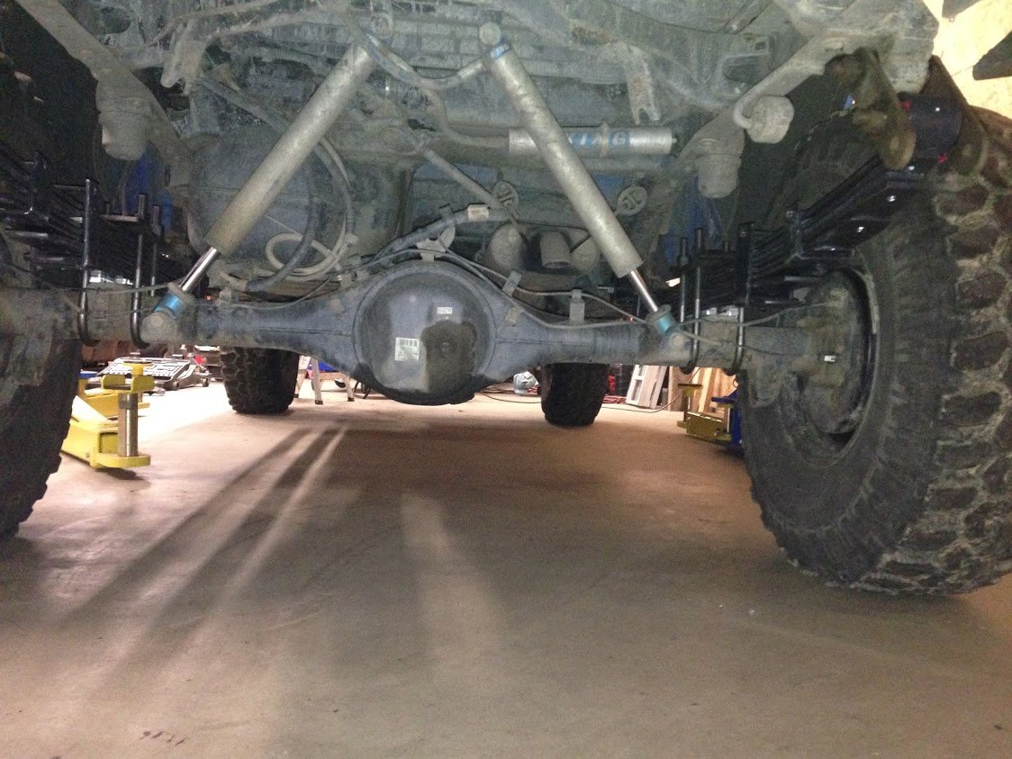

    At least I got the OME dakar AAL installed and all the old shit ripped out today.

    Thanks, I figure it'll serve me well. Easy to roll around to compared to the 44" box with the side attachment, that one might as well be welded to the floor lol
    I think yeah the 4 drawer was $109. That design is a little different than the 5 drawer, the one I got seemed to get really good reviews so I figured it was worth a shot.

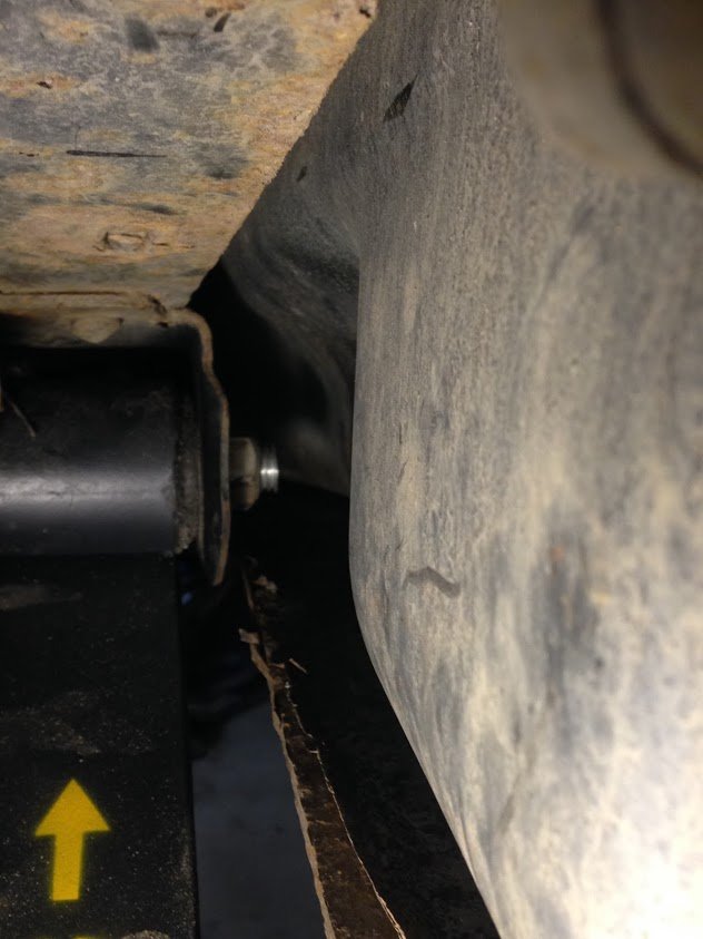

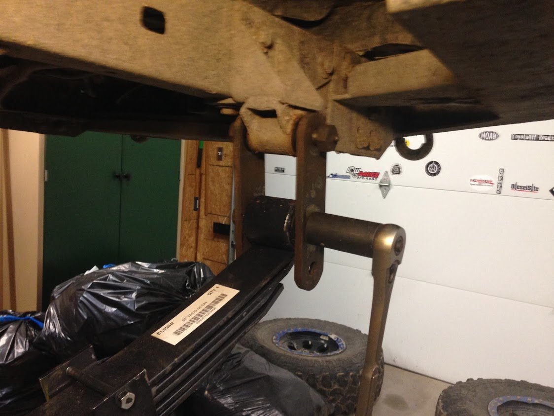

    Made a little more progress tonight. Got the new bushings in the leaves and then installed them, greased everything up including all the driveshaft u-joints. Dropped the gas tank skid to trim it up, of course 2 of the 4 studs snapped so I'll have to fix that at some point. Maybe tomorrow I'll take a look at the locker, I pulled the old actuator off tonight and it looked ok from the outside but I will test it when I have more energy.

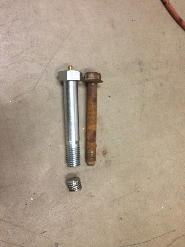

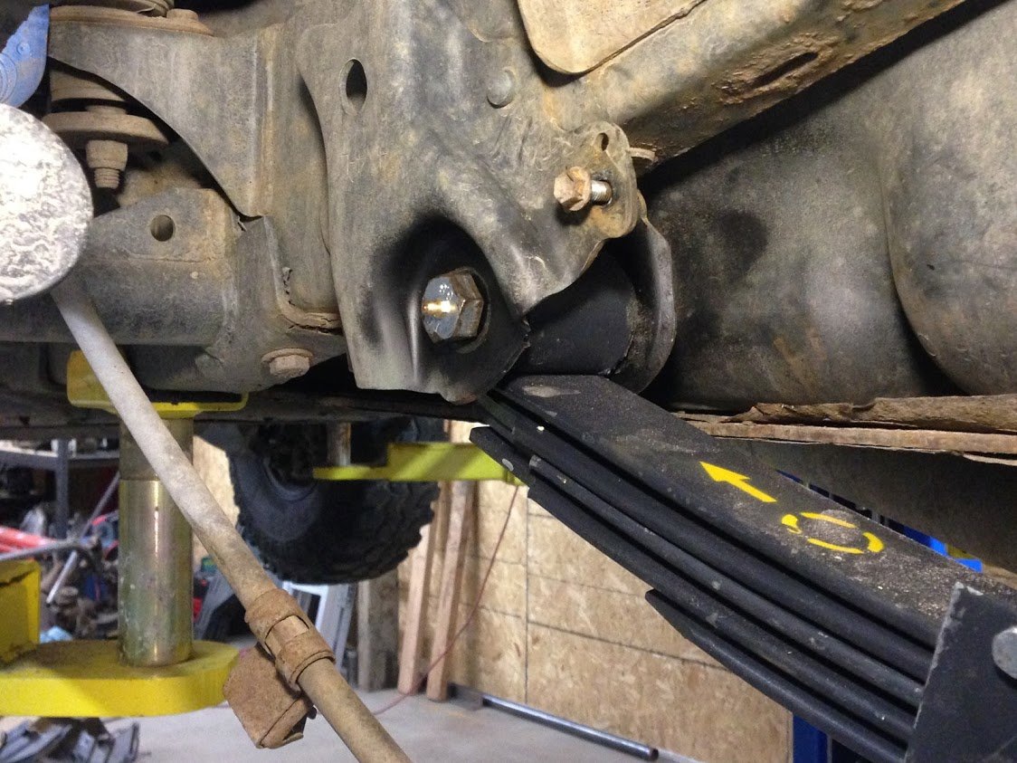

    OEM front bolt compared to the greasable bolt, quite a bit beefier.
    Had to enlarge the front hanger bolt hole a bit to accept the new bolt

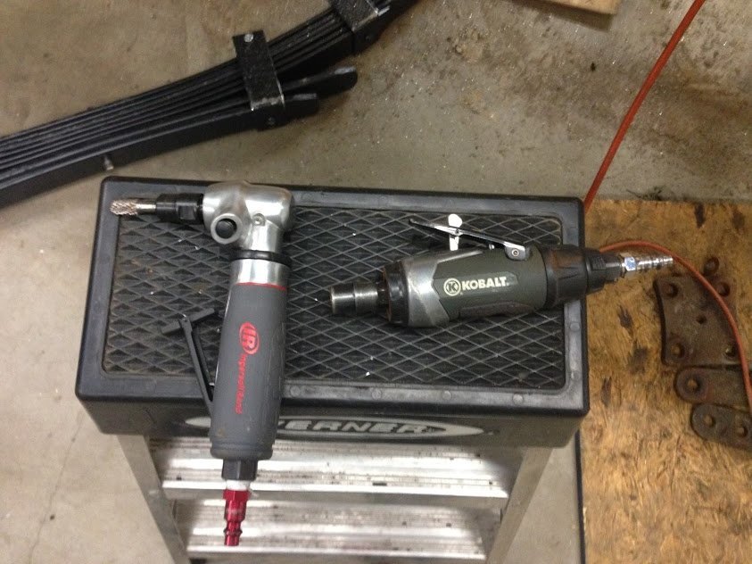

    Weapons of choice

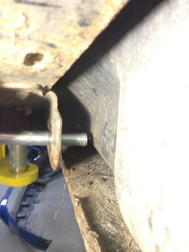

    I didn't like how close the threads came to the gas tank
    Trimmed the end off a bit
    Looks better
    New ubolts in, will have to trim the extra length off the threads
    Shouldn't ever have to worry about a seized front bolt again :D
