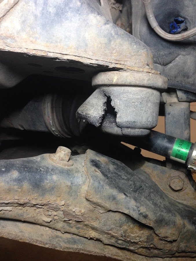

    Fixed a CV axle leak I had earlier today that one of the clamps came off. Noticed that my front wheeler's superbumps are decinigrating lol. Maybe try the plastics guy duro bumps this time around. Anyone have any feedback good or bad on them?

    I ditched my superbumps in the front for duro bumps. Same issue. After a while, the superbumps were disintegrated. I only swapped them in November, but, so far so good. Let me know what questions or info you have. Here is a little post I did:

    I have the DuroBumps. I like them but I went from stock to those so I can’t compare.
    I know @Arcticelf has them and has really hammered them.

    I switched from super bumps, to the durobumps, and they are wildly better. Hit em hard enough and you can feel the dual durometer .

    Thanks fellas, that makes the decision easy then. Durobumps it is, going to place the order this week. Hopefully that front bumpstop allen key doesn't give me too much troubles on removal!
