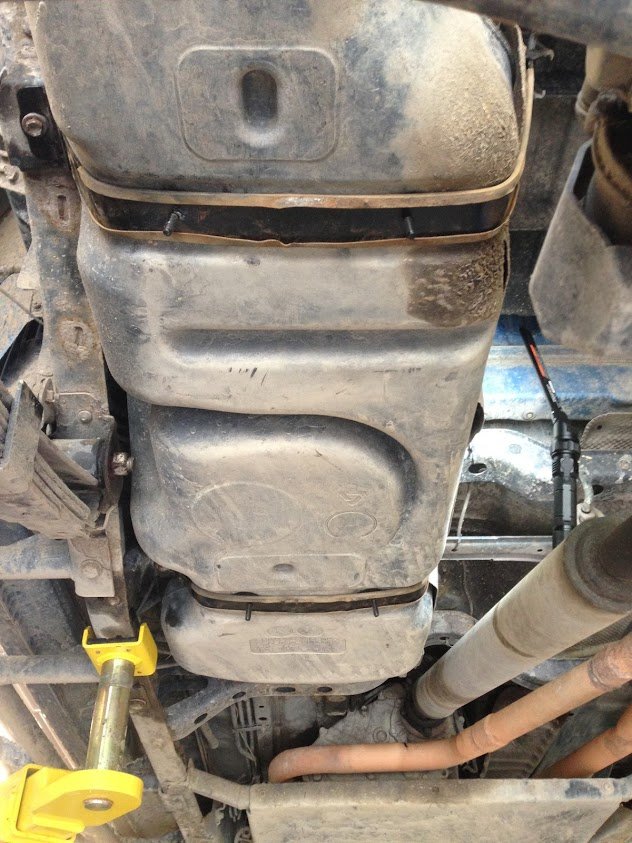

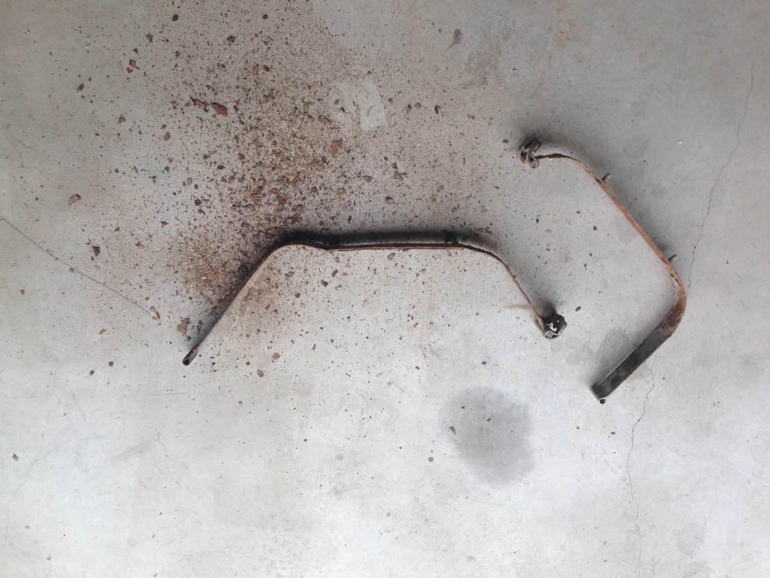

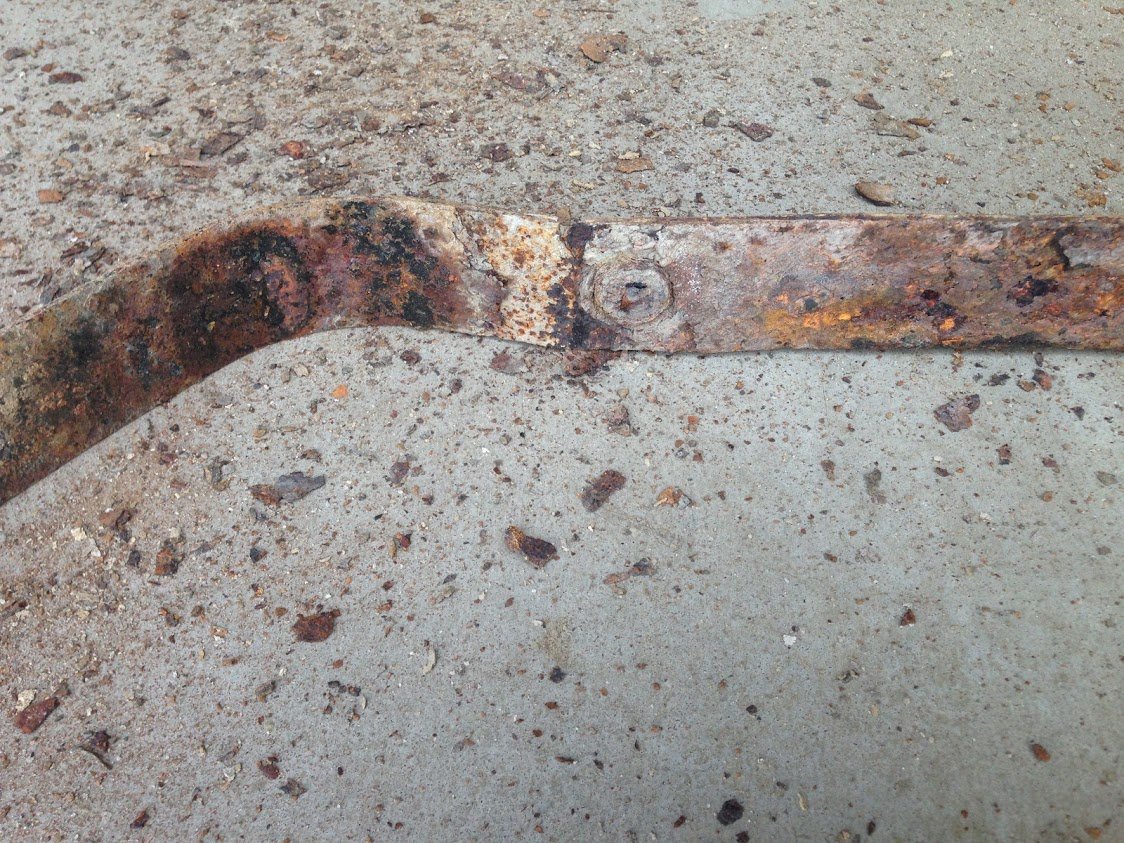

    Finally got around to replacing my gas tank straps. OEM one broke when I was removing the skid months ago, the little teets broke off the strap. Ordered
    LILAND GLOBAL IST323 from rockauto, price was right. Good thing I replace them, 9 years of hanging out and supporting a 3/16" skid plate took its toll on the thin metal.
    I transferred the rubber pads to the new straps, swap took about 10 minutes I was shocked all the bolts and pins came loose lol

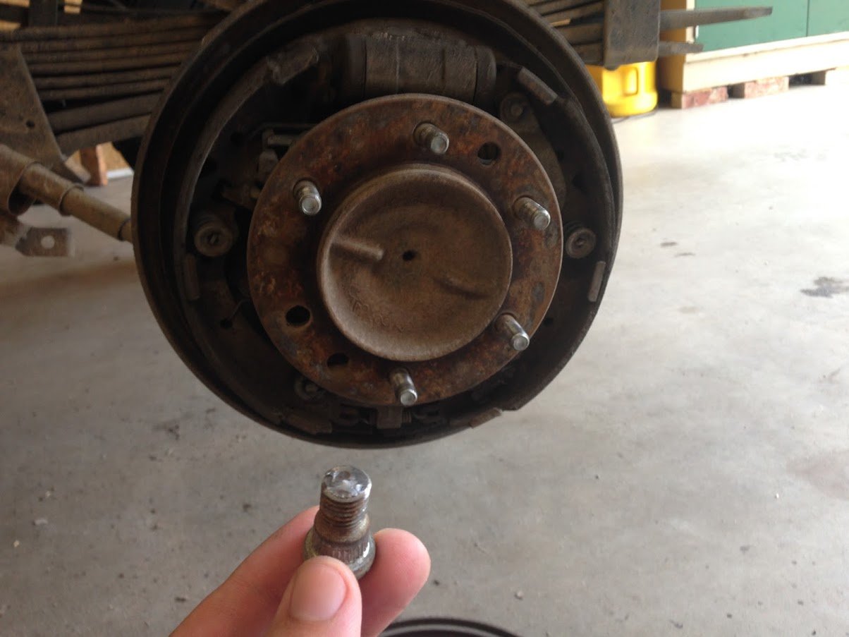

    A few weeks ago I had my drivers rear wheel come loose again (almost lost the same damn wheel going to URE back in 2014). Not sure why, I torque the lugs whenever I have the wheels off, and this was the only 1 of the 4 wheels to come loose, all the others were torqued to spec still. Maybe somebody is trying to kill me and loosening up my lugnuts when I'm not around haha; anyhow, I go to check the wheel for damage today and one of the studs broke off in the lugnut (presumably from the threads getting buggered up from being loose); so I went to vato zone and got a few spare studs to keep in the back cubby in case of another hiccup with them.

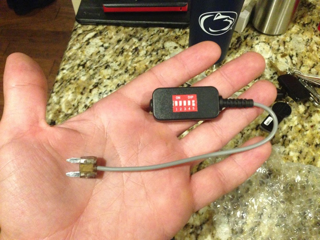

    Maybe this weekend I'll remount the skid plate. Also going to install this little doo dad to bump up the alternator voltage for the AGM batrees
