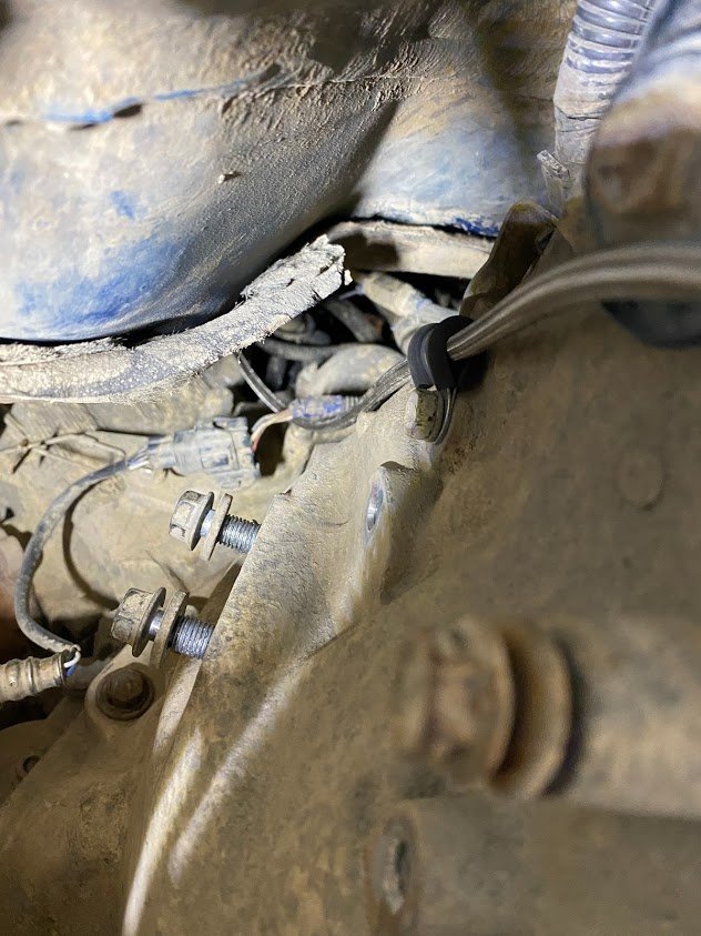

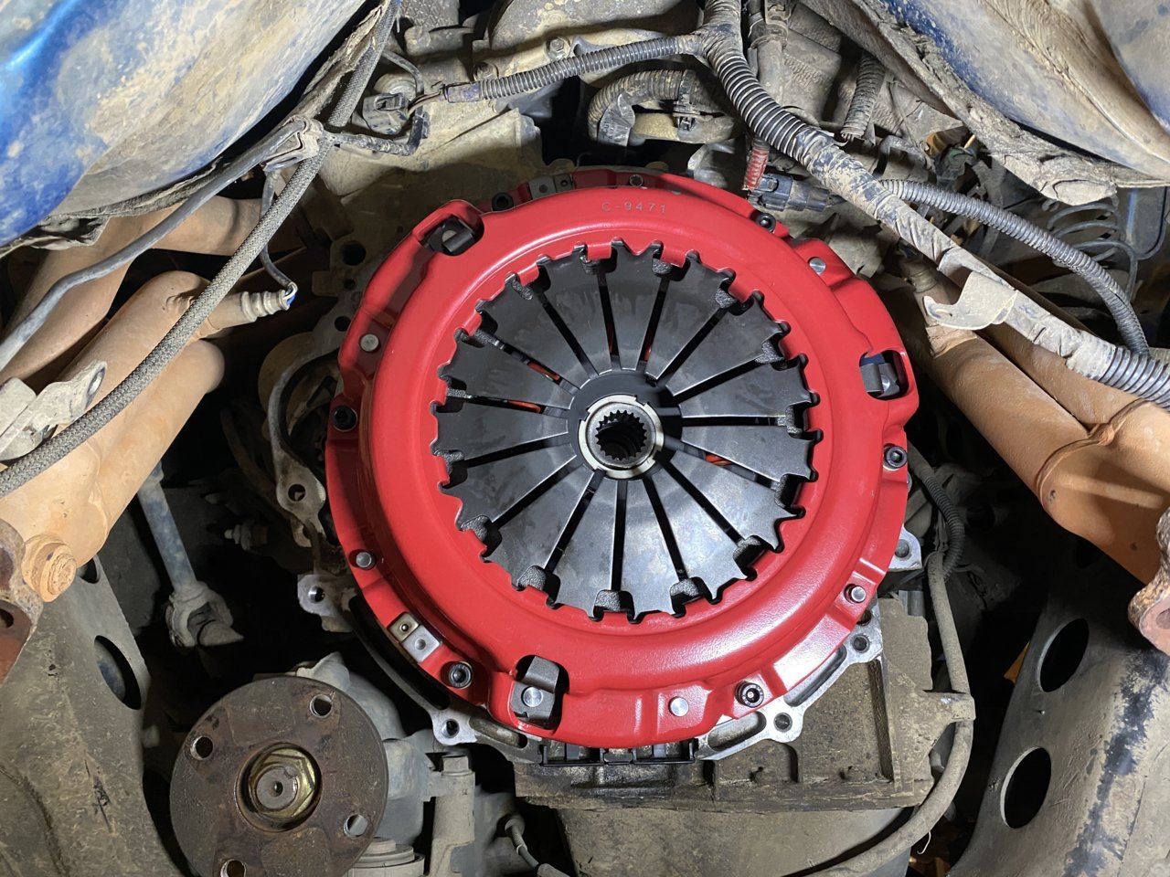

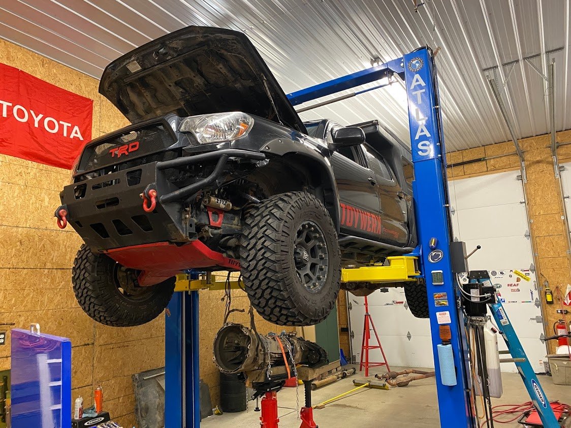

    Well, some more forward progress tonight anyhow. Flywheel and clutch are in

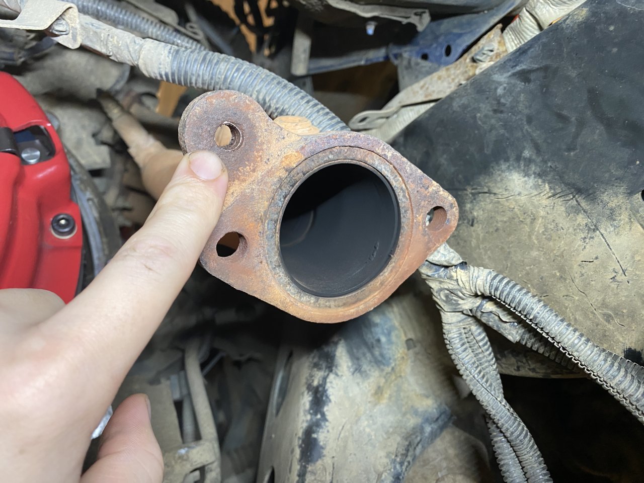

    drilled out the bolt that snapped for the exhaust manifold support

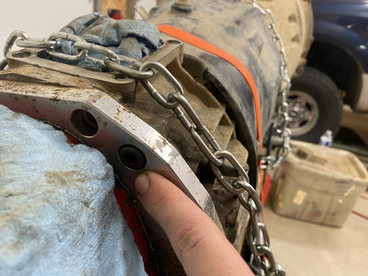

    these two cap head screws were stuck in the transmission housing. Turns out steel bolts don’t get along very well with aluminum. Fought with them for an hour getting them out, retapped the threads in the transmission and ran the bolts through a die, then reinstalled with lots of anti seize. 0160110E-B16D-448A-9F24-54DCE3E58709.jpg
    at this point the transmission is ready to put back in and then reconnect the shifters and driveline. Hopefully tackle that this weekend.

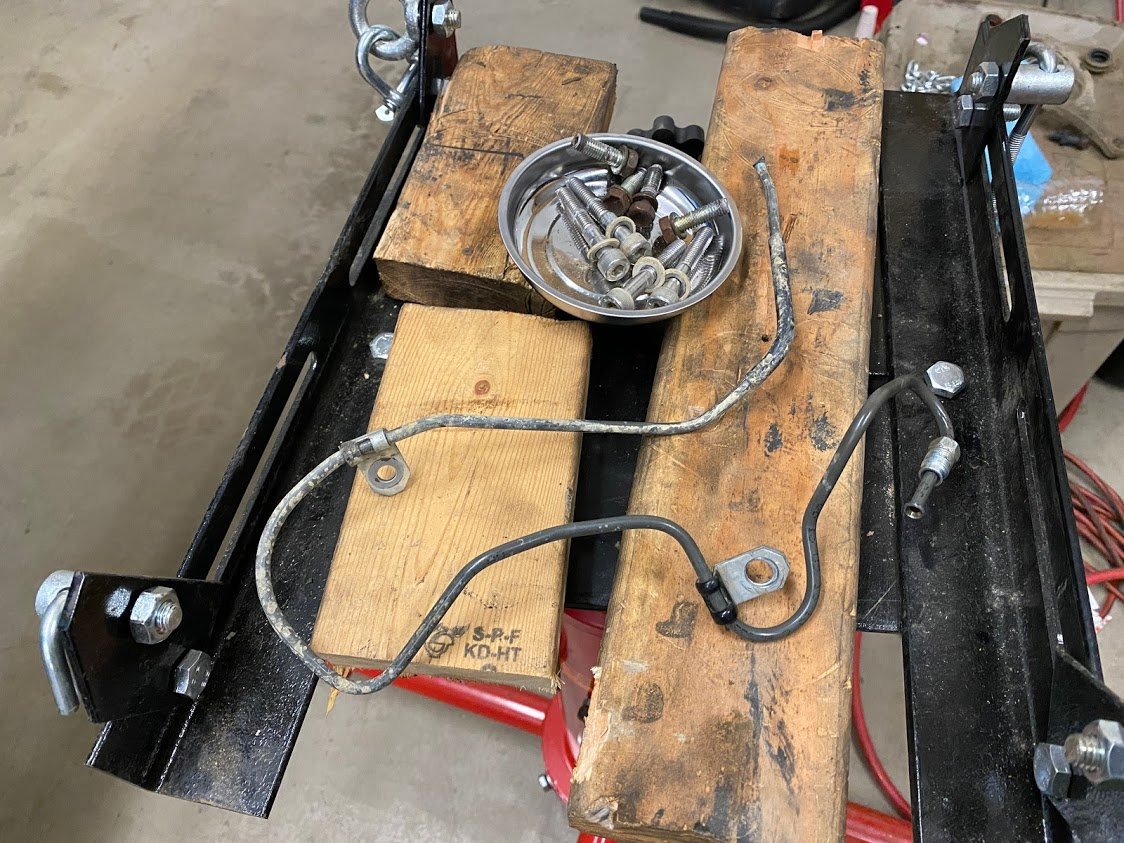

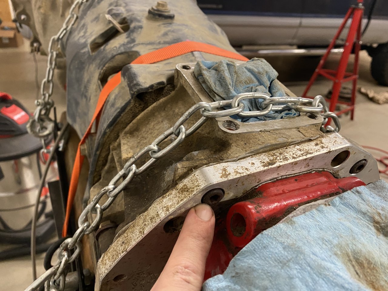

    Got a bunch more progress done on the truck this weekend. Really only worked on it for a few hours saturday and I'll be travelling for work this week so hoping to have it wrapped up next weekend and ready to drive again.
    Drivetrain is re-installed.
    wiring harness re-routed and all the connectors are plugged in
    Transmission, crawl box, and t-case oil is changed.
    Shifters are re-installed in the cab
    Cross-member is bolted back up
    New slave cylinder is connected, clutch fluid is flushed and bled.

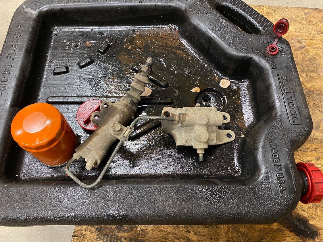

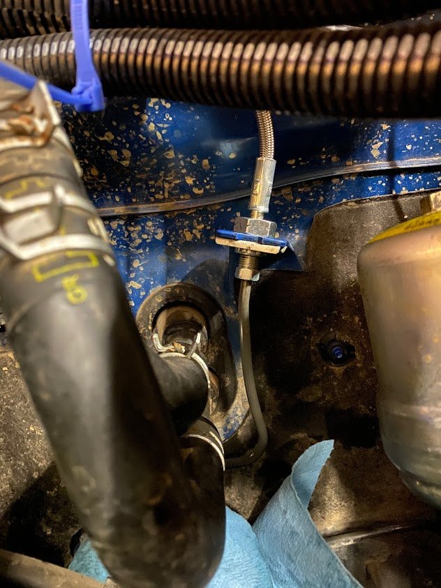

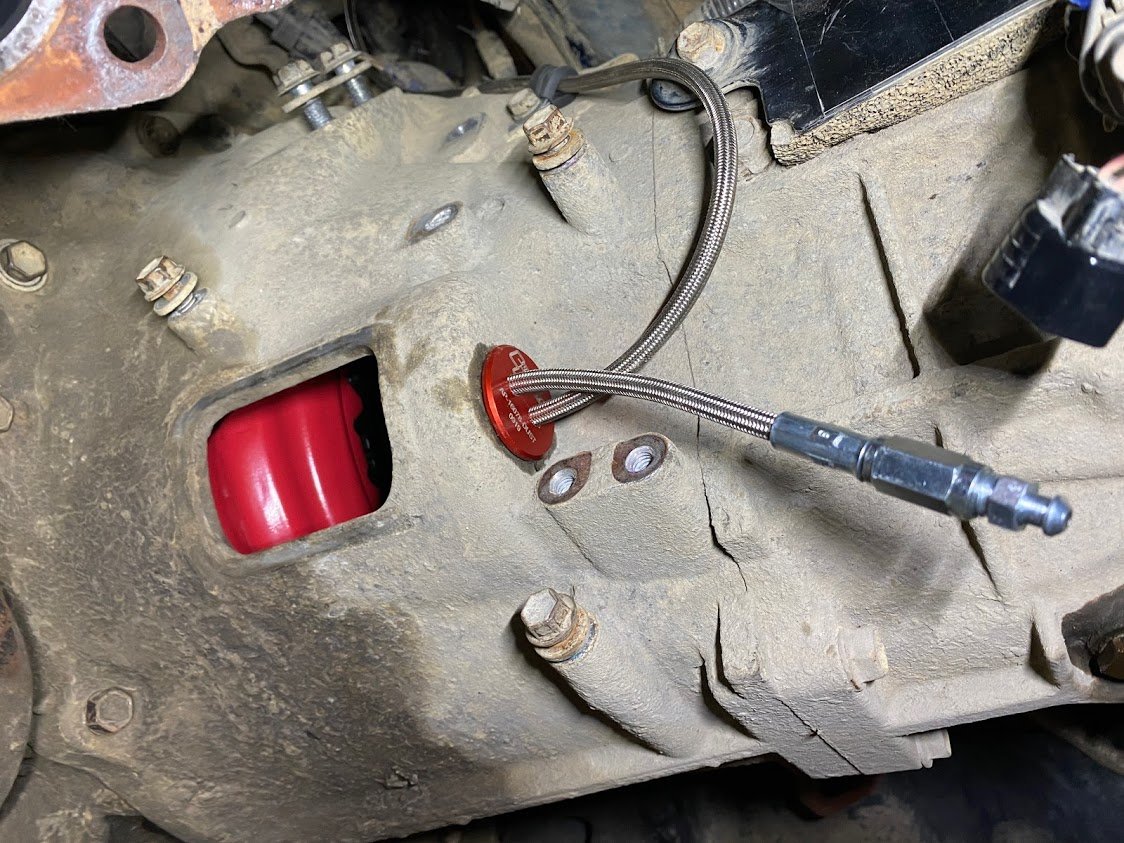

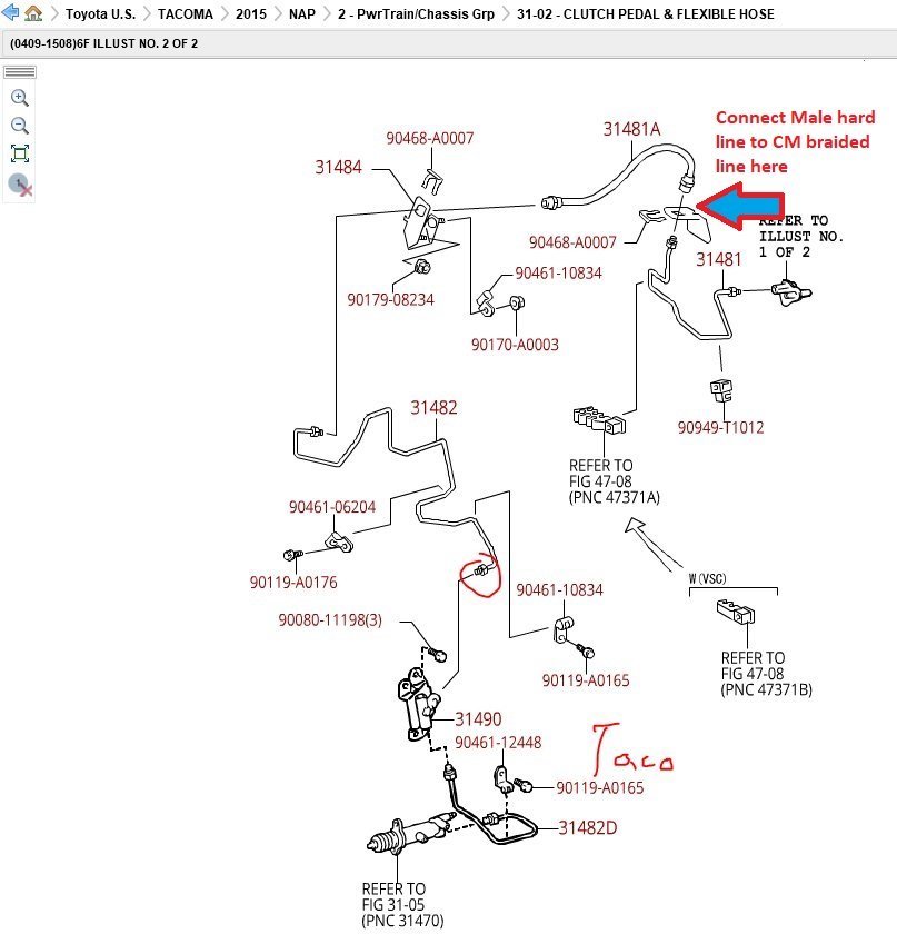

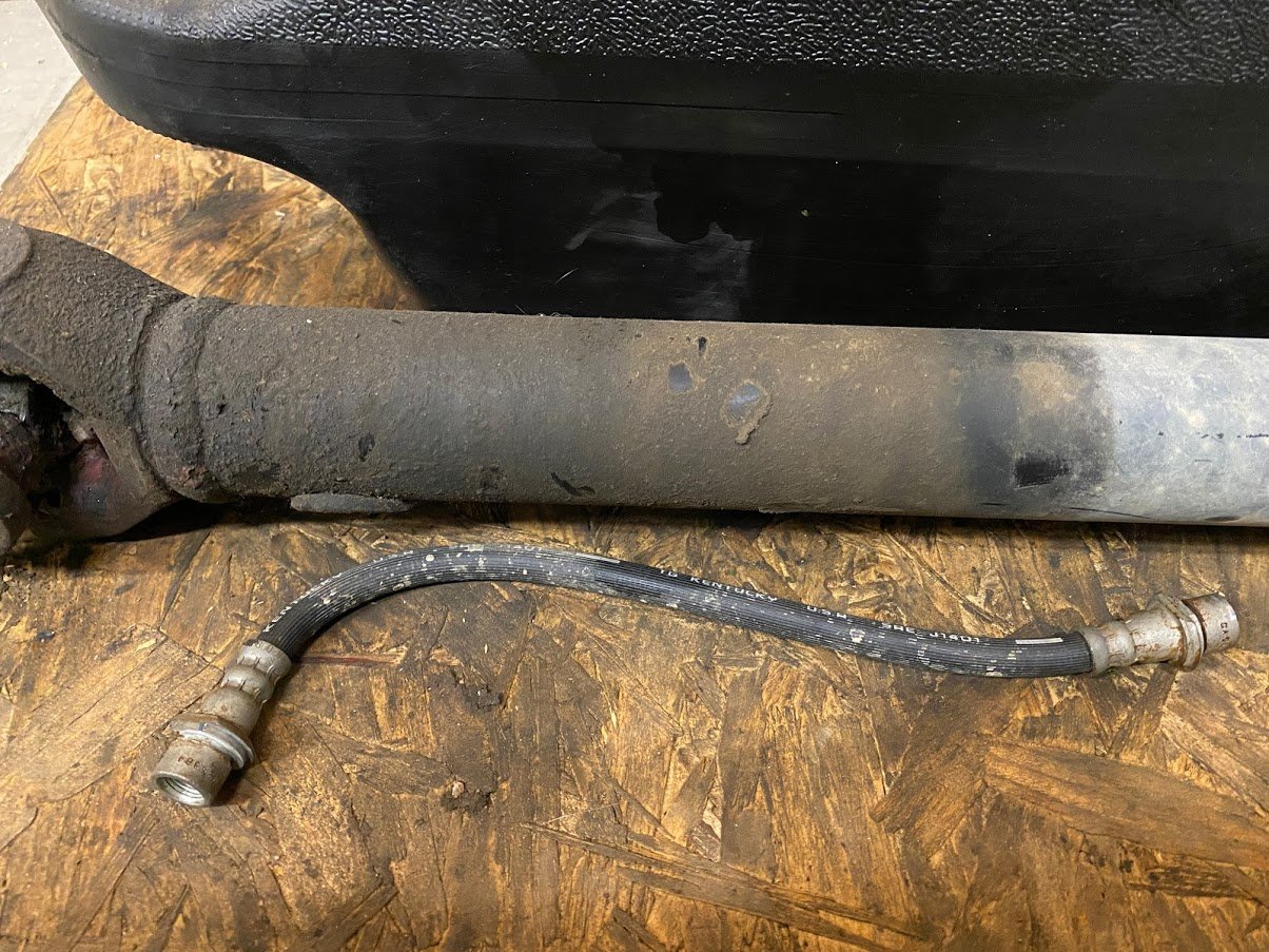

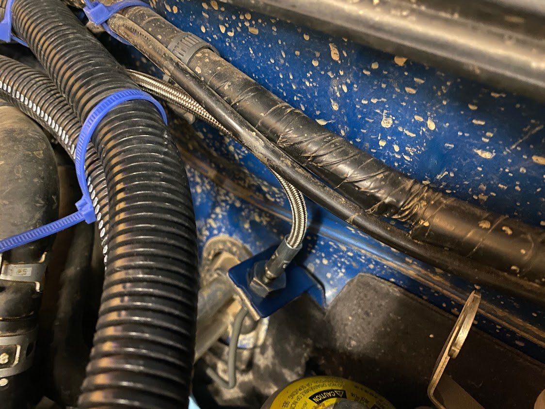

    For anyone with the 6-speed, I'd highly recommend this upgrade over the stock setup, seems to be very good quality. Time will tell once I get some mileage under my belt, but all the reviews I've read says this kit is superior to the OEM setup. I was also able to eliminate the clutch accumulator along with a bunch of unnecessary tubing going from the clutch reservoir to the slave cylinder (rubber hose and long bendy hard line) so it cleaned the engine bay up a bit back by the firewall.
    New line from the fire-wall down to the transmission:

    Busy busy. Is it the accumulator delete kit they have talked about on here? Or are you referring to the upgraded clutch assembly?

    There is an accumulator delete kit you can purchase that will connect right at the stock slave cylinder (think it's around $75 for that line). Link is here
    https://www.tacomaworld.com/threads/mt-accumulator-delete-mod-adm-and-bs-thread.568303/
    The benefit to getting the clutchmaster slave cylinder setup is that you are are able to use their line they provide to delete the accumulator, so it essentially kills two birds with one stone.

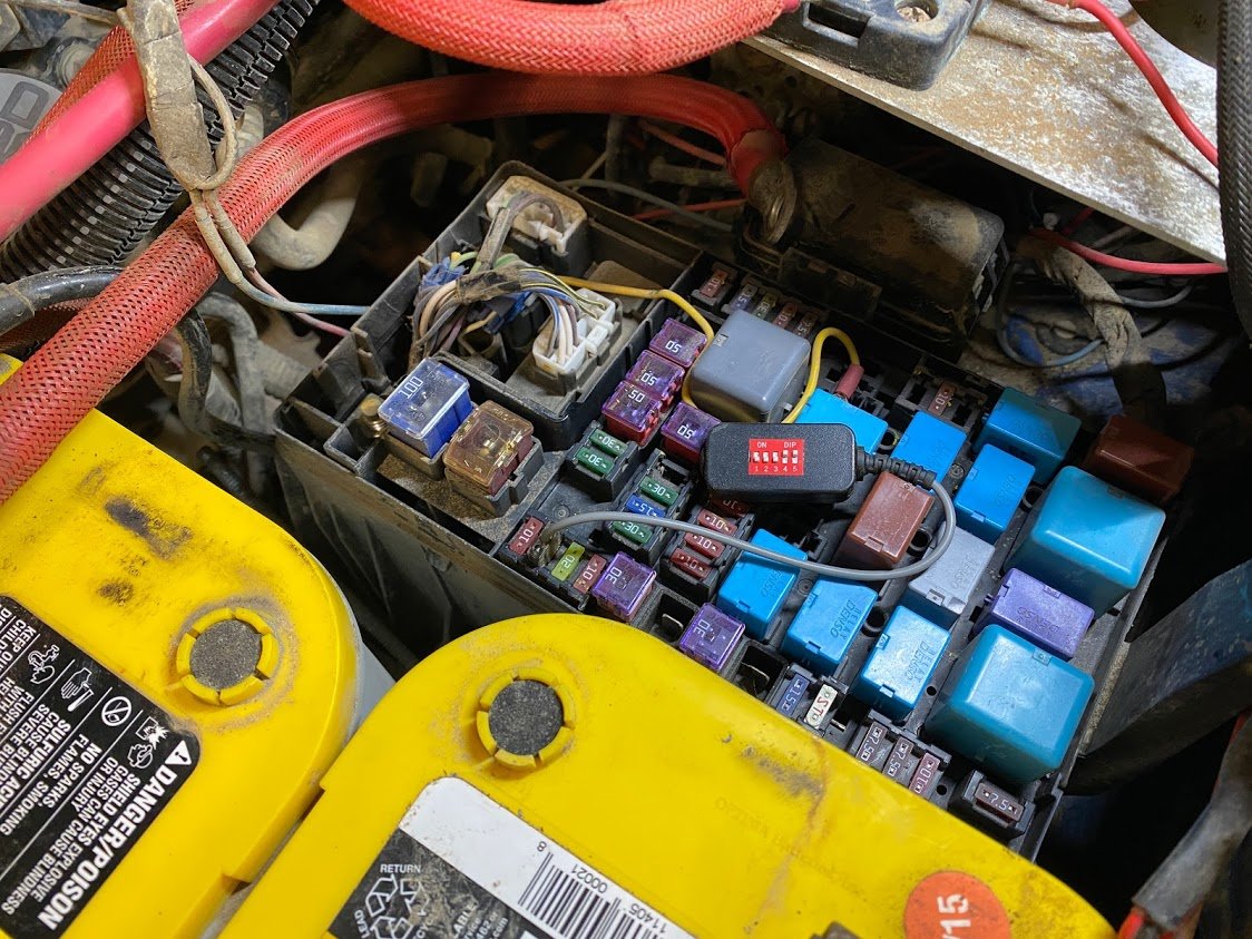

    Got the truck finished up Friday, drives great. Also got the gas tank skid back and re-installed, then Saturday we did Craig's slave cylinder.

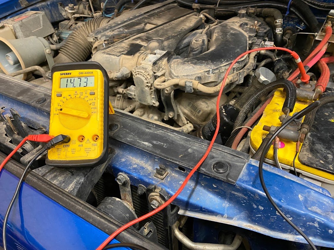

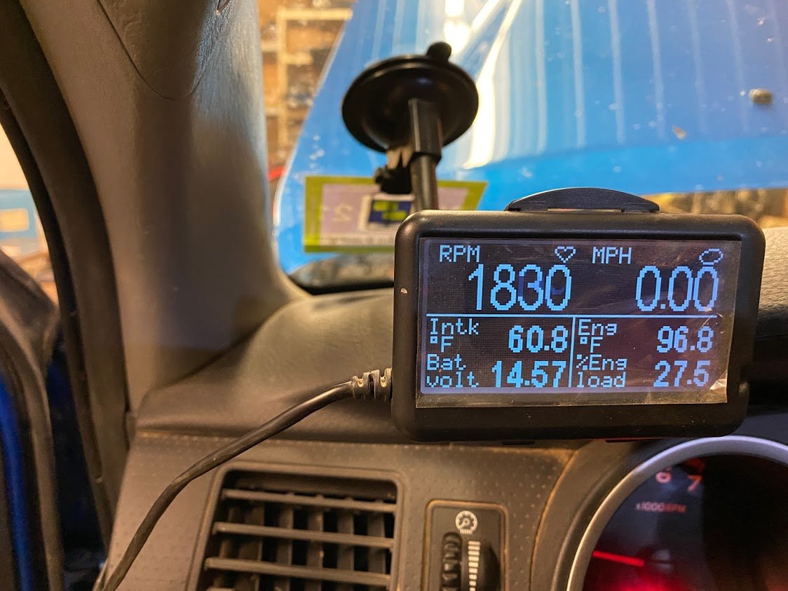

    Today I got the HKB voltage booster installed, happy with the new alternator output, should keep the yellow tops filled up a bit more.
    Next up is troubleshooting my drivers front wheel speed sensor, installing URD 160 degree thermostat and associated coolant change, install dual voltmeter in the old ADD switch position, and order some new bumpstops due to the wheelers ones being dry rotted.

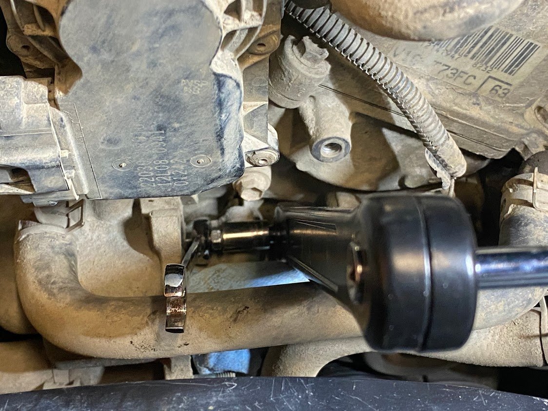

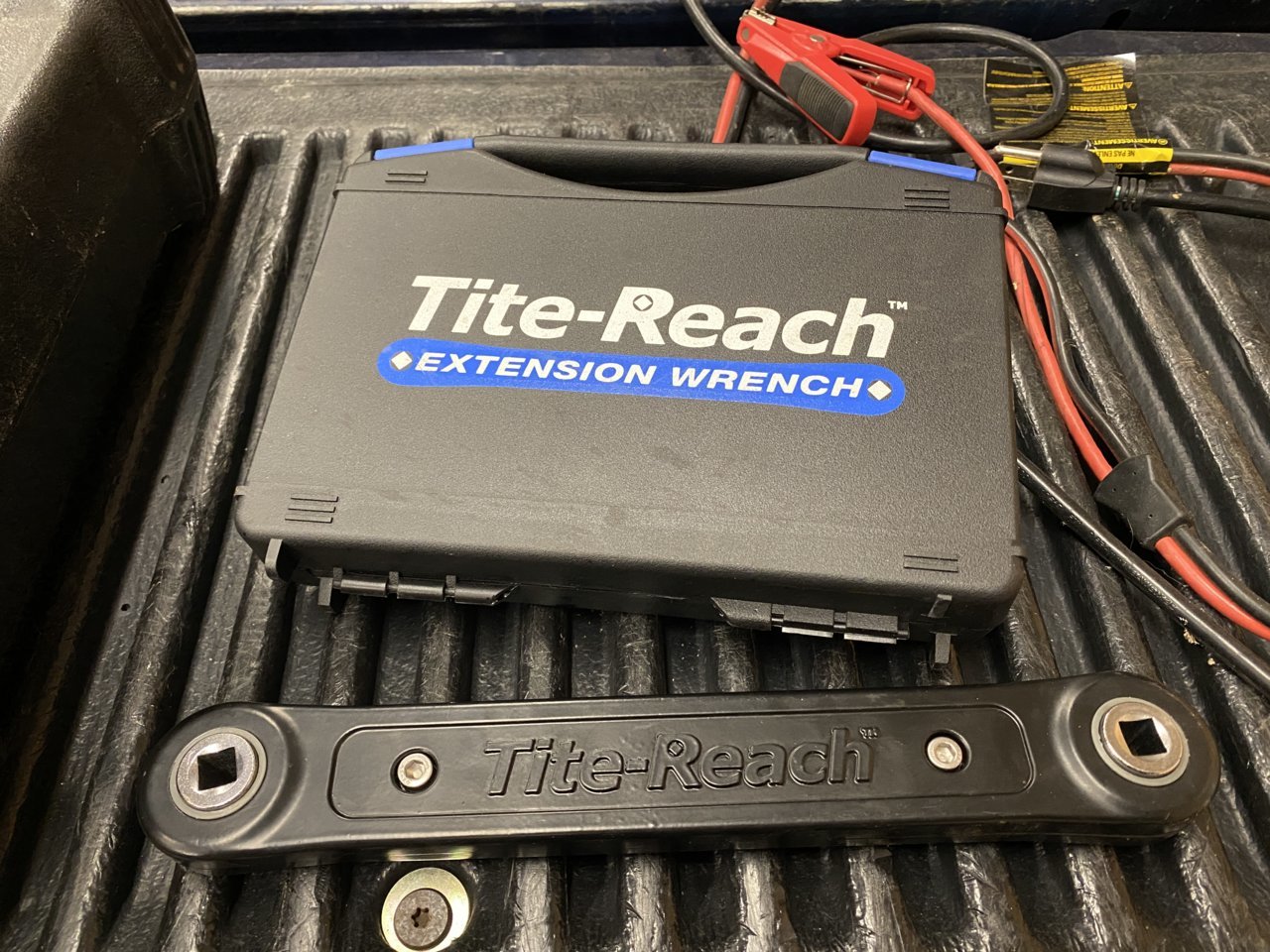

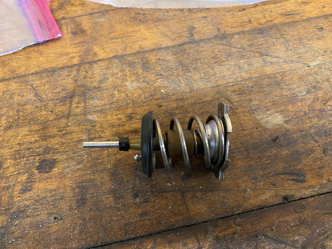

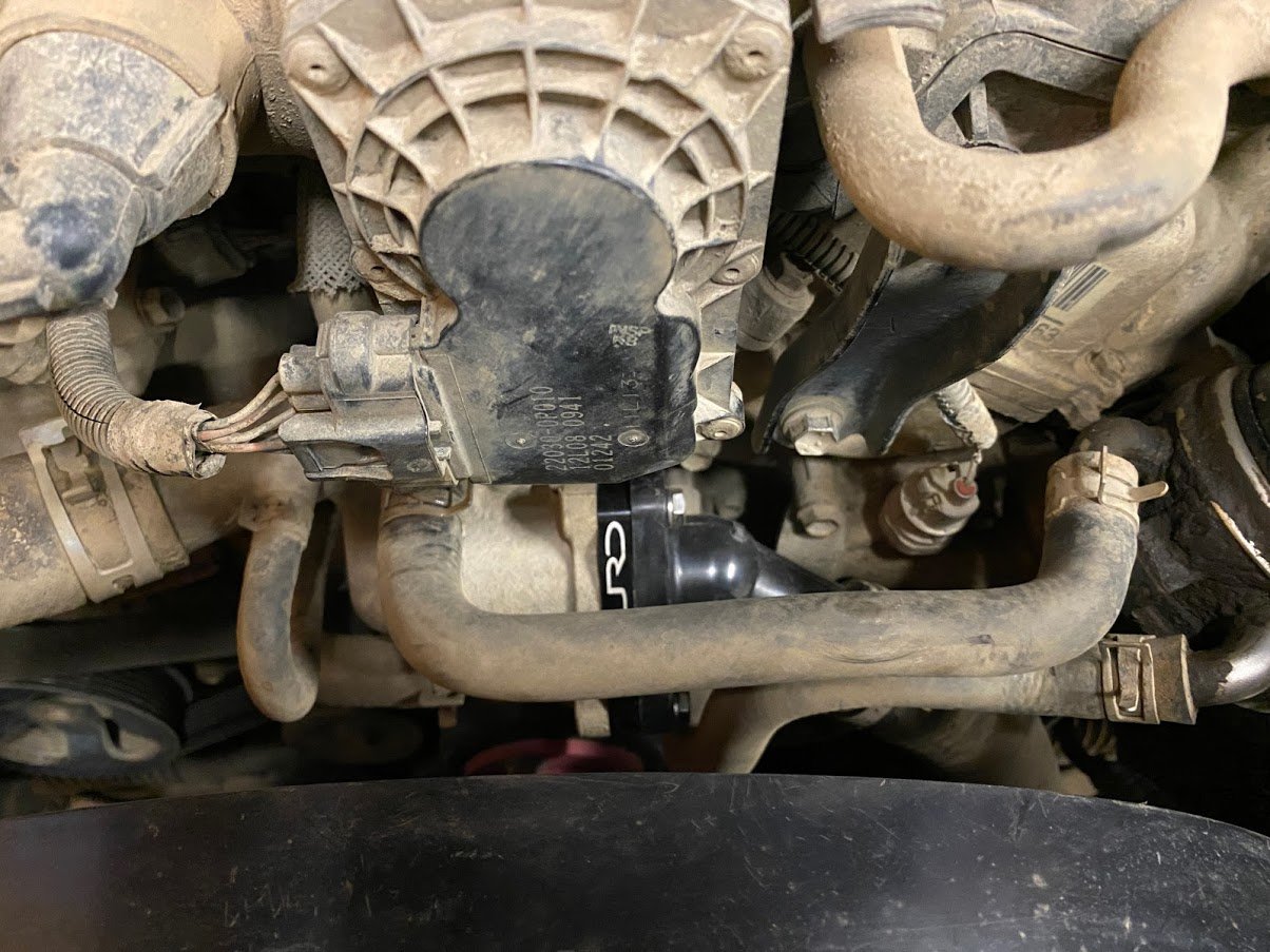

    Drained the coolant from rad and engine block (drivers side engine block petock suck balls to get to), installed a new URD 160 deg thermostat, then added 2 gallons of new toyota pink junk
    This tool was great for removing the studs and installing new thermostat, without it I would have been busting me knuckles for hours.
    Bye old junk thermostat

    What tool is that Ant?

    this fella here

    I have the 1/4”, 3/8”, and 1/2” drive ones. Not sure if there is a professional model or not.
